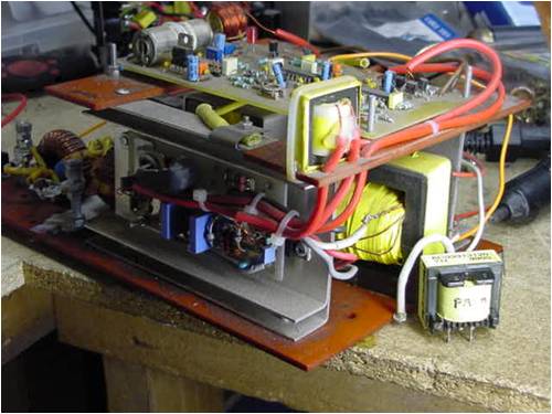

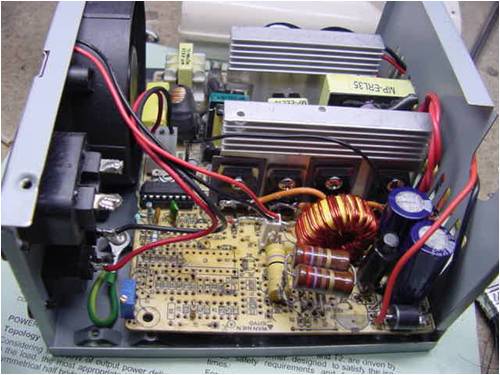

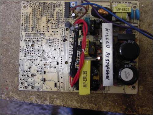

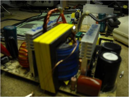

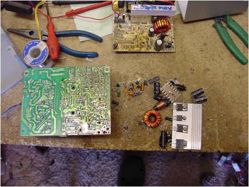

OK Dinges.... I have found the USB cable. My camera has a floppy drive which is great .... but the laptop died and so I fixed up another oldie with puppy linux... but no floppy... hence why the USB cable was near unfindable.. not used for years..... moving right along.
Time to use up some of Glens new bandwidth

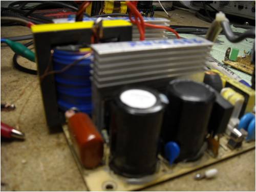

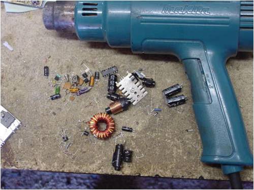

Firstly for the non-believers, here is the fiendish desoldering tool and some freshly released bits:
and here is the solder and stuff that rains out of the board:
and here is the final resultant mess:\

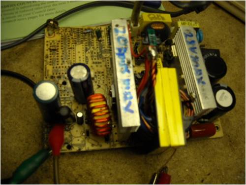

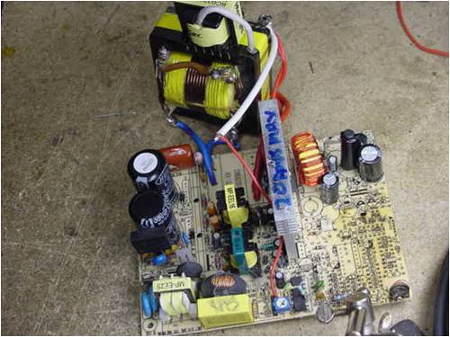

Here is the denuded board, only the HV side is intact and the current sense I have added ( pot over the chip)
and next we have the full wave unit (now 24v@8A max):
And lastly, we have the 900w version... that used the original 6A diode, and 40w switches....he he he...
You may note that the transistor heat sink and population has gone west for the moment... trying to get time to whack in some biggies..... sigh.. time...
And just for something interesting here is a 1kw unit with no electro's in good old fashioned push pull... and a big transformer I wound for it for testing...:
Well I think that keeps all the promises I've made.

[quote]Firstly for the non-believers, here is the fiendish desoldering tool and some freshly released bits [/quote]
I do believe you when you say so, Oztules. No need for pictures to prove it. Obviously you're more skilled in using the heatgun than I am; I always tend to ruin the board when using the heatgun on pertinax (phenolpaper) board.

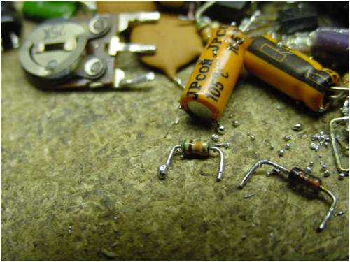

In the 5th picture I see a diode at the bottom right (next to the red wire and one of the two blue electrolytic caps); what is it for?
The 900W version is impressive.... I'll consider that to be a future challenge for me to copy :) . For the moment the full-wave conversion would be plenty enough though to satisfy my needs (rather: wants). Think for my own use, if I'd ever build a 900W version, I'd try to parallel 3 transformers of 300W. Of course inductance would go down (in parallel). Do you think the rest of the electronics would have a problem driving 2 (or 3) identical transformers in parallel? Problems with ringing, driving (using suitably rated transistors, of course), or other issues?
Thanks for the photos and remarks. As always, they're an inspiration. Also your other story of the windturbines on your island.
Peter.
Edit: I think I know now what the diode is for; the reason I asked was because it looked so small, but I only noticed now that that particular PSU is 'only' 8A max, so it looks like the diode could pass all that current. I was thinking of currents of 15A as with your other PSUs and couldn't imagine that relatively small diode passing all that current, so assumed you pulled some kind of clever trick with the diode for one reason or another.Edited by Dinges 2009-05-31

He he he....
that diode is simply a crowbar. It has very very high surge capacity, so if you connect a battery bank up in the wrong polarity, nothing happens to the psu, but the external wiring will spit sparks and alert you to the stupidity. I normally use an inline fuse in series with the output.
This has helped to keep the power supplies together in quite a few circumstances. Especially if you build them for other people to float their batteries on.... one day they mix it up... this stops that from being a disaster.
So, no, the diode does nothing, it just sits there across the output for protection.

Update on the 900w unit.
Replaced the switchers with bigger ones, replaced the diode with 20A200v twin d92.
Ran the unit driving 500w vacuum motor (36vdc) for about 5mins with no cooling. Everything stood up well, but the fins got hot. From Spuds 400w pictures, the heat sinks are mandatory.... and i stopped the test because the heat sinks on these little ones were up to 65C or more. With Spud sized heatsinks and the fan turned on, this thing would power up to much higher power.
This answers the question of the topology as is for higher power.... answer yes. Bigger transformer, bigger switchers, bigger diodes and lots of cooling will do it no problems. Nothing else needs beefing up except the output inductor/filters. (Beware of saturating the torroids with thicker wire and higher currents.)
The input filters seem to do just fine. Bigger caps would help with ripple I suspect, but for batt charging ... who cares.
Fuses.... what fuse

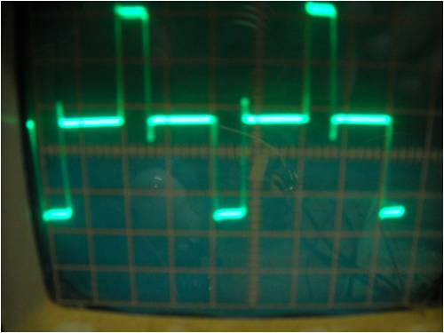

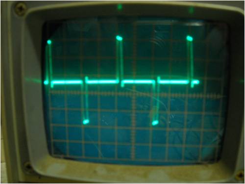

Oztules,
how does the drive waveform look? I've been finding mine are a mess, especially when at low loads. Been a while since I benched one, I wonder if they are reacting with the iso transformers I use...
sPuDd..
It should work ...in theory
oztules
Joined: 26/07/2007
Posts: 1686
Posted: 11:25am 23 Jun 2009

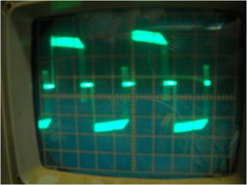

Ok Spud.
I decided to use a turn of wire around the core to achieve isolation and no interference to the drive or driven wave form. This should give a true picture of all the waveforms currently going through the transformer (neat solution yes?)
So here is the first one with about 10w output... I couldn't take a pic at less power, as much less and I could barely see the trace it was so fine... but just as clean none the less:
Next we have it at about 120W (about 10A@12v or so). This was driving a 36v vacuum motor. It can use up some 500w.
(At the 10 watt level, the motor barely turned.... so inductive load with a commutated load very low impedance.,):
At 16A 32v (about 500w)it looks like this: The top/bottom of the wave form is very busy. It is just a blown up version of the lower power traces. If you push the definition up of the low power 10w one, it shows the same thing but at smaller amplitude in that part of the wave form. It may be the commutation causing it too, but I don't have a dead load handy.
Here is a pic of the hand wound "quickie" transformer (a 20 minute job) :The 1.6mm wire is pretty darn heavy, and the twisted centertap is a huge piece of copper.
and again.. note the single turn of thin wire wound around the stack to get the scope pictures with isolation.
And finally a birds eye view to show the under populated board.
Is this what you were after??
........oztules

sPuDd
Joined: 10/07/2007
Posts: 251
Posted: 12:49am 24 Jun 2009
Thanks Oztules,
I'll slip a fine wire around the core and try that. In fact I could do it with any core that I can slip a wire into.

I'm beat.
Changed the TL494.
Put in 330r with 10nF for gain control.
Made sure pin16 is grounded and pin15 to Vref.
But "I can't get no... PWM!!!"
Sure the voltage changes, but I get terrible noise on the output, and the duty remains 100% (and gets real ugly) but seems to perform its task by shutting down and starting up at high speed. I get the same effect on all the mod units. There must be something fundamentally wrong with my mod. But other than not using the second error amp - its verbatim with Oztules diagram.
Are pin 15 & 16 tied up/down the right way? That is to say, is the second error amp causing the system to try to run flat out? Its not making any logical sense to me.
EDIT: Can't be the second amp, its still setup as it was built. 16 grounded, 15 to Vref.
EDIT: Tried with the pot connected to Vref instead of the OP, now I get 40V out or zero. Still seems like it needs DC gain set to me.
EDIT: Changed the 330r to 33K and fitted a 1M resistor between pin 2 & 3 as per most 494 documentation. No help.
There is something fundamentally wrong with the design, or its faulty.
Disheartened sPuDd..
