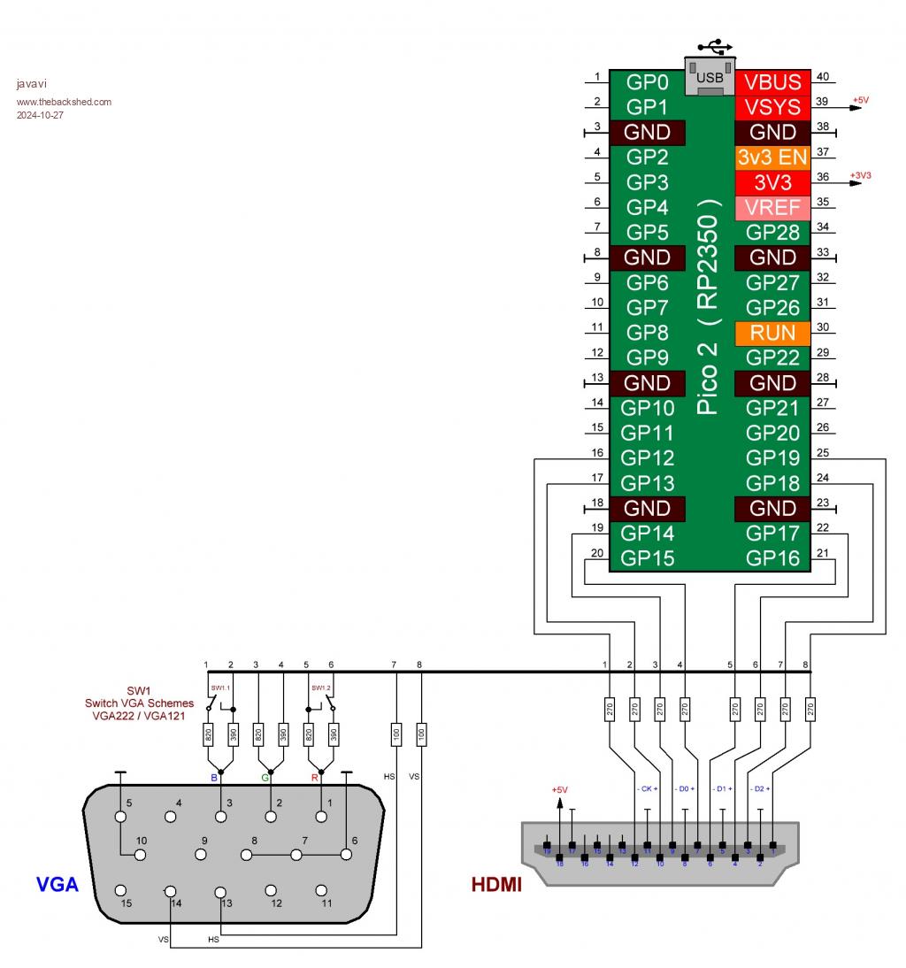

I can offer this version of the universal PicoMite board with two video outputs, HDMI and VGA.
If you make both versions of video outputs on the board, you will get a universal board for both HDMI and VGA video output.
Both video outputs are connected to the same Pico2 ports with their own resistors.
This solution has already been tested in other projects and VGA does not interfere with the operation of HDMI (even if it is connected).
Moreover, there is a method for automatically determining the type of connected monitor at startup by the state of the ports (with VGA connected, they are all in logical "0").
It is also possible to implement two VGA video output circuits, VGA222 (64 colors) and VGA121 (16 colors).
Or you can come up with some kind of palette switching with the remaining two ports.

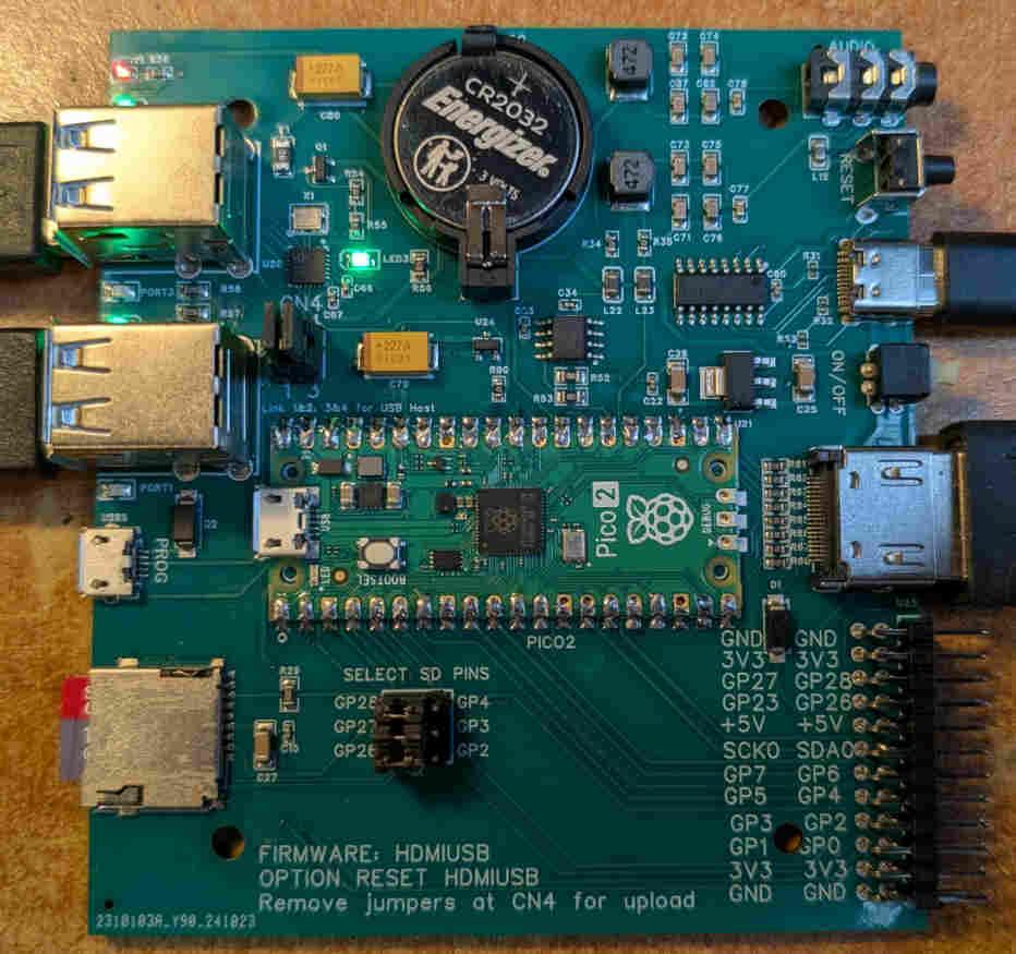

Just got some of the latest boards made by JLC
All the design files are now available on github
This includes a dxf file for matching end-plates for the MULTICOMP MCRM2015S or HAMMOND RM2015S box.
I will have 4 of these boards available for sale in the UK in about three weeks time. Cost to me including shipping and import duty was GBP24 each so add UK postage and that is the cost. You will need to supply and solder a Pico2 to complete.
As before the board includes a 4-port USB hub for connecting keyboard, mouse and gamepads, HDMI output, battery backed real-time clock, CH340 console (if required), SDcard, and PWM audio. Everything you need for a boot-to-Basic computer.

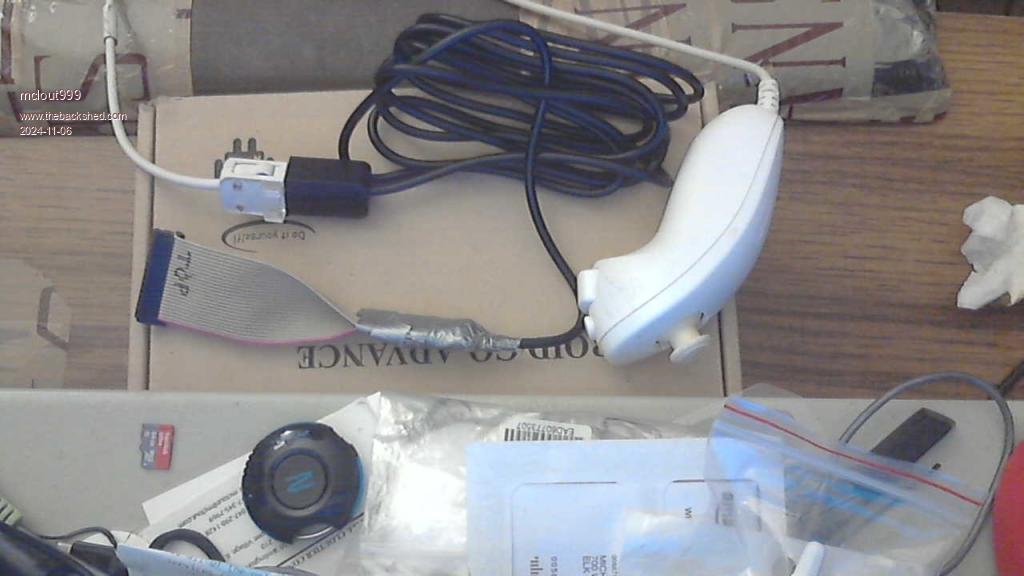

Does anyone have an easy way to test my new WII port adapter?  Thanks.
I used an old FDD cable as I have so many.  Here it is.
I chose to leave most of the extension cable length and I hope that was not a mistake.
If it works I think my next project will be to wire a double pole double throw tagal switch on the jumpers for programming so I don't have to take the case apart to flash it. Regarding the boot button on the PICO 2 I have been thinking of making a tube that sits around the boot switch that comes out of the top of the case (wooden skewer as a actuator), I think I'm going to wear out the screw holes so I have just been taping it shut for now
Edited 2024-11-06 03:34 by mclout999

Hi.  I have been testing my new WII NUNCHUCK cable
I put together a little program to test program (not great but it will show if the nunchuck is being read)
Wii Nunchuck OPEN
START:
Print DEVICE(NUNCHUCK C);
Print DEVICE(NUNCHUCK Z);
Print DEVICE(NUNCHUCK JX);
Print DEVICE(NUNCHUCK JY)
Pause 5
GoTo START
I run this and it works for a few moments and then locks the system up and sometimes it throws a prompt that says "Enter Pin or 0 to restart" I just tried again and it seems to work after I turn it off and unplug the USB C cable for a moment then I get that prompt when I Ctrl C to break it. Not sure what I happening here.  Any Ideas?  Thanks
