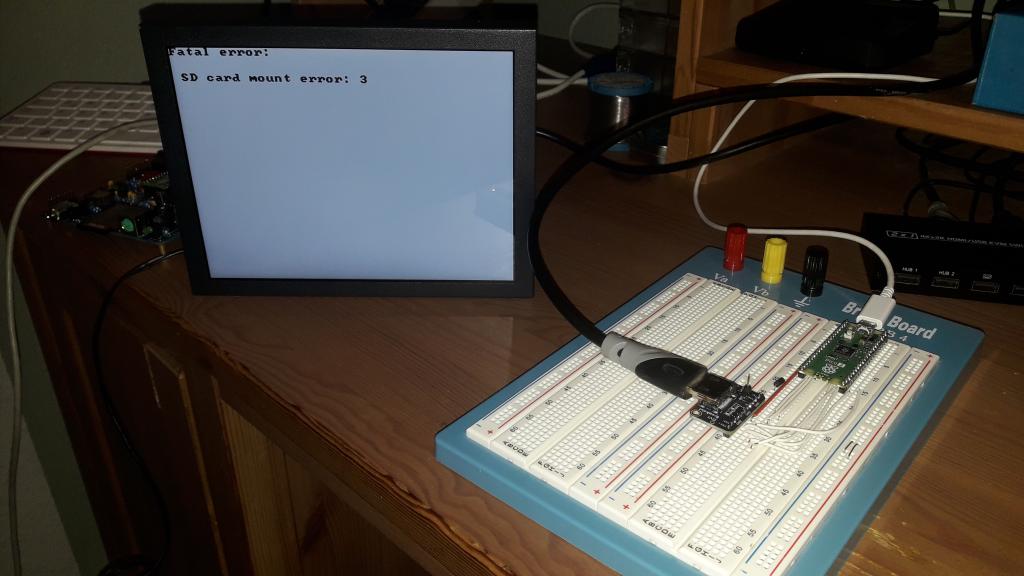

Amnesie
Joined: 30/06/2020
Posts: 763
Posted: 07:06pm 07 Feb 2025
Hello javavi,
HDMI works solid, even if I touch and move the breadboard wiring. But can't test further, no sd socket at hand and no game. If you have another test with audio in which I don't need an sd card what so ever I can try it.
Here is a picture:
Greetings
Daniel

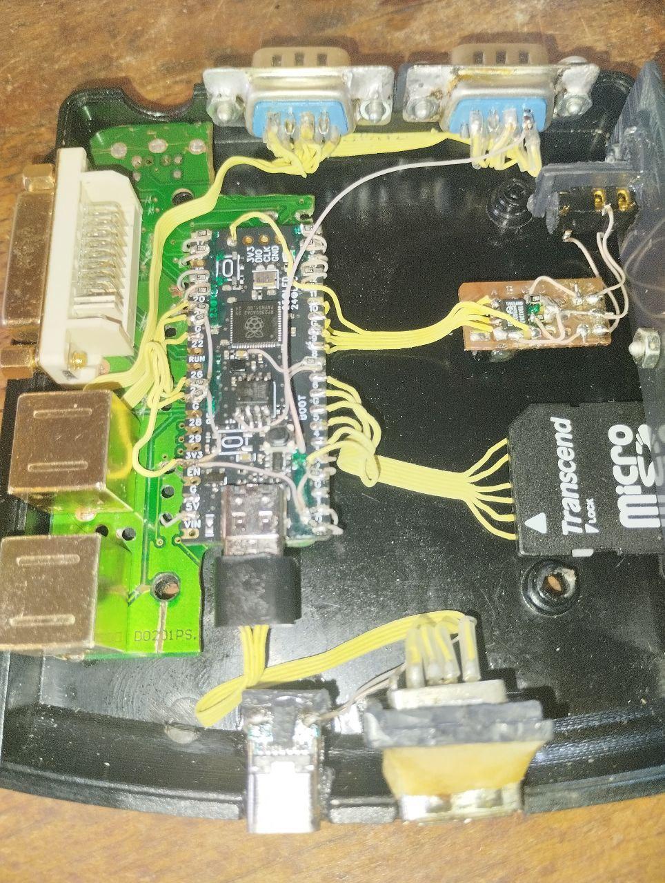

Posts: 2807
Posted: 07:16pm 07 Feb 2025
  Amnesie said  Hello javavi,
Here is a picture:
Greetings
Daniel
glad for you. looks the same dvi breakout board as mine.
as @materp says, it does work just depends on the display.
Edited 2025-02-08 06:12 by stanleyella

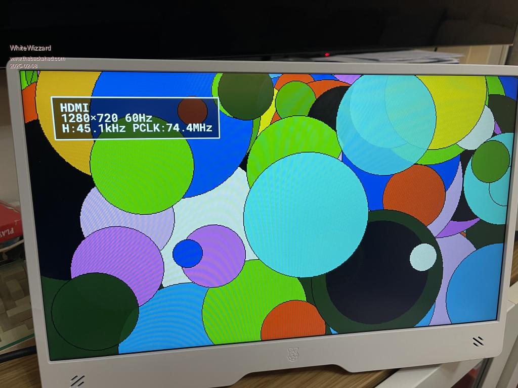

Posts: 2992
Posted: 07:22pm 07 Feb 2025
@Daniel,
With your new monitor, and the Pico set to OPTION RESOLUTION 1280, would you please be able to tell me what frequencies you are seeing in the monitors ‘info’ window.
I am seeing the following BUT this may be dictated by the ‘splitter’ I am passing through.

Posts: 2807
Posted: 09:05pm 07 Feb 2025
  javavi said
er. tidy wiring
Amnesie

Posts: 3411
Posted: 09:21pm 07 Feb 2025
@Stan. When the lid is on it will be as tidy as a bought one!
The recycling and reuse of old equipment rather than dumping it and buying new is to be applauded. A high proportion of my projects are in a similar style.
Edited 2025-02-08 07:24 by phil99

Posts: 2807
Posted: 10:39pm 07 Feb 2025
  phil99 said  @Stan. When the lid is on it will be as tidy as a bought one!
I'm as tight as a ducks bill and recycle everything.
