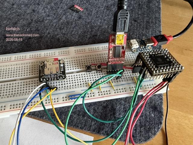

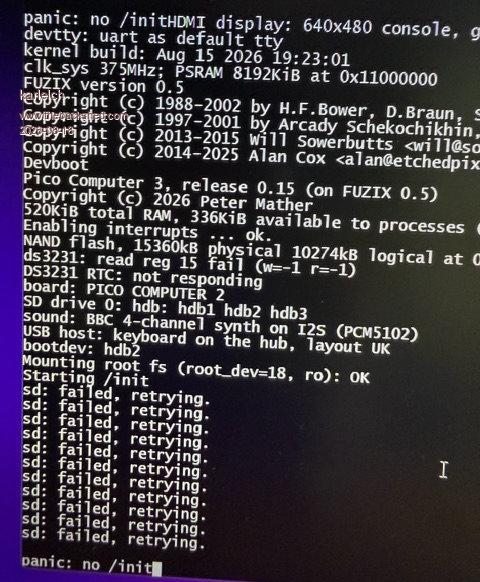

I'm trying to run FUSIX on a minimal hardware, using a PGA2350 (see picture below).
It starts booting but then after mounting the SSD, it fails (see below).
I haven't tried a different SD card (will do) and the wiring may be a bit too hacky, but is there anything else on the software side that I might have missed?
One more thing: Currently the presence of the clock chip is used to determine if it is running on a PC2 or PC3. I don't need the clock (at least now) but I would like to use the "true" SPI connection to the SD card reader as the PC3 is offereing. Would it be possible to add another way to set the pins/mode for the SD card reader? Or check in addition if a so far unused pin is high for this test?

Posts: 12083
Posted: 10:32am 18 Aug 2026
If you don't have a RTC and GP27 isn't wired use the PC2 sdcard wiring. If you connect a RTC and GP27 to the 32K output then the firmware will know it is running on a PC3 and you must use its sdcard wiring. You can uses SPI for the SDcard unless you connect and RTC, This was a mistake of mine on the PC2 but MMBasic, MicroPython and now Fuzix work round it using a bitbanged sdcard driver. I don't think this is particularly any slower.
In both the PC2 and PC3 you really should have a RTC as this is used for timestamping files etc.

  matherp said  If you don't have a RTC and GP27 isn't wired use the PC2 sdcard wiring. If you connect a RTC and GP27 to the 32K output then the firmware will know it is running on a PC3 and you must use its sdcard wiring. You can uses SPI for the SDcard unless you connect and RTC, This was a mistake of mine on the PC2 but MMBasic, MicroPython and now Fuzix work round it using a bitbanged sdcard driver. I don't think this is particularly any slower.
Ok, thanks. Then I'll first try to get it working with the SD card in "PC2 mode" and then add an RTC - I should still have one somewhere.
