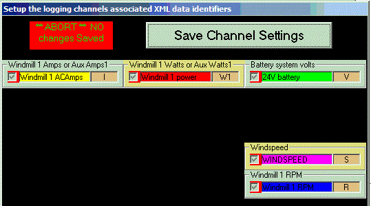

It has been some time now that I have been working on my Windmill Analyzer APP. I still have some modules to tidy up, but I have decided to give some pics of the various screen shots of the modules that I have written that are used by the program.
The program can be divided into many parts,
1/. The splash screen
2/. The main live data display window
3/. the main window menu
The menu system is the key to the programs various modules.
The menu is divided into linked common modules
a/. Configure
b/. Setup
c/. Now
d/. History
e/. Help
f/. Start
g/. Stop
h/. About
i/. Exit
The Configure is not accesssed in the DEMO version.
The Setup has several sub menus including
a.1 Hardware, including COMM port, Baud rate, Logging interval, Individual program naming, Automatic logging on startup, Saving to spreadsheet format as well, windspeed units. The logging interval can be from 1sec-10mins. For under 10sec intervals, hourly files, instead of daily files are created. This keeps the file size manageable, and allows a faster logging to better see recorded windmill transients. The time averages of integrated data is logged for each time interval.
a.2.1 Logger Hardware Channels installed, including individual channel colour identification, maximum values expected for each channel for use in graphing programs, selection of XML coding for non piclog or other personal programming applications, Individual channel naming.
a.3.1 Log data XML code setting. The XML coding of stored data can be different to that from the COMM hardware.

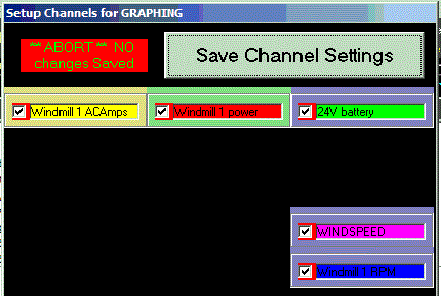

a.4.1 The default channels that are graphed can be selected, so preferred channels can be viewed without needing setting each time the graphing window is opened. This is essential as the number of channels is increased above a few, and allows faster viewing of data records.
a.5.1 The data that is displayed on the main screen can be selected to be viewed or not. This window is kept as small as possible to avoid screen clutter on a computer that is used for other simultanous tasks. The window can be minimized still and provides basic data on the toolbar.
a.6 This is the Channel Calibration screen. The screen is 2 side by side tables, with column identification across the top, and yellow column identification dividers. The mathematical relationship used appears in the table header, and is of the form subtract the zero offset from the raw data, and multiply this by the manual calibration factor to give the display value. The factor can easily be calculated by dividing the known calibration reading by the offset corrected raw data value. The raw data is on the most left column of each table, and then the autozero buttons, and then the manual calibration setting window followed by the display value window. The auto zero buttons and the manual calibration setting factors are located in columns below each heading. The autozero value for each channel appears on the button, I did try and offer auto zero and auto calibration, but this was abandoned in favour of an auto zero and manual calibration. There are 3 type of channels, type 1, typically voltage, type 2, typically current, and type 3, typically pulsed input. The Amp and voltage readings offer auto zero and manual calibration, while the pulse inputs only offer manual calibration, and reset the auto zero offset back to zero. The channel calibration takes the form viz:- correct for a zero offset with autozero button and then adjust the manual calibration until the display value equals the known calibration reading, or use the mathematical method given above to calculate it.
This screen was reasonably difficult to set up as there are potentially 16 channels that need to be individually calibrated, with a mixture of potential calibration requirements. I had to simplify it as I was unable to offer a universal system.
a.7 This is a window that allows the incoming serial data to be viewed. Useful for confirming the XML coding from alternative data sources.

There are many aspects of this section that I am still working on and here are some screen shot pics of what I have described above. I thank those for being patient to date.
This is the DEMO main screen.
This is a main screen shot with 2 windmills, RE system and HOUSE loading logging.
This is the screen for Hardware setup.
This is the screen for channel setup.
This is for setting up personal logging XML identifiers.
This is for setting up initial preferred channels to graph.

Screen Real estate becomes a problem when many data channels are to be concurrently viewed. I have redesigned the data fields to allow a single field to be used to display up to 3 different readings, depending on how the pointer is used. With the pointer say over the graph, then the readings reflect the data for that particular time for each channel. The maximum or minimum for the graphing window is available by clicking on the desired parameter output window. This has allowed me to view up to graph and view 12 individual channels with the same size window. A zoomed in portion of the graph can be viewed, and the maximum and minimums are recalculated, as well as the WH for the time period.
I have tried to allow the user as much cutomizing as possible. Channel names and colours in all setup screens and graphing windows reflect user settings. The main display is fixed, as certain user colours are harder to view. The application will make all the configuration and help files and folders when first run. VB run files are still required and are the same as those needed by piclog. The application allows multiple windows to be opened and moved to suit personal prefernces for placement on the desktop.
This has become a mammoth individual project and I hope to soon have at least the DEMO available.

Here is a pic of a previous 20min live update graph. I flipped to calendar view just prior to screen capture, so this could be seen as well. I normally use scaled graphs, so day to day performance is clearly shown on the graphs. If automatic scaling is used, then day to day performance graphs can look the same. Readers may question what the Voltage is doing. This is the windmill output voltage, and not just the battery voltage. This shows that windmill current is supplied below the battery voltage and indicates operation of the cap doubler.
The latest revision still in development is basically a scaled, gridded, graphing window with a menu structure. My latest NetPC has a small screen, so I am optimizing the window size for it, and buttons take up screen real estate. Hopefully the touch screen laptop will have higher screen resolution than my NetPC.
I have to admit that viewing a live updated graphical representation is really cool. The simplest analogy would be the difference between a CRO and a multimeter.
