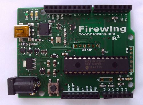

Firewing R2 board is another great option, as is designed from the ground up for PIC24H/PIC32MX 28pin dip case.
http://firewing.info

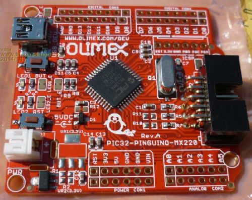

Serge Vakulenko said that the pic32prog now supports the MX1/MX2 variants, but I guess something is not working, as I bricked mine, I guess ... As I said, the pic32prog continues to detect the micro, it programs it, verifies it, everything is ok, but the burned firmware is not working (the initial firmware is not there anymore, and the new one doesn't show up).
Edited by vasi 2014-01-18

Posts: 4396
Posted: 04:52am 17 Jan 2014
You have no ICSP pins so how did you program it?
vasi
Joined: 23/03/2007
Location: Romania
Posts: 1697
Posted: 04:59am 17 Jan 2014
This is an old picture, just after "unboxing". I have sockets soldered in place.
Elvish name: Mablung Miriel
Beyound Arduino Lang
Posts: 4396
Posted: 06:37am 17 Jan 2014
Oh, OK.
Can you program a different file? Maybe Pinguino project's bootloader?
vasi
Joined: 23/03/2007
Location: Romania
Posts: 1697
Posted: 06:55am 17 Jan 2014
Nothing works, not even a "blink". But I guess is pic32prog's fault. So for now, the only solution for MX1/MX2 is a Pickit3 programmer. Though, I will try a pic32prog update...Edited by vasi 2014-01-18
Posts: 4396
Posted: 10:19am 17 Jan 2014
It would be useful to know if a PICkit3 works. It would seem if it does to mean that pic32prog would need a fix.
vasi
Joined: 23/03/2007
Location: Romania
Posts: 1697
Posted: 10:23am 17 Jan 2014
Well, apologies to Serge, the last version of pic32prog works excellent!
John (@Jman), indeed, the switching clock config. bit is interpreted and reported wrong, but I assure you that the configuration bits are written correctly - compare the hexadecimal values of DEVCFG0,1,2,3 with the ones from your hex (but I don't know how).
Now I'm gladly blinking both LEDs of my board - I've downloaded mikroPascal for PIC32 to rapidly cook a test program. Good, this proves that pic32prog works at least with my pic (PIC32MX220F032D). Case closed.
