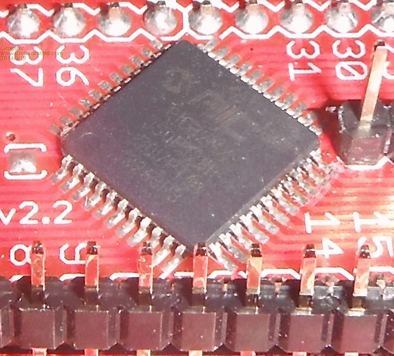

I have to chime in here - I probably would not with general purpose purchases, but these boards really are well done, as jman says. I too got a fully-assembled one, and a blank PCB, but I doubt I can do justice to the blank one, based on the assembled one, and Gandalf(sorry, WhiteWizard) tells me in a PM that he did actually hand-assemble these boards, which is HARD TO BELIEVE, as they are so good, you'd think they were factory assembled.
Check this out:
This is WhiteWizard's HAND SOLDERING - Hell's Bollocks...

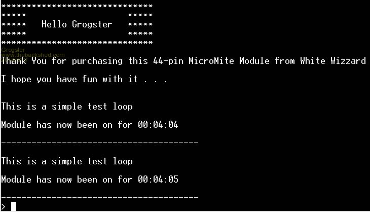

Got a chance to actually fire up the board tonight(my time), and a nice little message popped up:
Awwwwww, shucks...
I guess he does that for everyone who buys from him - jman hinted as much with his one.
I really like the LED's on the USB-serial chip showing traffic - I'm all for blinking lights - makes a project more visually interesting.
I can confirm at this point, that the driver for the USB chip on WW's board was auto-downloaded and installed no problems at all in Win8 64-bit. There were issues getting the SC USB driver to work in Win8 for the full-size MM, but there was a work-around.
Happily though, this board is truly plug-and-play.
In one board, I have been able to do away with a rats nest of jumper wires and external TTL-RS232 converters and PSU's!!!
Now, for some tinkering.........

is the board hand soldered ?
if so show us some tricks ;)
Posts: 2998
Posted: 11:20pm 15 Mar 2014
  plasma said   @ whitewizzard
Yes, these MicroMite PCBs are all hand soldered; each one taking around two hours to build AND fully test.
I would love to get a video made regarding how I solder the SMDs/Modules. However, at the moment I am going to be focused on Beta Testing for Geoff. The reason for this decision is that he is running close to his deadline to release the software for the magazine launch.
I can however send bullet points as to how I solder the SMDs if that helps!

Interesting that the designation of the chips on the board is unreadable - I guess that's to slow down the cloners?
