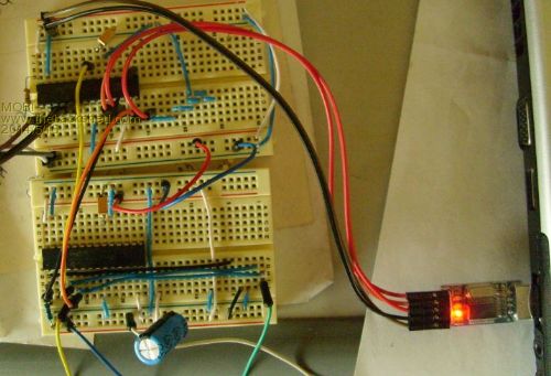

Hi, methinks there is more to programming a pic32 than MCHP let on - unless there is something I'm continually overlooking.
Is there any one game enough to also tackle the MicroChip documentation?
I've wired up two pic32 chips - the top one as a micromite and the other as the target chip to be programmed.
For anyone game enough, the connections are simple enough and are listed at the beginning of the code.
I would like to be able to get this working (if it is indeed possible) just using the MicroChip documentation - which is a challenge in itself.
The code so far should determine the status of the target chip, i.e it is ready to accept programming commands.
The pdf of the pic32 programming instructions is on the previous post to google and download.

Mobi and WhiteWizzard,
It is so convoluted to communicate with the chip.
I have looked briefly at Mobi’s code but must wrestle further with the documentation.
If the chip to be programmed contains an MMBasic Autorun program that will for instance continually flash a LED, then when after the sequence to enter ICSP Mode and Mclr goes high, if this has failed then the LED flash program will run. Otherwise you have likely succeeded in entering ICSP Mode?
Perhaps to test just this Moby’s program should halt at this point with Mclr high?
This test will hopefully show that at least the chip is in ICSP Mode as a very first step, but for me not until tomorrow. Perhaps others have already performed this test.
That the serial data should require most sig bit first to enter the Mode and then least sig bit first for commands and with different clock edges hints at the gymnastics required in the protocol. I have still to fully grasp the interleaving of 4 wires to 2 wire data that seems required. I think that we should conform somehow to Figure 6-6 page 15 of DS6001145M. Is this correct?

I'm not sure I'm reading you right but here goes.
The two wire system as used by say PICKit3 only has a bidirectional PGD (programme data) and out only PGC (clock).
In the 4 phase two wire system there are three bits of data namely TDI (data in to the target), TMS ( mode select) and TDO (data out). They are always clocked in the same sequence. The TDI bit is placed on the PGD pin and the clock toggled hi/lo. Then the TMS bit is placed on the PGD pin and clocked in, then a third clock and lastly, the TDO is read out on the PGD pin. That is 4 clock pulses. The sequence is always the same. The TDO is clocked to the PGD pin on the high going clock edge, read by the programmer then the clock is returned to 0.
At the fourth clock pulse, the programmer must change its PGD pin to an input.
All 2 wire 4 phase functions use the same pattern. To clock in an 8 bit byte would take 32 clock pulses plus any extra for TMS header and footer..
I have stopped the programme at all sorts of places and all seems to be working up to checking the chip status which returns zero. I like the idea of using a pre programmed chip and stopping at mclr hi. I haven't tried that.
I tried the blinky led suggestion and it wasn't going into programme mode, so I started (again) to look further. I have said it a million times in the past (ok so I exaggerate) if the software looks like it should work, it usually does and go (out of desperation) to look for hardware faults. I have checked this b.... thing until I am crosseyed and could find nothing wrong. The PGD jumper is orange and the PGCK jumper is yellow and it looks all along that I have had them reversed. (how embarrassing).
Anyway, now the led stops blinking and I get a status byte that conforms with what I think it should be. Fingers crossed as I try the next step. WW I'll catch up with you yet. Thanks Keith for the hint.
Edited by MOBI 2014-05-18

Hi Wiz,
I have got to the stage of seeing a status byte but it doesn't match the data sheet.
The process goes through to the end of "erase chip" (where I've terminated it).
It goes into programming mode (my pre programmed blinking led goes out), goes through the erase steps but as soon as I release mclr, the led blinks again which would suggest that erase has failed.
I even put in a loop and repeat status read as per data sheet to no avail.
Can you remember what length your 'sendcommand' words were? 5 or 6?. The data sheet implies that the length could be 5 or 6 depending on how you interpret the timing charts. In 8 bit pic days, programmer commands were 6 bits.
Might have to get my self a logic analyser - there is only so much one can do with a dual trace cro especially with 'one shot' bit patterns.

The length of the payload command as sent by the SendCommand pseudo op is always 5 bits. You do not need to parameterize this. It is always 5 bits.
Edit: Plus header and footer as you have.

Thanks, I did suspect as much. The difference between 'send command' and 'xfer data' could lead one to think otherwise.
I have changed my code a bit to be definitely '5 bits' rather than variable.
It does look a little confusing in the 2 wire format that 5 bits are clocked in one block and then the MSB is clocked in the next block. That would suggest 6 bits??
It does puzzle me that even though the device seems to go into programme mode (led stops blinking) and subsequent commands and transfer data for 'erase device' seem to work and produce a status byte, I can't get it to produce the desired status bits.

No, The last command bit (bit-5) is sent with TMS = 1. While it is shown as a different block in the prog specs it really is just the 5th bit. The difference and point of confusion is that TMS is raised for the 5th bit. Then the 2-bit footer is sent.
Have you had experience with what I am trying?
Your FOR ... LOOP in SendCommand needs to be set for 4 iterations (TMS= 0.) You then do the 5th bit with TMS = 1. (This accounts for the middle two blocks shown in the specs, figure 6-4)
You appear to me to be on the right track with what you have.

I think that I have discovered a slight anomaly in your description earlier regarding clocking TDO into the programmer.
You stated: -
“….. The sequence is always the same. The TDO is clocked to the PGD pin on the high going clock edge, read by the programmer then the clock is returned to 0”.
However referencing the timing diagram in Figure 6-6 XferData 2-Wire (4-Phase)
The diagram indicates that the TDO data is placed on the chips PGED pin at about the falling edge of the 3rd clock in the in the 4 clock sequence, to be read by the programmer at about the rising edge of the 4th clock. PGED should be a programmer input not an output before the 3rd clock falls.
At the speed that your programmer can operate you are probably not anywhere near to the timing limits anyway, and the set up time is sufficient. Perhaps your reading/transmitting of the data is correct with respect to the clock edges but as you are not obtaining the expected result you might investigate?
I am still reading, including Kaikkonen’s program that uses Jtag as it is the only published source that I can find that works. Checking it against the process described in the DS60001145M document looking for variance. And I am learning.
JTR0701 has indicated we must look at the fine print carefully in the diagrams.

I questioned timing but you are busy and I could not stop thinking. Shown here is my interpretation of the 4 clock sequence by editing your "clock" subroutine. I have noted when TDI, TMS and TDO data is shown active, and the position of the clock edge arrows that I have taken as indicating the latching edges. I assume that due to execution speed the clock high or low times and setup times exceed 40 ns minimum as specified and no additional delay is required.
My major changes are to make the Programmers PGED pin an input other than between after the rising edge of the first clock and before the rising edge of the third clock, endeavoring to not have the subject chips output fighting the Programmer output. Perhaps pin(pgd) should be an input unless required otherwise.
I am interested in what you think about this timing; hopefully I can soon try it.
'create 4 phase clock and read data out on pgd line
clock:
Pin(clk)=1 'first clock
SetPin pgd,dout 'Programmer PGED output on
Pin(pgd)=tdi
Pin(clk)=0 'latch tdi into chip
Pin(clk)=1 'second clock
Pin(pgd)=tms
Pin(clk)=0 'latch tms into chip
SetPin pgd,din 'as chip tdo active soon
Pin(clk)=1 'third clock
Pin(clk)=0 'enable chips TDO
tdo=Pin(pgd) 'as data was ready after fall of clock 3
Pin(clk)=1 'fourth clock
Pin(clk)=0
Return

Indeed as Keith has identified there is output contention with the Mobi timing for the period the "master" takes to lower the clock and reconfigure the I/O. Given that this is done in an interpreted basic framework, this contention could be several ten's of microseconds - not good.
I recommend Keith's method as being correct.
I also note that the Pickit firmware (and my own) leaves the PGD line as an input between the primitive four phase bit operations, again as Keith suggested.
Keith W.

Hi all, I think this might be my last night with WWW for a few days but then, we do get some mobile net anomalies in the outback.
@keith, the 4 phase clock sequence certainly looks workable. I am not convinced that the data is available on the PGD line at the third clock even though the charts seem to indicate. It is after all just a drawing and MCHP are notoriously inaccurate in their representations. (unless you have already confirmed with a logic analyser). I will give it a go though. Why I am concerned is that MCHP have gone to the trouble of including arrows on their clocks and as all timing is done by the programmer, I would think that they would certainly indicate the edge at which the data in or out is latched. That has certainly been the case in the past with PICF88 based programmers I have made for 8 bit pics and avrs.
I don't think any timing using the micromite would be too quick for the PIC32 it being an interpreted language, but worth experimenting with.
I think that leaving PGD as an input until required otherwise could be a good idea to avoid having pin polarity clashes - not really sure it can though.
I'll plug in my dongle and have a bit of a play with the code, bearing in mind the suggestions made. Don't go getting too far ahead of me whilst I'm AWOL. (just kidding, its a free world)
I tried the modified the 4 phase clock routine to that suggested but with the same results as previous. - back to the drawing board. Running out of hair.
Edited by MOBI 2014-05-21
