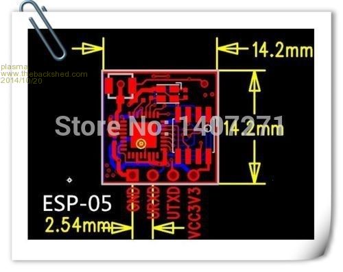

plasma
Joined: 08/04/2012
Posts: 437
Posted: 03:40am 20 Oct 2014
why not send the buffer to a server with a php json parser and get the parsing back ?
i mean we have wifi on and php will solve this with easy.
i know a mmbasic solution is fine but the stringlength is to short even if you use an array.
i trying to read some http headers but here you have /n so its not hard to decrypt.
plasma
Joined: 08/04/2012
Posts: 437
Posted: 07:26am 20 Oct 2014
here is the pinout for the version esp8266-05 .
beware you cant update this version because lack of gpio
Edited by plasma 2014-10-21
