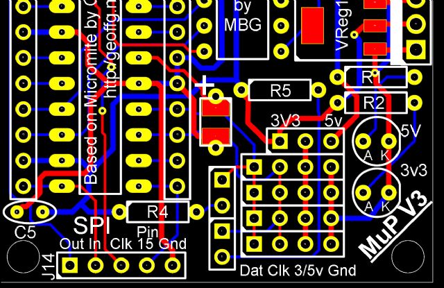

Hi Lizby (Lance??),
I am so sorry to hear that, I will send a couple of replacements to you and a couple of MuP-Proto by means of an apology.
Unfortunately these things sometimes happen, especially with the cut price Chinese manufacturers.. I will check all of my MuP3 boards for this fault
Can you please confirm that your address is the same and I will have them off to you this weekend.
I have attached some screen captures.. If you can pinpoint where you think the fault may have been i can put a closer eye to that area. One is with ALL tracks visible the other has the Vcc highlighted to show where the Vcc line goes in that area.

bigmic--no apology needed, and no need to send any other boards. All is working now.
The top two pins in the DAT column were not linked, and the top one was not linked to the jumper pad to the left and slightly below it (the jumper that links R4 to DAT).
If there are no other reports of this, it is possible it is an anomoly, and it's also possible that I did something with imperfect soldering skills.

Hi Lizby,
No worries, the ones I checked here are all OK, it must have been a fault in the exposure process.

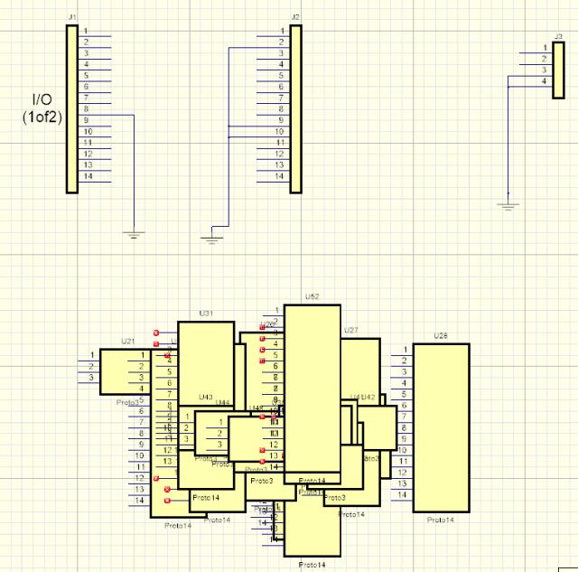

Hi Mick,
Bottom page 8 in this thread ->
https://www.thebackshed.com/forum/forum_posts.asp?TID=6992&KW=Shenzhen2u&PN=1&TPN=8
Here you have the "MuP-Proto" a board full of pads, how did you place these pads, been trying to place lots of pads, real pain unless doing a 'part' even the copy/paste blocks of pads is erratic on my machine.
The "MuP-Proto" link is dead [404] by the way,guess some webpage change.

Hi Plover,
I dont want to have an extended discussion in this forum as it is my COMMERCIAL advertisment thread and I prefer to keep it that way. If you have other related questions please move them to the PCB manufacture forum of TBS.
Thanks for the link info.. Don has changed some things.. I reckon it must be due to those changes.. I will get them looked at as soon as I can.
But simply..
I cheated..
I used SIL headers for the pads and simply laid `LINES' down instead on tracks.
See my `so called' Schematic. I just bunched them all onto the sheet.. I didnt need a schematic for what I was doing.

Thanks, now I understand. I have not missed something in DEX. Will try to remember about the thread.

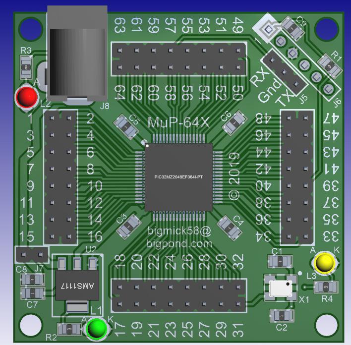

MuP64X
A 50mm x 50mm board that was designed to make developing a bit easier, I didn't like the commercial adapter boards and decided to do my OWN.
MuP64X is fairly minimal but has an onboard 3v3 power supply and is intended to be fed via a 5Vdc plugpack (centre Positive).  I have NOT built one of these up yet but I am fairly certain it will work OK..The reason I redid this board was simply the numbering on the pinout for the IO headers (I changed some to reflect their purpose ie 3v3, Gnd and Mclr etc). The XTAL oscillator is a very small 3225 size and requires a bit of skill to solder it properly.
I will be offering these pre release boards for $1ea plus postage plus Paypal fees.

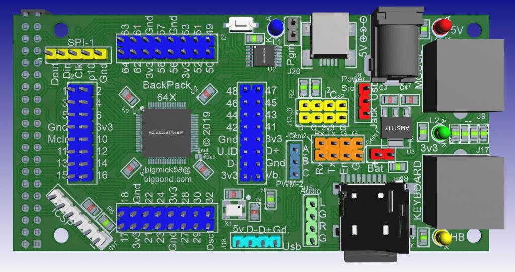

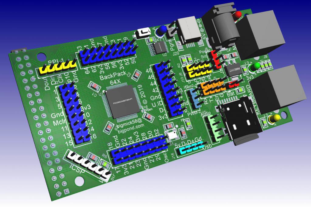

BackPack-64X
A 100mm x 50mm, more or less fully optioned board, that I have successfully built up and been able to test most features.
It has besides EVERY IO pin accessible in its own right, a connection to a SSD1963 TFT touch screen, (i have mine on a 7" one.) a DS2321M (or DS2323M) High accuracy RTC, support for a winbond 8 pin SOP8 RAM chip (not tested as my chips have not yet arrived). PS2 keyboard and PS2 mouse, microSD card and onboard microbridge chip.
Here it is connected to my 7" TFT (please excuse the crude 6850 battery for the RTC as it was easier to connect at the time.. of course a CR2032 would work just fine.
I will be offering these for $2ea plus postage and a bit for paypal fees.
The issues I found with this version are as follows:
Reset switch
Pads are about 1mm too close but i had switches that fit. I lengthened the pads to suit a wider range of switches.
uSD socket...
The holes for the plastic location `tits' are slightly out of position, I rectified this.. The pads are are fine so just cut the plastic location tits off first.

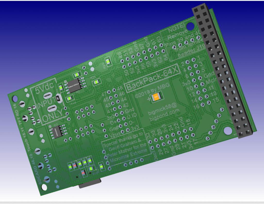

Text (top side)
Text for odd pins 17-29 is misaligned by 1/2 hole (0.05")
Text (Bottom side)
The config text for SD card states 46,10  it should state 46,30
There is a text box with BackPack-64X that overlaps some of the other bottom text looks like a formatting issue.
Vbus
I sent Vbus to some shorting pads to 3v3, it should have gone to 5V
micro-USB
Pin 4 of micro-USB socket has a track shoting it to Gnd... doesnt affect anything but it wasnt intended to be there, you can leave it as is.
DC Power Jack
The Pads for the DC power Jack are actually created as elongated Octagons (bug in DEX) instead of rounded rectangles, as a consequence the copper pour is closer to the pads than i intended.. the ones i tested are still OK but you should chech yours before assembly. I fixed this in the new batch.

Hi Bigmik,
Am I correct asuming the MuP64x board has no gnd pins and 3.3v pins in the io headers?
Posts: 2983
Posted: 03:45am 10 Nov 2019
Hi Volhout,
No! That is NOT correct...
The reason I am offering these pre-release MuP64X is that the SILKSCREEN just shows the MZ PIN number..
I have decided to redo This PCB with pin numbering as you can see in the BackPack-64X PCB.
As I am doing a re-run on the BackPack-64X I decided that I may as well redo the MuP-64X.
As I have my Right arm in a sling (Due to a major shoulder operation) and it is also strapped across my chest I have not done the manuals yet.. I will do them but typing left-handed (when I am a righty) with one finger is tiresome...
There is nothing (that I can see) that is electrically wrong with MuP64X its just the silk screen.. The pins around the MZ chip are exact representations of the MZ pins themselves..
I hope that answers your questions...

Today I am releasing the `official' BackPack-64X Version 1.2 PCB
I wont bombard with pictures as there is not much physically changed from the `pre-release' versions pictured in the thread above.
BackPack64-X is a 64pin MicrMite EXTREME product that can connect to the back of a 40pin Parallel interface SSD1963 based TFT with Touch screen display panel. Of course it does NOT need to plug into a panel it can run stand alone and those IO pins can be then used for other functions.
Features List for BackPack-64X:
PIC32MZ2048EFH064-250I/PT 252MHz Processor (also compatible with the PIC32MZ2048EFH064I/PT 200MHz chip)
Plugs directly to an SSD1963 based TFT with touch screen support
PS2 keyboard support
PS2 mouse support
USB keyboard support
MicroSD support
On-board micro-bridge PIC16F1454/5 for USB programming and flash updating of the MZ chip.
On-board DS3231/2 high accuracy RTC chip
On-board Winbond W25Qxxxx serial flash memory support
Convenient headers for SPI-1, Comm 1&2, Dual I2C connectors (in parallel), PWM-2 and indeed every CPU pin.
Powered by a 5Vdc 2.1mm barrel jack (preferred option) or via USB with mind to current limitations.
The Full manual and associated files for BackPack-64X can be found >>>>>  HERE  <<<<<
Version 1.2 changes from previous versions include.
Swapped the Winbond memory chip over to SPI-1 (was on SPI-2)
Added location holes to the mini-USB connector ‘J20’
Added link options to allow flashing of both PIC chips via the ICSP header
Added solder pads to allow access to the RTC chip pins 1 and 3 if needed
Increased the pads for the mini switch to cater for even more switch sizes.
Made Pin 1 of all IC’s more prominent on the silk screen overlays.
As seems to be the bane of my life these days, I fix one thing and break another. I accidentally deleted a 3mm (1/8") track from Pin 1 of the ICSP header but thankfully it is a super easy fix. Full explanation is in the manual. When I do a Version 1.3 I will of course fix this silly oversight.

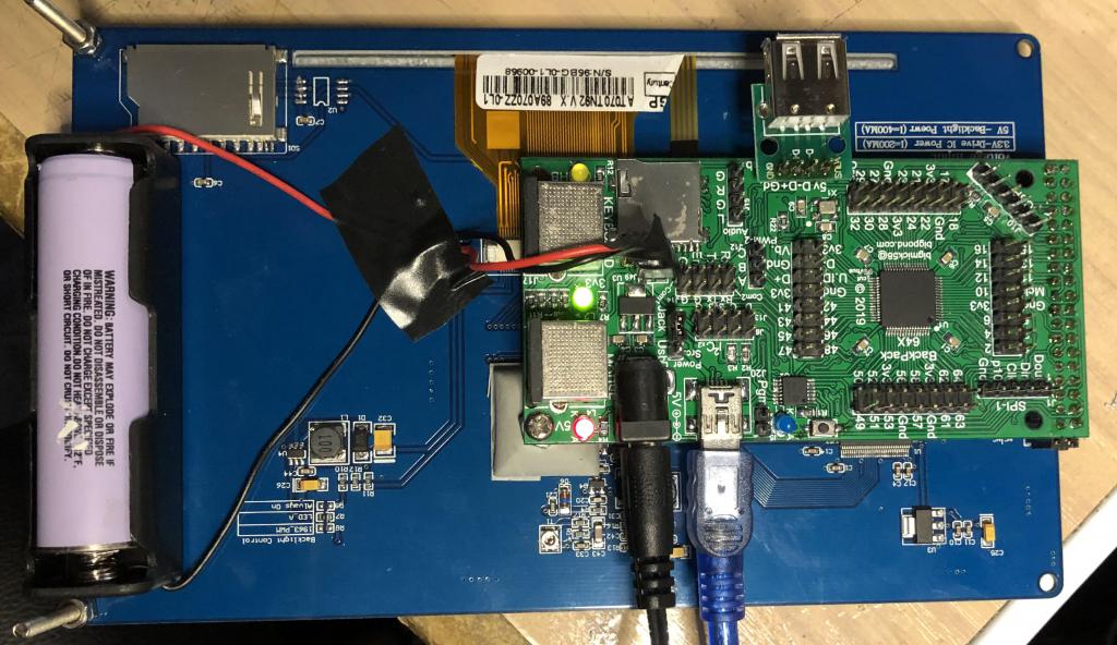

Hi Mike,
Got the white board Backpack 64X build up. A little set back when the trace between the 1454 and the led was damaged. Thought for a while that the chip wasnt progged. But now all works.
I most likely will remove the program jumper. Accidentally touching it is anoying will set the 1454 in program mode. Or I will add a 1k pullup.. noticed the 1454 doesn t have a bypass cap. It relies on the other caps on the board.
Thanks for the boards. Will start looking for an lcd now. Where do you order them? There seem to be various models, not all compatible.
Volhout.
