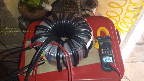

Hi all,
well Ive been kinda busy, but finally got a chance to wind on the primary on the weekend. At first I was going to wind with 50mm as OZ suggested but that meant that I would have go out and purchase some more cable..... and since I nearly have half a roll here of 35mm at home I pondererd on the idea of winding 35 and 10mm side by side. Now I know thats not 50 mm but it probably is close enough for the job. In theory it should work but I thought id run it by you guys and see what you think. Is it unbalanced? I powered up the secondary with 240 thru a 60w globe and checked the voltage at the primary end. 15.25v Is this the right voltage we are looking for?
Also been checking ebay for the main board and controller but can never seem to get the two at the same time ...one or the other is out of stock ( 8000w 24/220) and Id rather have them both delivered at the same time. At this rate it will be way after christmas before I recieve them. Just waiting on a reply msg from PJ.
Marcus

cross section area
35mm2+35mm2=2450=49.4mm2
50mm2=2500
35mm2+10mm2=1325=36.4mm2
so 2 in hand 35mm2 is a good option
I am sure someone will correct me if I am wrong
the traditional calculation would be 24v/1.41 = 17 volts
the actual inverter calculation allows for voltage sag and the PWM closed loop current control.
so 250v @ 16 to 1 turn ratio = 15.625 volts
I guess inputting 240v on the secondary would give 15 volts on the primary so you are pretty close to the mark!

I agree with Yahoo2.
For 24v, even 3kw (which mine runs or 2-3 hrs a day at time in the mornings, is 120 amps or more, for me it is ony 60 amps, so not a big deal for 35mmsq.. @48 v )
As you have plenty of 35mm wire, 2 in hand is the go... only 3-4 meters per winding too.... so not a nightmare to do.
Your boards will run 3kw-4kw indefinately, so you want the tranny to run happy too, and you want as small a sag as possible when running hard, or your fets work harder than they need.
...........oztulesEdited by oztules 2015-12-07

Thanks guys,
In not sure if I can fit in 2 in hand of 35mm2 neatly. I tried just a single run of 35mm and I was about 3/4 away around the inner hole, so thats why I added the 10mm2 which fits ok with a bit of space left over. I also have some 16mm2 as well, so I could remove the 10mm and replace it with the 16mm, ending up with a neat wind and no overlapping.
Seems like my calcs were wrong. I always assumed that in my case 35mm2 and 10mm2 would add up to 45mm2, or 35mm2 and 35mm2 would equal 70mm2 . Think I need to go back to school!! Could there be a problem by having 2 different sized cables?.....OR...... am I better to have a 2 in hand 35mm that dosent look so preety, but works?
I probably should of mentioned the voltage input yesterday, so I did some rechecking. Mains voltage thru a 60w lamp to the secondary is 235v and the output on the primary 15.56v. Is that close to the money?
Thanks Marcus

Posted: 05:57pm 06 Dec 2015
Marcus, I also find that 2 in hand 35mms2 is in fact 70mmsq...cross section.
Given that 35mmsq will handle 140 amps ok, twice would give you some room, as your peaks will exceed 200amps on may occasions I suspect.
2 in hand will get you some clear space of 300 amps and more short term.
It does not need to be neat... nice but not necessary, the wire needs to go through the hole... and thats it.
Perhaps wind one layer then the other, length will be different, but it is only turns of wire going in the hole that counts. There will be a slight phase change with the two different length wires, but it is academic, not practical in nature over this length ( different in single phase inducton motors though)... this should be fairly neat I think.
Voltage is close enough.
..............oztules

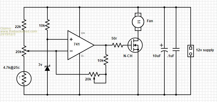

Posted: 12:39am 13 Dec 2015
  Gizmo said   Drew this up. Its really just Oz's circuit with some component changes. Next time I have the inverter off ( unlikely to happen soon, been running for weeks now without missing a beat ), I'll measure the values of the pots to give a starting point.
The mosfet can be any power N channel fet, I usually source mine from retired computer UPS's.
Edit: I may revise the component values later, I did remember one of the pots was pretty close to the end of its adjustment.
I just bread boarded this circuit for a 24V fan (got those at 1/2 price) and it works well with just a minor change.
For those who are interested: I replaced the zener diode with a 6V2 type.
Used a 10K NTC thermistor from Altronics (looks like the one on the PJ heat sink).
I used a LM 318 OP Amp and a 3055V mosfet - had both of these on hand.
I adjusted the pots so that the fan stopped at room temperature (~27 deg C).
Fitted a small heatsink to the NTC thermistor and warmed it between my fingers so the fan started up - did minor pot adjustments to get it do that repeatedly.
Waited until fan stopped (had the thermistor heatsink in the fan's air stream),
then held the soldering iron to the heat sink, the fan started up flat out - removed soldering iron and the fan stopped after a while.
I measured the feedback (pot + 10K resistor) and the total was 27K. Replaced feedback pot & 10K with 27K resistor and the circuit worked fine.
Thanks again Glenn for posting the circuit, I will now lay out a small PCB for this.

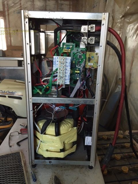

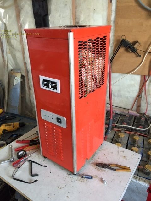

Joined: 07/11/2015
Posts: 86
Posted: 10:42am 16 Jan 2016
Well ordered new boards and everything is working fine,
Just want to thank Oztules and Clockman for posting all their
work.
My Oz-Inverter is 24volts 10000watt- 220 60hz split phase, I used a old air dryer encloser, the transformer weighs 75 lbs so I thought this floor mount enclosure would
work the best.
Billy
oztules
Joined: 26/07/2007
Posts: 1686
Posted: 03:08pm 16 Jan 2016
Good tall enclosure. It will help a great deal in getting the heat out of it.
I'm really liking that enclosure.. and these inverters generally... tough as nails.
Nice big transformer too.
............oztules

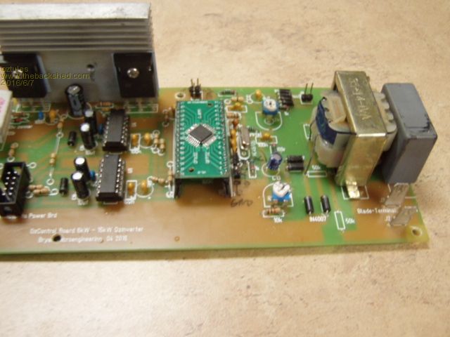

Hi Oztules,
I have been searching through the various forums about this inverter project and am very interested in building one.
One thing I have been trying to find out is how well it works as a charger and in particular switching from inverter to charger when a generator is connected. (I am using a 8kva Lister Stamford generator) There is mention of major problems switching at other than the peak of the wave, is that still the case?
I ideally I would like to be able to have the generator auto start if the battery voltage gets too low as I can do with the Trace SW4845E I am using at present. I understand there is no smarts in the inverter design to do this but it would be quite easy to setup that part with an Arduino.
Gary
oztules
Joined: 26/07/2007
Posts: 1686
Posted: 08:44pm 06 Jun 2016
I can't sensibly answer that.
Long ago I decided to use them as a inverter only ( unless grid tied, then it is a charger).
The recovery from switching off the grid to it, may have been solved in later units, but I have no knowledge of success or otherwise.
It is just as cheap and simple to buy a few of those meanwell power supplies and just drive the bank from those... maybe $30 each, and for 15A@28v is fine when you double them up.
Other folks may have had some success, but I am not game to try anymore... plus I have migrated across to the 8010 chip and drivers, as they run the unit cooler from tests so far... ie 10 mins of 5799 watts this morning went to 38C and no further with a single slow fan.... truly amazing efficiency from the looks of it... more testing to go.
Running this at the moment.
