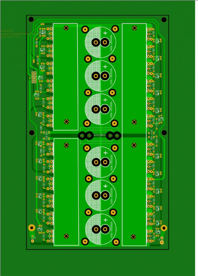

Looks very nice Naiclub... but not sure of the holes on the positive side of the caps, and the neg ones seem to be not connected to the bottom neg layer.
You also don't want conductivity on the heat sink holes on some layers... ie bottom layer to heat sink is ok for the pos one, but not the top layer, and opposite for the output heat sinks.

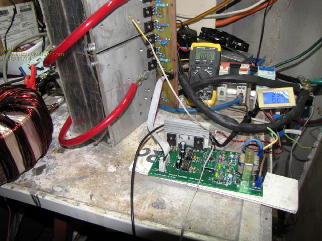

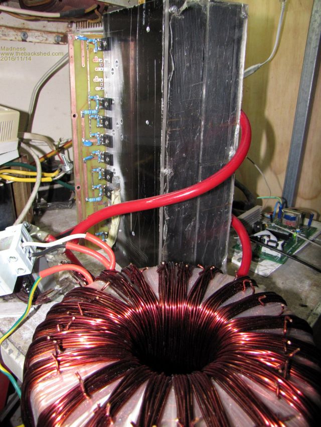

I had the Inverter running all day at idle with just a fan heater running off it on fan setting. Just put another 4 FETs on the board, so have 12 now and it runs just the same, very clean sine wave at idle, with fan heater on full just that little blip at zero crossing. With this load, the FETs run about 5 degrees above ambient, still with no fan on the heatsink.

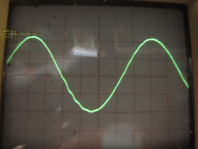

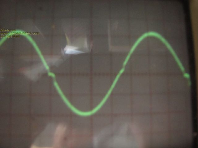

Now have 16 MOSFETs on board, idle was really clean, but since adding the last 4 there is just a slight distortion on idle. I am not sure if I should change the last 4 FETs to if there is any change. I am kind of over hearing them go bang.
And here it is with a load.
The blip is slightly larger than before but the other (slight) distortion seems to have disappeared.
It is a mess on the bench ATM but it is working.
That Toroid is one I knocked together quickly a while ago for testing, turns are not quite right as I just wound 22 turns over the original primary.
MM there is connected to 75MV 100A shunt, so input current is .8A DC voltage is 49.8V. So less than 40 watts with a fan running off of it.
Edited by Madness 2016-11-15

I have been thinking about the dead time, does it need to be a little longer to stop that blip?
DT1, DT0: Dead time setup
“00”: 300ns “10”: 1us
“01”: 500ns“11”: 1.5us
Currently, they are both grounded so running at 300ns, have you experimented with this Oz?
Posted: 01:57am 14 Nov 2016
The dead time will be difficult to change on oztules board, I think I will provide for the solder bridge selection like on the 002 board.
Ditto for the unipolar/bipolar selection once somebody explains to me what the difference is and how it affects the inverter.
This project provides plenty of opportunity to get clued up how these inverters work, I appreciate all the input here.

  oztules said   Looks very nice Naiclub... but not sure of the holes on the positive side of the caps, and the neg ones seem to be not connected to the bottom neg layer.
Mad... your lack of heat speaks volumes about your unit.... still cant see how you kill it so easily..... with that temp gradient, it sounds like the waveforms for switching are tickety boo...should be bullet proof from there. I am just not understanding the failures .... one step at a time I guess.
..........oztules
Thank you for your advice make it correct

Mad.... there is noise or something in there causing the sine wobble with 4 fets... not sure from where.
Perhaps see if a shorter ribbon helps, or dream up other changes. You have it right where you want it... ie you can effect change now to the shape ( adding fets), and when you can effect change, you can learn.... it is the only time you can really... My waves are very good, so am loathe to change anything at this stage... it alll just works
Unipolar and bipolar are two ways of doing the spwm.
I am using the unipolar.
This is where we run one side of the H bridge with a fundamental square wave of 50hz ( a full 1/100th second each time top and bottom) and modulate the oposite side of the bridge at the same time with 20khz spwm wave.... ie we leave say the bottom of the bridge turned on for the full 100th of a second, and fiddle the top half of the bridge with the sine wave info.
Bi polar is where we use the spwm information on both the top of the bridge and the bottom of the bridge at the same time... ie we are switching the top half with 20khz spwm, and the bottom half of the bridge with 20khz spwm at the exact same time to drive current into the primary.
I expected the bipolar to be much quieter than the unipolar, as the switching is all above hearing range, but in this 8010, it was noisier. In the PJ it is quieter as a rule.
Switching losses should be higher with bipolar. It is also why one set of heat sinks run hotter than the other two. In the current design, both the 002 and my 8010 switch spwm to both high and low side alternatively.
I was going to do all the spwm on the two low sides, but the temp of each says that 20khz is easy for the high side to do, as it is usually the same temp as the low side spwm bridge. Both high and low side spwm are hotter than the high and low side fundamental wave side of the bridges.
Have not changed the dead time, as works well anyway... however, easy enough to change on the 8010 chip board itself.. then plug it in.

I have a short ribbon cable that I have tried previously with a different board also I have made up a cable with 4 ground wires twisted with the 4 drive wires. As yet I have not tried it as I was getting good idle results until the last lot of FETs went in.
Have you tried different dead time? I have been getting that blip under load from the outset, I see you had it also in the early days of testing your boards, did you figure out any cause of it?

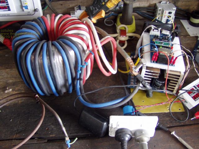

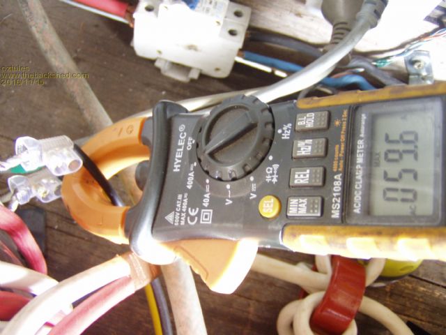

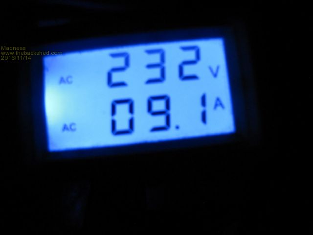

Mad... encouragement pics.
Was testing the current limiting abilities of the board with the scr jury rigged into it.
Must have restarted it 100 times under loads etc finding out how it functioned.
It functions very smoothly, and is now settable quite nicely from about 8 amps to over 60 amps on the 240v line.... these pics are with 5hp lathe motor starts. The meter is not super fast, but after about 20 starts and stops, it came in every time around the 57-59 amp mark... which is surprisingly consistent.. anyway it starts it fine.
Here is the meter on the 240v output 40 amp wire:
And here is the rats nest doing the 14-15kw of start ups.
I was concerned that stopping it mid stride with the scr may lead to spikes... but no.....it cuts it off perfectly smoothly. No sign of distress.
........oztules
Edited by oztules 2016-11-16
