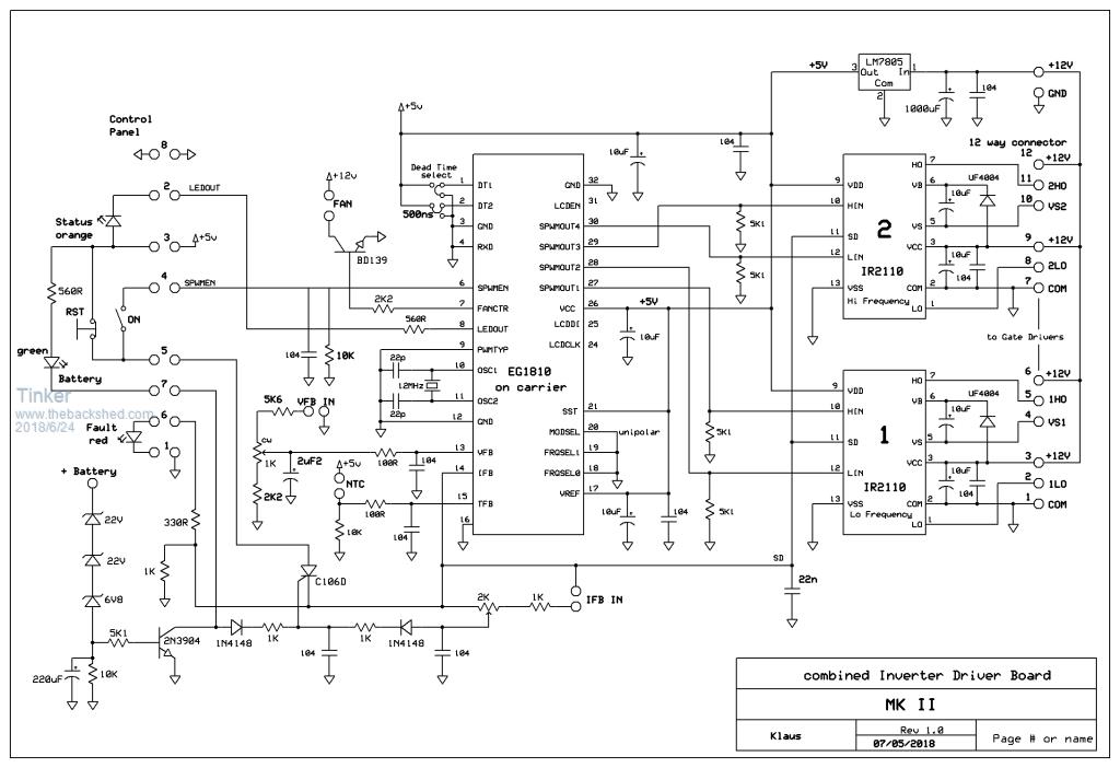

Good Day All
I have been steadily checking out the shut down on the EG8010,
and I have been able to replicate severe spikes on restart.
If the control PCB does not time out you can happily switch the on off button to your hearts content.
BUT BUT if the Eg8010 has timed out after errors from current , voltage or temperature
the severety of the spike, depends on what part of the cycle the eg8010 is in some times no spike other times sever spikes.
I believe that the eg8010 maintains a memory register at all times, and if you try to restart without dumping the eg8010 garbage memory, then you are playing eg8010
roulette.
The above problem is with all control PCB including madness latest board
I have found that if I insert a two way on on switch between the positive 48v supply and the 120 ohm 10w resistor with common connected to the
PCB power, one on switch on legs, connected to the 120 ohm resistor and the other on
leg of the switch connected negative earth.
The only catch is that after a eg8010 times out you need to switch on/ on to negative earth for 10 to 20 seconds, this time depends on what part of the cycle the eg8010 was in at power off, I use 20 second to be sure .
I have tried the above method on the bench with the scope, and at this stage have not had spikes on restart .
Will keep you updated
cheers john

So you are trying to tell me that you are turning on/off your inverter by messing with the power supplied to the control board?
I'm not 100% sure just how that ozinverter design is supposed to work but applying +5V to the EG1810 at the same time as to the SPWMEN (pin 6) is asking for trouble IMO.
Try this : Connect a 10K resistor from pin 6 EG1810 *permanently* to ground.
Power up so you have 5VDC to your control board but *not* to pin 6.
You should be able to power up and down your control board now without anything happening since pin 6 is held low.
Apply +5V via your ON/Off switch to pin 6, your EG1810 should start up now if everything (VFB, IFB, TFB) is correct.
Switch off ONLY by removing +5V from pin 6 (this automatically connects it to ground and turns off the chip). You MUST have power (+5V) to the chip at all times unless disconnecting your inverter from the batteries.
You do NOT turn it off by removing power from the control circuit. You should NOT try to reset it by doing this as well.
To fit a reset fit a N/C push button in the +5V line to your on/off switch. On my control board that also interrupts the +5V to the SCR, thus resetting it from a tripped state.
Trying to switch on/off or reset by removing (shortening) power to the whole of the control board is like playing Russian roulette and perhaps the cause of many of the mishaps posted here.
My inverters do not have that odd zener/ resistor shunt regulator to get + 12V from the 48V battery. This might do if nothing else is available but I found a DC/DC converter very reliable for this job and its not expensive. I think mad or somebody else showed a link for one that accepts up to 90V in and 12V out. I ordered two of these as spares, my original DC/DC (still in use) so far never let me down despite having a 70V input limit.Edited by Tinker 2018-06-25

John, I very much doubt that the EG1810 is designed for that 'treatment'.
Pin 6 is a dedicated on/off pin. Connected to ground, the output is disabled. Connected to +5V the output is enabled.
It will only do its job while the rest of the chip is powered up.
That "timing out" business you quote never has occurred here since my chip is always powered up.
If there is an overload/ over temperature shut down, the inverter stops. I manually reset it.

Posted: 11:07am 24 Jun 2018
John, what does your welder trip? the DC circuit breakers from the battery?
Overload should trip the IFB current sensing. On my inverter this shuts down the chip via turning on the SCR which in turn applies +5V to pin 14 AND shuts off the gate driver chips (SD input).
I can't remember any time it took me longer than the quoted number of cycles mentioned in the app notes to reset it.
However, in your welder case you might follow the last sentence of the AC current feedback notes - if you risk it. You can still use the drivers SD input for overload shut down. This might involve cutting PCB tracks.
When I shut my inverter down completely, like for working inside it, I trip the battery breakers after first switching the on/off SW (pin 6) off.
After that one has to soft re charge the capacitors anyway so the 5V power comes on softly as the caps charge up (the on/off switch remains OFF all the time then).
Once fully charged the series resistor gets shorted out (its across a breaker so that happens automatically) when the battery C/B's are turned on again.
Its now ready for a soft start via the on switch. This is not instant, it takes a few seconds to generate 230V after the switch is turned on.
Works every time for me.

No John, I'll post the reset circuit in a while, got to cook my dinner now .
OK, below is my version of the control board. The reset part is on the left via a 6 pin plug.
