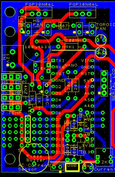

Just realized I made a stuffup on the control board fan MOSFETs. They need to be logic level to be driven directly by the Arduino, I will fix it later today.

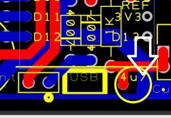

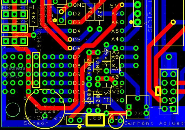

is there a hole for the right hand leg on this cap?

Yes there are holes, when the program generates PDFs it does not show the holes trough the copper for some reason.
It looks like this in the program.

Posted: 03:42am 26 Apr 2018
Now I have the correct MOSFETs for driving the fans. So in addition to the parts listed on page 9, there are 2 FQP30N06L MOSFETs which are 32A 60V TO220 logic level N-channel MOSFETs. If you have other N-channel logic level MOSFETs they will be fine also, they are only powering the fans which in most cases is less than 1A.
