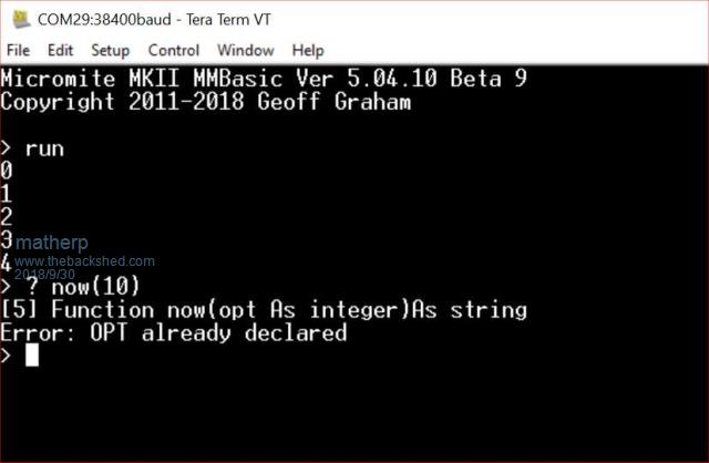

There is something odd going on with Function definitions. If I have had a program running and then break into it then call a function from the command line, I get an error on the definition line. If I clear the variables it works as expected, but after a RUN, I get the error again:
> clear
> ? now()
05-01-2000 11:32:21
> run
947071984 05-01-2000 11:33:04 05-01-2000 11:33:04 1 1
947071984
> ? now()
[349] Function Now(opt As Integer) As string
Error: OPT already declared

Posts: 12186
Posted: 08:05am 30 Sep 2018
  Quote  same code running on a MkII work as expected:
No it doesn't. The issue arises when you ctrl-C the program while it is in the function. If it is you get the issue. The attached program highlights the issue and was tested on MM2 and Armmite and both give the problem - I'll report to Geoff.
Note CONTINUE also doesn't work if you are in the function when ctrl-C is executed
Print now(a%)
a%=a%+1
Function now(opt As integer)As string
now=Str$(opt)
Pause 1000
End Function

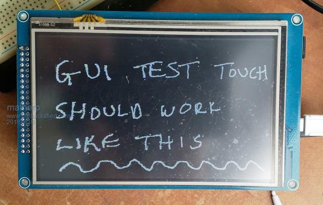

  Quote  Perhaps someone here can answer this, nothing I do will allow Calibrate without errors.
The code for calibration is identical for all the displays but I also find that the 7" display is much noisier and more difficult to calibrate accurately - the 5" display works perfectly every time. The 7" display uses a lot of power and has two onboard switching regulators so I suspect that it is inducing electrical noise and that for some reason the STM is more susceptible to this than the PIC. I've already put in additional checks into the calibration as someone else was having problems but I don't think the answer is in software.
Thanks, I'll try my 5" display tomorrow and then have a look at the 7" again with my 200 MHz digital storage scope and see what I can find for my own interest.

Just tried the 5" display, it's out about -4 and -8 but that is reported as no errors, however GUI TEST TOUCH has the same garbage on screen when used. Would be interested to know what others see with gui test touch display before I bother looking any further.

  Quote  I think the problem exists even if no "function" is used. By reprogramming (PICKIT-3) the problem can be prevented for a certain time, but it will come back.
The second reference is unrelated and was a simple bug in the way memory was allocated when DS18B20 was used.
On the first one, I think Ctrl-C/CONTINUE works perfectly EXCEPT when the code is running inside a function or subroutine when Ctrl-C is executed.
The problem found by CaptainBoing is more subtle, but again relates to executing Ctrl-C whilst processing is inside a subroutine.
Of course the probability of you seeing the problem is entirely defined by the amount of time the code spends in a subroutine compare to the main code which I demonstrated by ensuring that it was pretty much always in the subroutine in my little test program

  matherp said
Have you got a SDcard plugged in/connected and not configured?
My 5" looks similar to you picture with just a few more noise speckles, its GUI element boundaries are good, the 7" is a bit out on some GUI boundaries.
SD card in or out makes no difference, yes SD card is configured and works perfectly, SD-CS and T-CS work correctly when looking at signal timing on the CRO.
I'm going to power the 7" screens 5 volt and 3v3 supplies from separate regulators and see if there is any difference, no doubt you have already tried something like this but I'll give it a go in any case.
Thanks for the picture.

Posted: 04:55am 01 Oct 2018
More on the SSD1963 7" Touch screen.
I used 3 separate linear supplies, separate 5V and 3.3v to the LCD and a seperate 5V supply to the armmite, GUI calibrate returned around the same errors of X -2 to -7 and Y -48 to 58.
The interesting thing is that no matter where I press on the screen during Calibrate, the errors returned are basically the same? However the touch position coordinates returned to the program are now way out of position - obviously.
Do the above on a MM-100 and you get errors over a 1000.
There is something not right here:
If I make a page with about 12 buttons then the 7" is unusable - some buttons work, others don't respond, if you use a touch pen you can get some to work, but touch with a finger and what you get is the button press (sometimes) along with a zero returned to the Touch ISR indicating an area of screen with no GUI assignemnt was touched.
This does not happen with the MM-100.
The 5" screen is usable BUT in reality, only with a touch pen. Pressing with a finger returns the button MOST of the time but also returns 0 as well a lot of the time.
Again the MM-100 works fine and does not return 0 unless you press on the edge of a button.
So until I can solve the 7" LCD touch problem it's basically unusable as I really need the 7" screen to work.
This problem with returning almost the same small error values no matter where you press on the screen in calibrate with respect to the calibrate circles is strange, are they being limited in SW and not being displayed?
Any other ideas? Does someone have a 5" display running with around 5 buttons along the bottom of the screen, how reliable is it with using your hands for touch control?
It's a shame as I really love the Armmite now, and the possibilities it promises.
Mike.

  Quote  So until I can solve the 7" LCD touch problem it's basically unusable as I really need the 7" screen to work.
Please try the attached and let me know if it improves things
2018-10-01_191415_Armmite1.3.zip
KeepIS
Joined: 13/10/2014
Posts: 2287
Posted: 09:41am 01 Oct 2018
Thank you, thank you, thank you X 100
Max error -8 on first try with 7" screen, no errors reported and every GUI is great with hand touch.
Thanks again - this is great.
EDIT Y error down to -5 on the second try, tested the limits of the 17 screen button - as good as the M-100, even ONE very small button can be used by hand, the on screen Keypad is now perfect to use.
EDIT: GUI TEST TOUCH now works as expected, one dot exactly where I touch instead of a line of rubbish in random directions
Edited by KeepIS 2018-10-03
