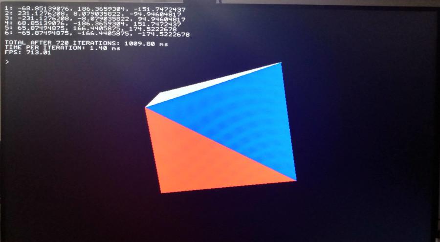

Posted: 05:49am 13 Nov 2020
I was wrong, after a new optimization, my new time is 1009.80 ms. The adjusted time is 1191.56 ms.
Can we get down to less than 1s?
Edited 2020-11-13 15:53 by LeoNicolas

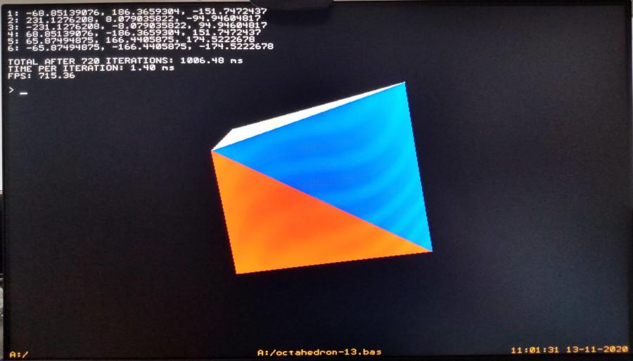

Posted: 07:16pm 13 Nov 2020
I managed to drop the execution time by a few milliseconds. The code is bigger than the last version but is faster.
Total time: 1006.48 ms
Adjusted time (x 1.18): 1187.64 ms

Wow, now we are officially below 1s. Congratulations, 770ms in a 400MHz CMM2 is impressive.

Posted: 03:54am 14 Nov 2020
vegipete, I really don't know how you achieved this execution time, it's amazing. I'm curious to see your code... let's wait for the end of the challenge.
This is an awesome opportunity to learn new optimization strategies
I've checked my octahedron width and length to see if I'm rendering it with the wrong size (greater than the specification) but it is right. It has 400px height and width before rotation. My main loop is very very small and even removing the rotation process I cannot drop below 1s
After updating my CMM2 to the R14 firmware my time dropped to 1004.14 ms
