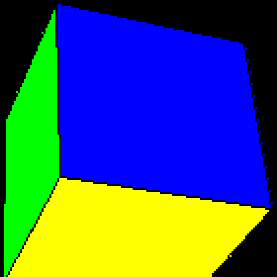

  matherp said
  Quote  This suggests the polygon outline code is using different float rounding/truncating than the polygon fill code.
It uses floats rather than doubles for performance reasons - use integers
I may have found a case where this isn't possible. Or something related.
Below is the rotating cube example from the 3D engine manual. I made a few changes:
1) I changed the colour of the edges to 0 - black (same effect with 'notblack')
2) I changed the scaling to twice as big
3) I added a keypress to step through the rotations.
Examination of individual frames shows the same issue of faces (drawn as filled polygons?) not filled in properly. And the DRAW3D CREATE command won't allow an integer vertex array.
On a related yet different matter, is there a suggestion for how to draw 3D objects on a non-black background? PAGE COPY with "don't copy black pixels" does part of it but the background has to be redrawn to erase the old image. Less background re-drawing would be possible if there were a means of determining (rectangular) extents (the bounding box) of the 3D object projection.
DIM FLOAT vertices(2,7) = (-1,1,-1, 1,1,-1, 1,-1,-1, -1,-1,-1, -1,1,1, 1,1,1, 1,-1,1, -1,-1,1)
DIM INTEGER facecount(5)=(4,4,4,4,4,4)
DIM INTEGER faces(23)=(0,1,2,3, 1,5,6,2, 0,4,5,1, 5,4,7,6, 2,6,7,3, 0,3,7,4)
DIM INTEGER colours(6)=(rgb(blue), rgb(green), rgb(yellow), rgb(cyan), rgb(red), rgb(magenta),0)
DIM INTEGER edge(5)=(6,6,6,6,6,6)
DIM INTEGER fill(5)=(0,1,2,3,4,5)
DIM n=1, nv=8, nf=6, camera=1
MATH SCALE vertices(), 200.0, vertices()
DRAW3D CREATE n, nv, nf, camera, vertices(), facecount(), faces(), colours(), edge(), fill()
DIM FLOAT yaw=rad(1), pitch=rad(2), roll=rad(0.5)
DIM FLOAT q(4)
DIM INTEGER viewplane=500
DRAW3D CAMERA n, viewplane
DIM INTEGER x=0, y=0, z=1000
PAGE WRITE 1
DRAW3D SHOW n, x, y, z
DO
 MATH Q_EULER yaw, pitch, roll, q()
 DRAW3D ROTATE q(),n
 DRAW3D show n,x,y,z
 INC yaw,RAD(1)
 INC pitch,RAD(2)
 INC roll,RAD(0.5)
 PAGE COPY 1 to 0,B
 do : loop until inkey$ <> ""
LOOP

Posts: 11741
Posted: 08:15am 14 May 2021
I can't see a simple fix to the fill issue. It arises from the different algorithms for triangle fill and line drawing. I've attached the code below. Feel free to translate to Basic and see if you can find a way through it. (4 sided shapes are filled as two triangles for efficiency)
You can establish the bounding rectangle using the functions draw3d(XMAX n) etc.

Posts: 11741
Posted: 08:07am 15 May 2021
V5.07.00b32 now available
This re-engineers the triangle drawing routine to ensure the border and fill match properly - serious testing needed
Re-times the MAP SET command to avoid artifacts on the last line

  matherp said  V5.07.00b32 now available
Considerably better, not quite perfect.

Posts: 11741
Posted: 06:26pm 15 May 2021
I think I've found the problem - it was caused by drawing the line from the opposite end in which case Bresenham may calculate different pixels.
V5.07.00b33 now available
Also improves rotation of areas with even number of pixels
Allows peek/poke access to the vartbl for simple variables and not just strings and arrays

Triangles (and quadrangles) are so far appearing flawlessly now. Great work!
