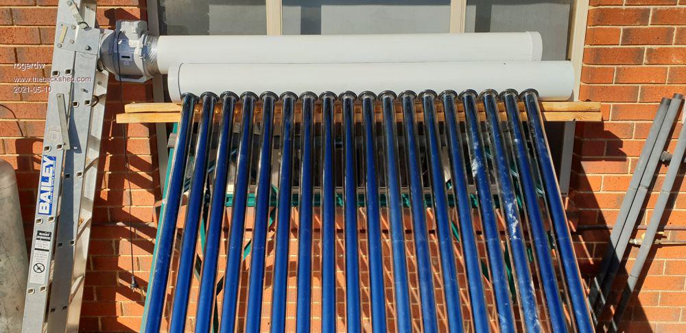

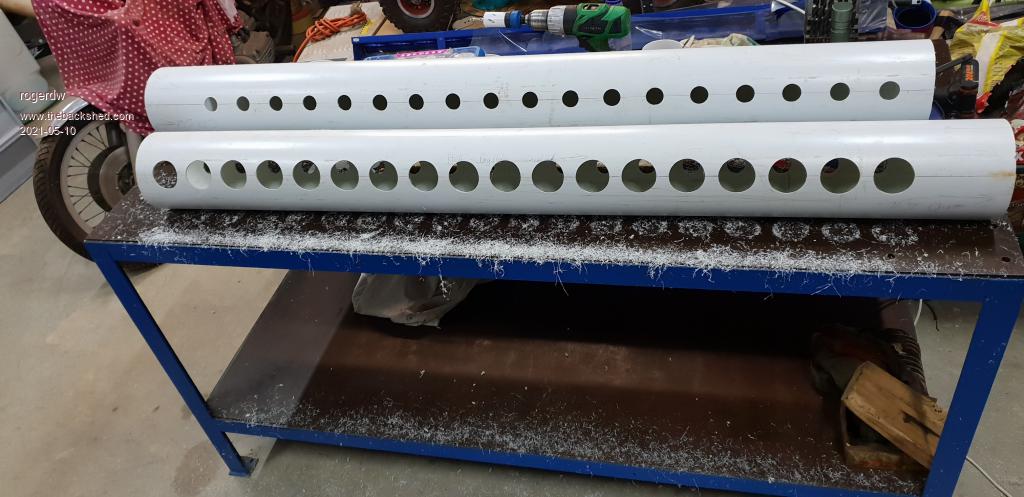

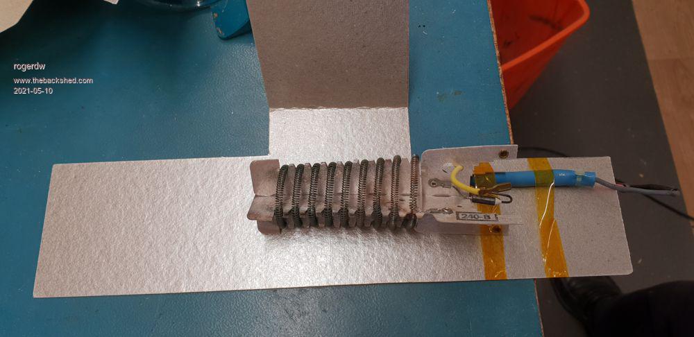

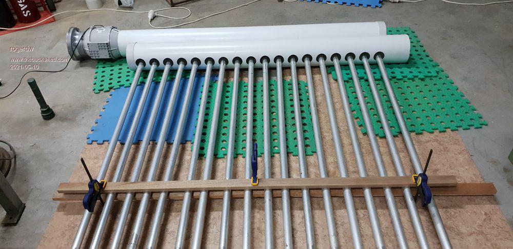

The easiest for me at this stage is still going to be hot air. So initially I still want to just blow it into the house like you are doing with your fan idea.

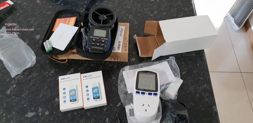

I've been taking temperatures all over the place so I can have a before and after so I know if it's worth pursuing  ...  and it's one of the reasons I haven't started the fire yet because hopefully I can see a benefit from the heated air before I stoke it up and then I won't be sure which one is doing what.
  Quote  The way I see it there are 2 parts to this system, the heat generation and the storage.... and maybe the distribution.  In any case the generation and distribution will be the same regardless of the storage medium.  Get the generation working first, measure it and get some Numbers then add the ( cheap) storage system, work out your numbers again and then build the final iteration from there Knowing you are close to the mark as you can be without spending the big bux.
Yep, that is exactly right. I reckon I can build a full set of 18 tubes over the weekend from what I already know and can start piping in any heat to see what it does.
The tools and meters I've ordered off eBay should be here early next week too  ...  so I should have some actual figures to work with as well.

Well I've learned a few things over the last few days which have been a bit disheartening  ...  but I've come this far so I need to follow through for a bit longer.
Tony had suggested I need to do an equivalent power test and I had been dragging my feet because I wasn't sure if I'd be able to work out how to do it successfully.
My other test gear hasn't arrived yet, but on fri I pulled apart a heatgun and pinched the element. I then mounted that on a piece of insulating material.
I lengthened the heater outlet tube by ~600mm and shoved the heater a fair way down  ...  noted the output temperature  ...
...  then I powered up the element via a variac until the temperature doubled.
The heatgun is a 1,200 watt 240v unit  ...  5 amps  ...  so the element should be 48 ohms, which it is!
My first test was on Fri at 12:10pm, ambient was 25 though we had probably 90% cloud cover.
The heater outlet was 33.3  ...  so I needed to get to 66.6  ...  which I did fairly easily at 100.2v.
Of course power = V squared/R = 208 watts!
Pretty miserable  ...  though of course only 6 tubes  ...  so all 18 should give 600 watts  ...  which is still miserable.
I wondered about increasing the temperature by decreasing the airflow through the machine, which I did  ...
This time the power level was 89 watts. Wow, getting more miserable.
Tony had suggested he thought I was going to need a high fan speed  ...  so I switched the fan to top speed  ...  pretty much all my tests so far have been on the lower of the two speeds.
This test gave an output of 259 watts  ...  so a little better.
Later in the day I had to go out, so switched off the fan. When I came back at 4:40pm I ran it again  ...  checked temp and then powered element to double the heat.
This time it was 330 watts  ...  but this was not sustainable because while the fan is off, the tubes build up heat and can take 5 minutes to drop to an equalibrium where it will then remain depending on conditions.
I tried it again Sat morning before I pulled it apart to build a full size model.
Another dull grey day  ...  and at 10am we had 95% cloud cover, ambient of 15.5  ...  and output was 197 watts.
Again at 12 noon it was 199 watts. The results are pretty consistant so I'm fairly confident my measuring technique is ok.
I'm not sure what I was expecting, but the 6 tubes cover an area less than one 250 watt solar panel  ...  and I'm pretty sure under the conditions one of those would have had virtually no output  ...  so I have to be happy with what I've got.
I always envisioned a heater needing perhaps two lots of 18 tubes  ...  but that is still only perhaps 1,200 watts.
Anyway, I had committed to build an 18 tube heater, so that's what I'm working on now.

This is the heatgun element taped to some insulating material, which I powered up with a variac
Lots of use for my holesaw kit, at this rate I'm gunna wear it out. It sure is a pain prising the cutouts out of the saw though!
This tubing is 150mm and cost me $10 from the junkyard  ...  but two endcaps cost me $10 each from Bunnings.
I stuck some wide weatherproofing foam across the holes between the two tubes and then used a smaller diameter holepunch to cut the holes.
I bolted the tubes together, slid the tubes in and fed a wire through holes in the top of each tube so they can't slide out and drop to the bottom of the evacuated tubes like did happen with my first experiment.
That was a pain trying to line up the holes, but it worked in the end.
Oh, I forgot to mention  ...  the tubes only cost me $2 each  ...  but they were only 1,400mm  ...  so I welded 400mm onto each one.
I've never welded aluminium before and I did a really crap job. I started with the oxy, some proper flux and rods  ...  eventually gave up in disgust.
Then I tried the TIG and that was far worse, so I went back to the oxy. They'll have to do.
Mate...... You are trying to take on the welding equivalent of Brain surgery.
Welding tubes ( thinwall) with oxy??? Literally no welder in the world would even try that.  Aluminium has about a 3o threshold between coming up to welding temp and collapsing in a molten Puddle.
Even TIG on ally like that would be Aerospace level welding. Oh yeah, I have seen vids of guys using those Hanrob guns welding aluminium cans.... I also know the guy that did it, a very long time friend of my father that has now passed away a few years back but that guy was given a welding torch instead of a rattle as a baby and spent his whole life welding every day.
It's only air thats going to leak and that won't matter and no one will see it anyway so if they stay connected, job well and truly done!
You have made a great setup of this, very impressive but I think in your excitement you may have done what I am sure many of us have done and got a bit hopeful with expectations.
The reason I'm not doing solar heating is because I know from years past, even when I put up a laughable amount of panels, I can't make enough power to turn to heating I need. Yes my house is crappy far as heat loss goes but how many people you know have 25Kw of solar on their roofs?  All that and we still come up short not only through the house but because as you found, nothing solar works well when there is no freaking sun!  :0)
The problem is, 90% of sunny days here are warm enough so you don't need heating or need minimal. When it's really cold you need lots of heating and the solar power isn't there.
Same as at night. In this part of paradise, we don't get a lot of sunny nights and thats when the winter temperature plummets. Even the AC is prone to turning into a 1x 1.5M ice cube so this is why I'm going for combustion heating that creates heat not just effectively changes the form of the heat that is not present when I need it most.
I think you need to think of your setup not so much as a heating devise but a cost saving one. On sunny cool days it will save you firewood or running the AC but it's not going to ever be able to provide your main heating needs. If you can keep the house warm 3-4 days and not need the fire going  till 5PM, Bonus!
If it's cloudy and wet and you do need to fire it up, situation normal.
Seems to me the tube setup can potentially be quite  effective, the flaw perhaps is your expectation are a little High. :0)
This is like anything solar, a case of a bonus cost cutting arrangement rather than an absolute complete answer.

  Warpspeed said
I bought a few of those aluminium brazing rods from e-bay to try after watching a demo on you-tube. Very impressive, but it needs nice clean bright shiny aluminium to work well.
If the aluminium is old and oxidized and pitted, those brazing rods are pretty hopeless even after trying to get a clean surface.
If you are buying fresh brand new aluminium parts, its an ideal way to make nice strong leak free joints with thin material.  It works on thick material too, but its very slow and uses heaps of propane because the heat really spreads.
TIG + argon is far better and much faster for heavy aluminium parts.
The aluminium is in great condition and using the scotchbrite belt on the multitool makes it nice and shiny.
I think TIG is going to be out of the scope of my abilities  ...  at least without getting some lessons.
Okay, well my wife came home from her ambo nightshift, so I convinced her to help put this device together before she had a shower to go off to her main job. We carried it up the ladders and got our daughter to line up the pipes.
It had rained overnight and when we picked it up, the first thing that happened was a bucketful of water ran out the pipe, down my wife's sleeve to her armpit and soaked her ...  whoops.    Lucky she's a good sport.
Anyway, got it together and with the sun already out could see the temp climbing nicely.
Hooked up the fan and taped it on  ...  probably the first time ever in my life using duct tape to actually tape a duct!!!
I added an extra 3 ft of duct to the outlet and used my element to check power level.
This time the power was 752 watts  ...  which is pretty consistant with what I'd been getting earlier  ...
...  though I am still not sure if the IR device is a good idea for air temperature because I'm not sure if the localised heat from the elemment is not being picked up, despite my shielding. A proper temperature gauge might be a bit more accurate.
I just came in to regroup and have a coffee  ...  and the postie had just dropped off several eBay items  ...  an anemometer, a power meter and a couple datalogging temperature gauges. Now I should be able to monitor things a little better.
Cheers,  Roger
Posted: 01:38am 10 May 2021
Its always handy to have equipment to be able to measure things, and the Chinese stuff is very cheap for what it can do.
