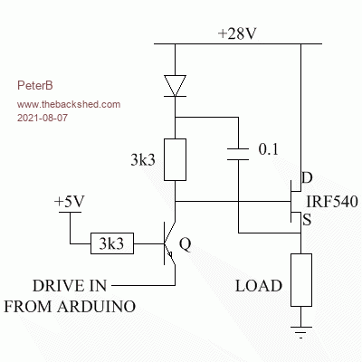

Posted: 04:43am 07 Aug 2021
G'Day All
I have spent the day working out how to attach a drawing to a TBS post.
Then finding my copy of TURBOCAD.
Then working out how to use it.
I don't know if this is what Bob has got and I'm not even sure it will work but for what it is worth.
And now I know how to do it until the next time.

Posted: 06:20am 07 Aug 2021
The bootstrap circuit will exceed the 20V rating for Vgs of the IRF540.
It might be a good idea to connect a 20V zener from gate to source.
Peter

Posts: 3409
Posted: 06:56am 07 Aug 2021
For a 1Hz flash rate the capacitor will need to be much bigger, 10uF might be enough. And don't forget that zener. You have tried similar bootstrap circuits before, so we are going around in circles.

  PeterB said  The bootstrap circuit will exceed the 20V rating for Vgs of the IRF540.
Definitely.
VGSth is max 4V (so this is worst case requirement to bottom-out the trans-conductance curve i.e. for a good low RDS).
Zener ratings are nominal and if you get an unlucky combination of a high zener and low fet, it could be enough to destroy the gate insulator. It isn't likely but 20V is too close for comfort in my books. Also I would like to protect the Arduino from any 27V spikes when Q opens up.
I would chuck something around 5V in there. We all have loads of 4V7 and 5V1 zeners kicking about right? An opportunity to use up more of that old stock.

Posts: 6624
Posted: 07:27am 07 Aug 2021
Peter
Wouldn't that result in a leakage current through the load?
Gate to transistor collector is where I would put it.

Posted: 07:57am 07 Aug 2021
I have started something haven't I.
Phil, the only discharge path for the 0.1 is leakage once the zener has got the voltage down to 20V. From then on it's anybody's guess. I have no idea what the required flash rate is so it's all a bit of by guess and by God.
CB, going for 5V would mean wasting all that stored charge. I suspect Bob has been using this circuit without a zener and with no problems but it is all a bit iffy.
Jim, Once the voltage has dropped to 20V there is no more leakage but I agree this is not an elegant solution.
I was hoping one of you would compliment me on my very beautiful schematic. You blokes have no style.
Peter

Posts: 9179
Posted: 08:12am 07 Aug 2021
I will certainly compliment you, PeterB, being a CAD fan myself. :)
Got real style me....
And nanoCAD. :)
I've never used a bootstrap circuit with a mosfet so I'm not qualified to figure this one out. Personally I'd do anything to avoid it. I don't like circuits that could be marginal in operation.

Posted: 02:21pm 07 Aug 2021
It might be a good idea to connect a 20V zener from gate to source.Peter
Top is 20v so Ill go with 16 or less. Maybe try 5 v too.
  phil99 said  For a 1Hz flash rate the capacitor will need to be much bigger, 10uF might be enough. And don't forget that zener. You have tried similar bootstrap circuits before, so we are going around in circles.
Left the 1 hertz some time back . Its White on for about 3 secs then 4 flashes of red in 1 sec then 4 flashes of blue then white back on . When I get something that works and I can see the effect I'll play with that and may leave the white on full time or drop it to half current maybe . Dunno until I get there.
  PeterB said  I was hoping one of you would compliment me on my very beautiful schematic. You blokes have no style.   Peter
Well I will . Any schematic I can read is good for me and that one is very clear . Just wondering in the light of whats been said what I should actually use for a circuit.?
