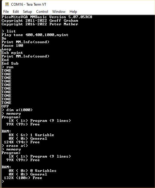

Q. When does Erase not Erase?
A. When you do this.
PicoMite MMBasic Version 5.07.05RC7
Copyright 2011-2022 Geoff Graham
Copyright 2016-2022 Peter Mather
> clear:for n=1 to 100:dim a(3000):erase a():?n:memory :next
1
Program:
  1K ( 1%) Program (18 lines)
119K (99%) Free
RAM:
  1K ( 1%) 1 Variable
 24K (15%) General
127K (84%) Free
2
Program:
119K (99%) Free
RAM:
  1K ( 1%) 1 Variable
 47K (30%) General
104K (69%) Free
3
Program:
119K (99%) Free
RAM:
  1K ( 1%) 1 Variable
 71K (46%) General
 80K (53%) Free
4
Program:
119K (99%) Free
RAM:
  1K ( 1%) 1 Variable
 94K (61%) General
 57K (38%) Free
5
Program:
119K (99%) Free
RAM:
  1K ( 1%) 1 Variable
118K (77%) General
 33K (22%) Free
Error : Not enough memory
PS. Clear won't get it going again either
Edited 2022-10-17 14:43 by phil99
Posts: 12181
Posted: 09:43am 17 Oct 2022
Thanks - will fix

Posts: 12181
Posted: 10:55am 19 Oct 2022
PicoMite V5.07.05RC8
Corrects reporting of MM.HRES and MM.VRES by OPTION LIST when a user driver is loaded
Fixes bug in PLAY TONE n. m. d, interrupt which caused the interrupt not to fire
Fixes bug in ERASE command when erasing arrays
Fixes bug in audio commands executed at the command line - introduced in previous RC
Implements mm.info$(sound) to report status of the audio channel
Implements ON PS2 interrupt. This triggers an interrupt whenever the PicoMite sees a message from the PS2 interface.
Use MM.info(PS2) to report the raw message received. This allows the programmer to trap both keypress and release.
See https://wiki.osdev.org/PS/2_Keyboard for the scan codes (Set 2).
Resets default fonts when a new program is loaded or the NEW command is executed.

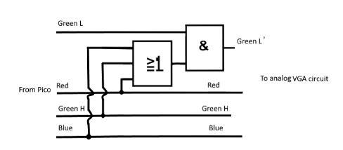

What do "transparent pixels" mean with regards BLITE (or SPRITE) WRITE?
Could there be a means to specify which colour number is to be treated as transparent?
This comes about from Martin H's 'On the Road Again' demo code. His car sprites include the colour black for the tyres, so using black as transparent won't work well. This would be solved if we could specify which of the colours [white, yellow, lilac, brown, fuchsia, rust, magenta, red, cyan, green, cerulean, midgreen, cobalt, myrtle, blue and black] is to be transparent.

  vegipete said  What do "transparent pixels" mean with regards BLITE (or SPRITE) WRITE?
that would be a great addition. If the sprite now touches the edge or the grass, the background shines through the tires (because they are black). Another possibility, but certainly more complex, would be to create a binary mask, which decides what remains visible from the background. The calculation would be
BG-Pixel AND Mask-Pixel OR Sprite-Pixel
but that would be a whole new program function. I'm glad that we got the possibility of layers and framebuffers in the new version at all.

Instead of black (for tyres etc) could use a near-black (so the transparent black can stay as is)?

  JohnS said  Instead of black (for tyres etc) could use a near-black (so the transparent black can stay as is)?
Surely I can, I tryed the darkest color possible RGB (0,64,0).
This looks a little flat and low-contrast, but it works. Vegipetes proposal, to be able to choose the transparent color, would still have a charm .

Put a 4k7 trim-pot in series with GP19 - the Green Low bit pin. You can then adjust  RGB(0,64,0) to look almost black when needed.
It will only have a small effect on other colours.

  phil99 said  Put a 4k7 trim-pot in series with GP19 - the Green Low bit pin. You can then adjust  RGB(0,64,0) to look almost black when needed.
Dark-Green is the new Black
I could also do something like using an OR Gate for Red,GreenHigh,Blue and connect the Output together with GreenLow to an AND Gate, so that the Output (New GreenLow) is always 0 if non of the other ColorBits are 1.
Compared to your approach, you only lose one color (Dark Green) and not 8
nice but with both ideas, you'll lose the Compatibility.
It would only look good on your Pico. Thus, the program would be not, or limited usable for all others.
Edited 2022-10-26 23:09 by Martin H.
Please note that the dot clock (pixel clock) is 25MHz(40ns). You need fast logic to do this (with gate delay of 10ns, 2 gates = 20ns, you loose half the pixel). Or you "delay" the other 3 color signals by the same amount (3 x 2 gates), and potentially Hsync (1 x 2 gates). Vsync may not be that critical.
