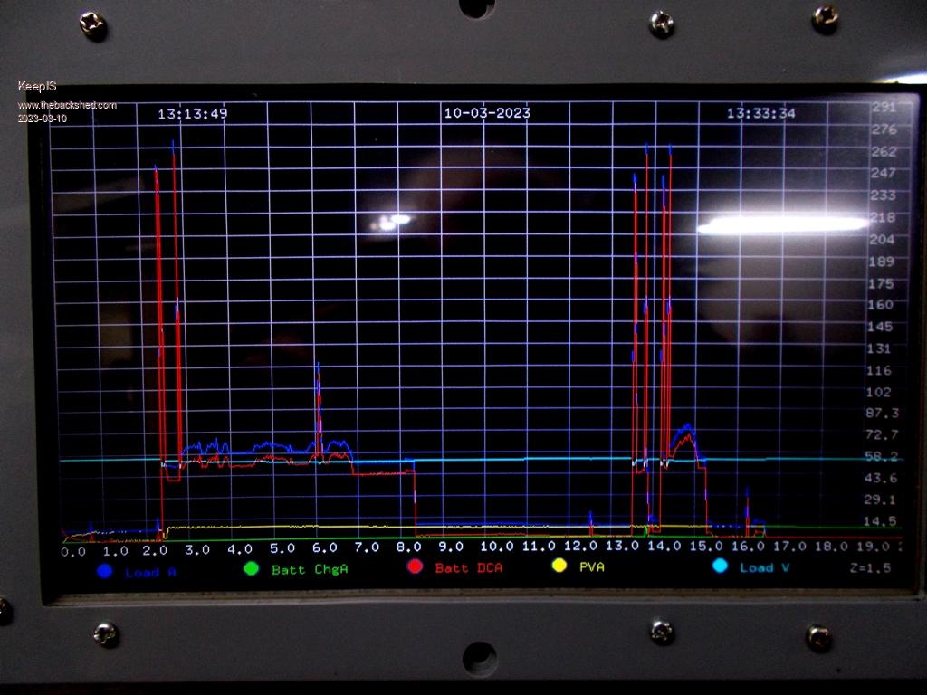

Posted: 06:15am 10 Mar 2023
RH Scale Current and Volts, Current in Amps.
We had just powered up some Big Wood working equipment and once it was running I switched the ATS back to "Mains Priority" just before the 14 minute mark.
Everything shut down and then restarted, I thought the worst [Inverter], my wife restarted the Wood working equipment thinking it was now on mains, and before I had realized that it was the MAINS that had tripped and the Inverter had switched back in, hence two more double 13.3kW peaks on the Inverter Log graph.
BTW the earlier peaks at 2 minutes were from me doing some testing with the same two pieces of equipment.
Why both mains "current trip" units tripped when the ATS switched over to mains I don't know, one Switch is in the Shed Fuse box and the other in the Main supply fuse Box for the shed Feed.
FYI the Inverter DC input Isolater / Pre-charge solenoid I posted about is just magic, I can't really measure any voltage drop across it.
Been overcast dim and raining all day here
Edited 2023-03-10 16:16 by KeepIS

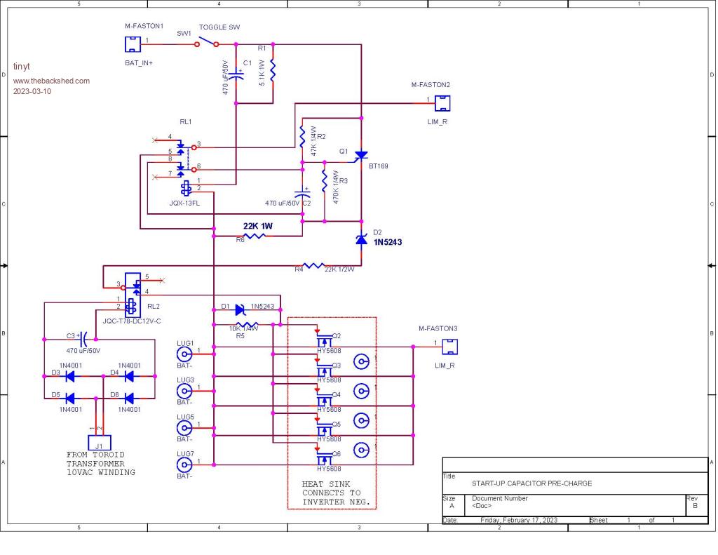

tinyt
Joined: 12/11/2017
Posts: 564
Posted: 01:59pm 10 Mar 2023
This is still on paper and copper but not yet assembled for testing.
The pre-charge resistor will be between the two LIM_R connectors.
In theory SW1 can be left on and if BAT power re-cycles, it will also re-cycle.
Edited 2023-03-11 00:13 by tinyt

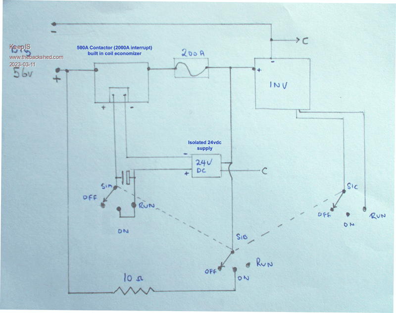

KeepIS
Joined: 13/10/2014
Posts: 2287
Posted: 02:22am 11 Mar 2023
Looks good, in the past I would have gone in that direction, and I almost did.
However in light of current circumstances (global and personal) I am doing everything with this off grid build to keep it simple, I may not be around to repair it if it fails.
Apology for the quick sketch of the circuit.
1: This Contactor is just beautiful quality with a very small footprint.
2: The terminals are very robust and of high quality.
3: All I needed to completely automate the Power up / Power down cycle was a single 3 position switch and an old 240vac -> 24vdc plug pack.
The following simple circuit is foolproof. You cannot catch it out.
I had the 3 pole 3 position switch in the parts bin along with the plug pack.
The Batteries are only connected to the the inverter when inverter caps are charged to 44 volts, takes around 1 second.
The plug pack holds power to the Contactor down to 17vdc input (very low hold current)
Best of all, I have a bin full of plug Packs, I have a spare Contactor and switch. If this ever fails (unlikely) it's a few seconds to repair for me and someone not so clued up should have no trouble diagnosing and repairing that part of the inverter.
So one switch to Connect / Disconnect the Battery's, leave it in standby or run, and it can auto start if required from any state including off. At the moment it only auto starts if it's in Standby. As the inverter is running 24/7 the auto start is hardly ever used.
Edited 2023-03-11 12:26 by KeepIS

  Quote   In theory SW1 can be left on and if BAT power re-cycles, it will also re-cycle.
This does exactly that: If it's running and you disconnect the batteries, the Contactor drops our "after" the Inverter caps have discharged down to 17v, which means that the inverter itself has already turned off due to Low battery voltage detection.
If you then reconnect the batteries, the inverter powers up almost instantly with no spark or high inrush current, just a loud clunk as the contactor pulls in when caps reach 44v.
In my case I have 350A isolation switches on each Battery bank, so no more switch jamming due to a partly fused contacts when I forget to disconnect the inverter or precharge the caps.
In my system, even if the inverter was on, the Load will not be reconnected until the Inverter AC output had reached 190 VAC AND the Battery voltage is above the minimum set value.
Edited 2023-03-11 13:39 by KeepIS
