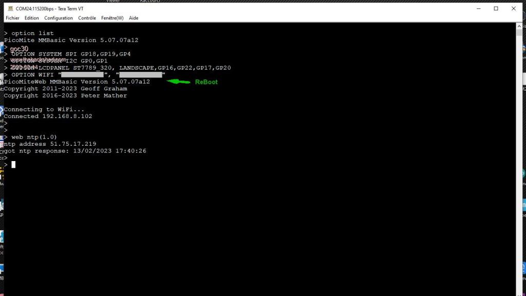

There is progress. I was able (finally) to enter my 3 minimum options "System" and lcdpanel without blocking the card.
However, after entering the WIFi option, I had to restart the pico (powet off/power on) because I couldn't do anything anymore.
After the restart, I have wifi.
A little more effort and the picoW under picomite will be almost as good as under Arduino

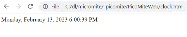

Without having any real understanding of how it might work with the PicoMiteWeb, I thought/hoped that javascript might work, since as I understand it, execution is on the PC side.
I have a little html file which presents Day of Week, Month, Day, Year, Time (with the time updated second by second). This works when I just put the local address of the file in a browser line: file:///C:/dl/micromite/_picomite/PicoMiteWeb/clock.htm
When I try to serve it from the PicoMiteWeb, I get a syntax error:
>run
ntp address 162.159.200.123
got ntp response: 13/02/2023 15:26:41
String is       GET / HTTP
sending page
[33] WEB transmit page ii%,"clock.htm"
Error : Expression syntax
Here's the HTML:
<html>
<div id="clockbox"></div>
<script type="text/javascript">
var tday=["Sunday","Monday","Tuesday","Wednesday","Thursday","Friday","Saturday"];
var tmonth=["January","February","March","April","May","June","July","August","September","October","November","December"];
function GetClock(){
var d=new Date();
var nday=d.getDay(),nmonth=d.getMonth(),ndate=d.getDate(),nyear=d.getFullYear();
var nhour=d.getHours(),nmin=d.getMinutes(),nsec=d.getSeconds(),ap;
if(nhour==0){ap=" AM";nhour=12;}
else if(nhour<12){ap=" AM";}
else if(nhour==12){ap=" PM";}
else if(nhour>12){ap=" PM";nhour-=12;}
if(nmin<=9) nmin="0"+nmin;
if(nsec<=9) nsec="0"+nsec;
var clocktext=""+tday[nday]+", "+tmonth[nmonth]+" "+ndate+", "+nyear+" "+nhour+":"+nmin+":"+nsec+ap+"";
document.getElementById('clockbox').innerHTML=clocktext;
GetClock();
setInterval(GetClock,1000);
</script>
<html>
Am I doing something wrong, and/or is there a way to get this to work on the PicoMiteWeb (the file is named "clock.htm")?

  Quote  Am I doing something wrong, and/or is there a way to get this to work on the PicoMiteWeb (the file is named "clock.htm")?
Hi, Lisby.
You'll need to put your javascript into a separate file eg "getclock.js" then add
<script src="getclock.js" type="text/javascript"></script>
to your HTML.
also, you'll need to add
ElseIf page$="getclock.js" Then
Print "Sending script"
WEB transmit file a%,"getclock.js","script/javascript"
into the TCPrequest subroutine.
The {} characters are being interpreted as tags for basic strings.
Edited 2023-02-14 10:58 by TheMonkeys

re your JavaScript.
If you leave it in the HTML file, just double up on the opening curly brace and all will be well again.
function GetClock(){{
It just won't run correctly when you test it on your local PC if you access the file directly.

You need to replace all instances of a single { with {{.
Any html file a single { indicates the start of a variable name. The double {{ is MMBasic's signal to send a single { and not substitute a variable value.
clock.html

I copied your "replace all instances of { with {{....."
Along the way, several keywords now are in capitals or initial capitals , these need to be in lower case.
Initial tmonth line has an extra CRLF.
else if has turned into ElseIf, function into Function.
Anyway, fixed these up and the clock now runs via the web page :)
