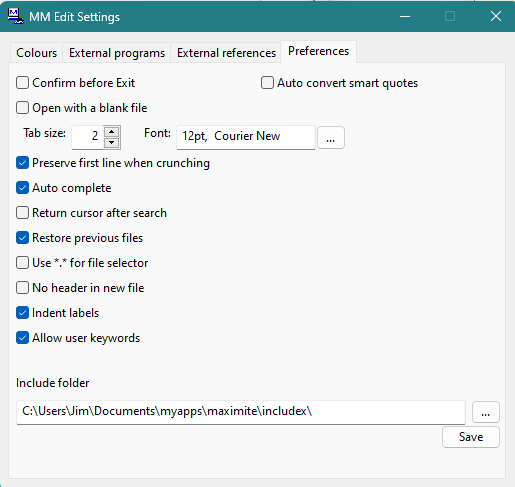

Hi Jim, I'm not running the latest version yet, but somehow I lost the MMEdit's known location of my INCLUDE files, probably my fault because I think I renamed the folder without telling MMEdit.
I went back a couple of posts and found how to tell MMEdit where it was so that's now OK. I don't know if that method is documented yet but it would be good if the location could be set in 'preferences', I think that is a more intuitive way to do it if that is possible.
Bill
PS. As I write this I think I may have said it before, if so, I apologise.
Posts: 6624
Posted: 04:46am 11 Jun 2023
  Quote   probably my fault because I think I renamed the folder without telling MMEdit.
A sure way to confuse MMEdit
  Quote  it would be good if the location could be set in 'preferences', I think that is a more intuitive way to do it if that is possible.
I have finally started to add things to Preferences so I will put it on the list.

Posts: 6624
Posted: 06:53am 11 Jun 2023
For Bill.
No change to the version.

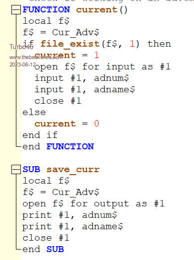

Hi Jim,
Just having a few funnies with MMEDIT.
I have been working with MMBasic DOS and hadn't noticed before but some keywords are not being high-lighted. I added them to BOTH DOS tkn files and now they work but I'm sure they were OK before?
I added the last line.
  Quote  string string$ string$( system tab tab( tan tan( text time time$ timer to triangle ucase
ucase$ ucase$( val val( wedit xor
print local loop then until next for
Another thing, when I first start MMEdit hardly any keywords are high-lighted:
If I change the syntax all high-lighting returns
One more thing, it always seems to want to start up with the syntax set to 'Maximite' no matter what syntax I was using.
I hope I have explained that clearly enough.
Bill
Posts: 6624
Posted: 05:07am 12 Jun 2023
As part of supplying the two lists - true keywords and keywords+parameters,
I decided to scrape the source code to create the lists. This works reasonably well but there are many differences between the source code structures and I managed to miss a few keywords.
I found many of them but, as you have discovered, I managed to miss some.
To set the default keyword list, select it from the menu then select the last item "Set current syntax as default".
This should be working but I have to get it to tick the menu item (and show the correct menu list.

I just set the default syntax to DOS and when restart MMEdit the syntax is set to MMB4W. I did it several times and it does it each time. Again, not many keywords are highlighted first up.
Set the default to CMM2 and when it is restarted it is set to Micromite. It seems to be almost as confused as me.
Bill
Posts: 6624
Posted: 05:57am 12 Jun 2023
I found a spot where I hadn't updated to account for the dual syntax menus
I think/hope I have fixed it now.
I will try and upload the fix later today but in the mean time,
remember that you can put the desired syntax directive in the first line of your program
 'Desk clock kw\picomite
Keyword file names with the trailing underscore are keywords only. Without the underscore, they include the parameters.

MMEdit V5.1.7 has been uploaded.
It is a bug-fix version addressing the syntax file selection highlighted by Bill.

Posted: 04:19am 13 Jun 2023
Thanks Jim, That seems to work well now. Not the first time but it did the second time and thereafter, I guess it needed to change the tkn file.
When edited the DOS.tkn file earlier to add the missing keywords, I made a copy first. I noticed with this new version that there was a new item in the syntax selection 'DOS - Copy' I don't think it was there before. Anyway, I deleted the copied tkn file and that fixed that.

Posted: 03:29am 14 Jun 2023
Sorry Jim, but I've come across another 'funny' thing. I down loaded the program from this post, opened the zip and double clicked the .bas file (I have .bas associated with MMEdit). The file came up without any highlighting, the default syntax was DOS as I had set it but the little box down the bottom said 'txt'.
Clicking on syntax > DOS fixes it of course but it seems that opening a bas file from inside a zip confuses it a little.
I zipped one of my own Basic files and repeated the procedure and got the same result. Oddly enough SUB and FUNCTION are highlighted but the tkn files contain no entries to highlight.
Bill
Posts: 6624
Posted: 08:08am 14 Jun 2023
SUB and FUNCTION are sued for code folding so they will always appear as a keyword.
That's the easy one to answer.
