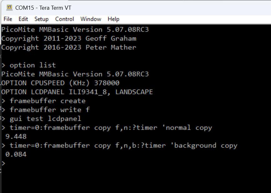

  Quote  There would then be no difference between VGA and LCD in terms of program speed.
Not the case. Framebuffer copy f,n on the VGA takes 0.6 mSec at 126MHz so max 1500FPS
Framebuffer copy to SPI still takes 90mSec so max 11FPS, it's just that you can do other processing while the copy is happening
That's what I meant with " in terms of program speed".
The Program continues while the 2nd CPU does the "Copy Job". So the Screen refresh is slower, but the Program not.

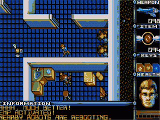

For the Programmers ..
Here are the last Missing graphics Converted to Pico 121 BMP ...
Keycards and Items
so my Pixelwork is done
Now to the next construction site...

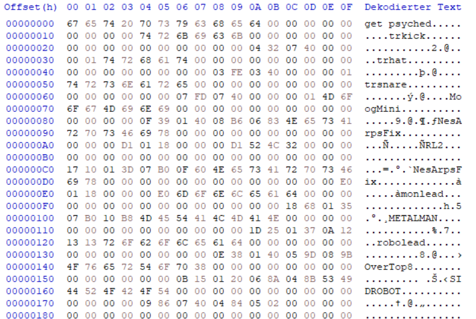

  matherp said
No. That is the whole point. The sound effect is coded on a specific channel (32 available) but is not included in the music schedule. PLAY MODSAMPLE triggers that channel alongside anything else playing
They are all on Github, but in an (for me) unknown Format.
Seem to be somehow like MOD but they are not MODFiles.
so I have to find a way to convert them(simply renaming them doesn' work   )

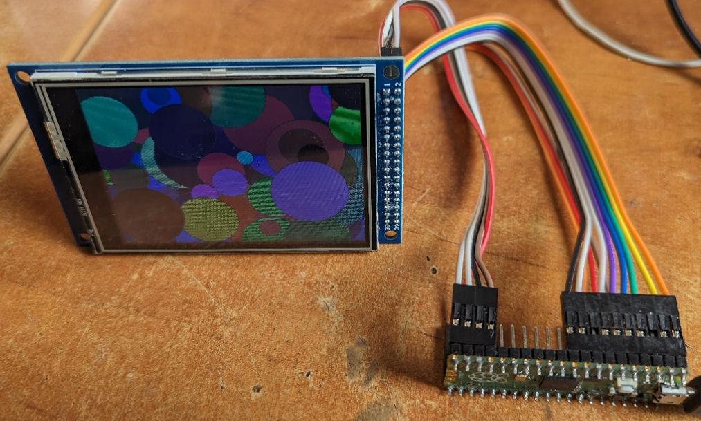

This is just a little test with the PicoMite and ILI9341 of Martin's idea of using 8x8 tiles and updating only the changed tiles. I took this image from the MSDOS manual and down-converted it to 320x240 and 16 colors.
This provides a play area of 264x200, or 825 8x8 tiles, 25 rows of 33 tiles each. In keeping with another of Martin's suggestions of using the "Information" area in the F framebuffer for tiles, I could save 120 tiles there--3 rows of 40 tiles. I generated the "tiles" by randomly painting pixels of the 16 defined colors of the PicoMite (red, green, blue, etc).
Then I simulated 320 rounds in which 5% of the tiles were changed. This resulted in a frame rate (with about 40 tiles per round changed) of 80fps.

Here's a 15-second youtube video
If 10% of the tiles change with each round (83 tiles), it's 35fps.
So a question for Martin: are you planning to generate the 8x8 tiles, and if so, do you have a rational play area made with them?
(The same would work in theory with larger tiles.)

Based on earlier provided artwork, and tilesets from Martin, I have the player walking the map under cursor control.
The "level-a" file in the data folder also contains tile attributes, and unit attributes. These are correctly decoded now, and I use them to determine where the player can walk.
But I noticed that my tiles are not 100% matching the maps (level-a, level-b etc..).
The first 2 rows, have different tile information. Maybe there is more unit-attributes than I thought, although what I see in the atributes fits the units nicely.
So debugging goes on...

I'll see later if I can get the sound files decrypted and reformat them to MOD if possible.
the decryption of the File Format should be hidden here.
Have Fun and good Luck
