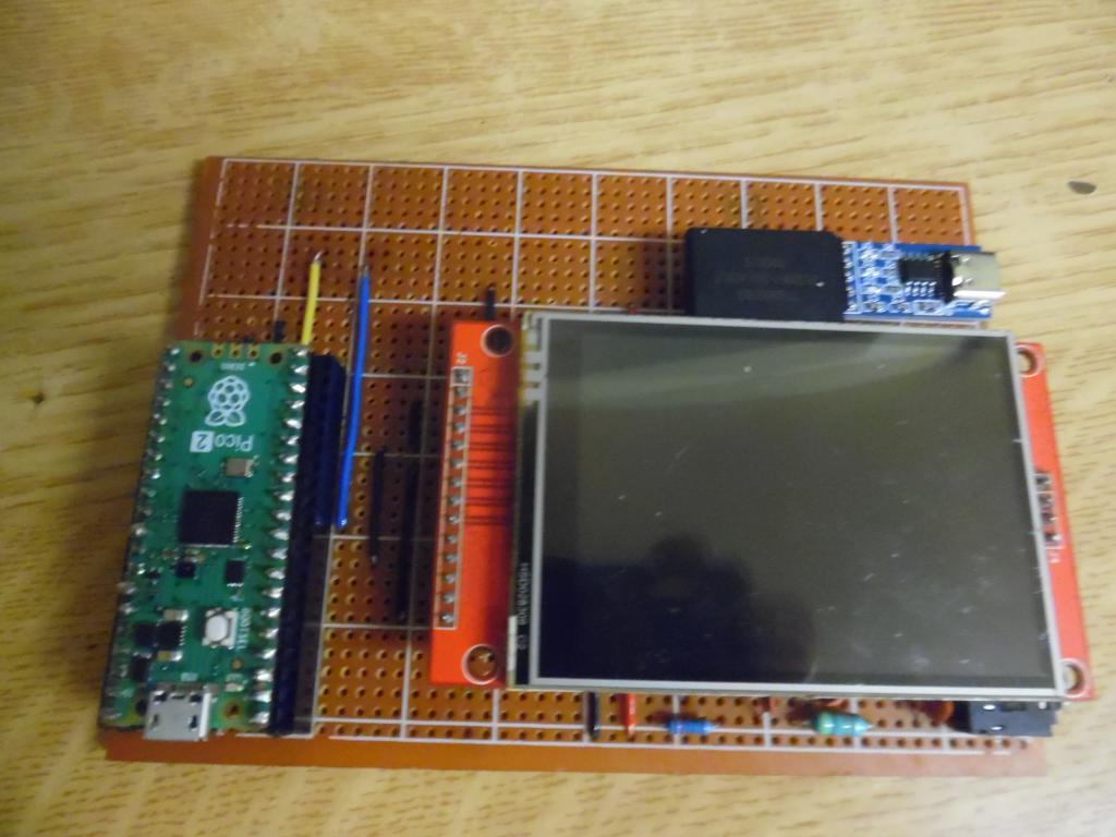

I added usc to ttl so I could usb pico version and added the sound filter,
all works, audio from sd card.
PicoMite MMBasic USB RP2350A Edition V6.01.00b8
OPTION AUTORUN  ON
OPTION FLASH SIZE 4194304
OPTION COLOURCODE ON
OPTION KEYBOARD UK
OPTION CPUSPEED (KHz) 378000
OPTION LCDPANEL ILI9341, LANDSCAPE,GP15,GP14,GP13
OPTION TOUCH GP12,GP11
GUI CALIBRATE 0, 3900, 3816, -887, -658
OPTION SDCARD GP22
OPTION AUDIO GP0,GP1', ON PWM CHANNEL 0
using pins in use
For m=0 To 28 :n= MM.Info(pinno "GP"+Str$(m)):print n,"GP"+Str$(m), MM.Info(pin n) :next
Sub MM.Startup
Local Integer m, n
For m=0 To 28
n = MM.Info(pinno "GP"+Str$(m))
If MM.Info(pin n)="OFF" Then SetPin n, DIN, PULLUP
Print n,"GP"+Str$(m), MM.Info(pin n)
Next
End Sub
I get
1     GP0     Boot Reserved : SSD RESET
2     GP1     Boot Reserved : AUDIO R
4     GP2     OFF
5     GP3     OFF
6     GP4     OFF
7     GP5     OFF
9     GP6     OFF
10    GP7     OFF
11    GP8     Boot Reserved : CONSOLE TX
12    GP9     Boot Reserved : CONSOLE RX
14    GP10    OFF
15    GP11    Boot Reserved : TOUCH IRQ
16    GP12    Boot Reserved : TOUCH CS
17    GP13    Boot Reserved : LCD CS
19    GP14    Boot Reserved : LCD Reset
20    GP15    Boot Reserved : LCD DC
21    GP16    Boot Reserved : SPI SYSTEM MISO
22    GP17    OFF
24    GP18    Boot Reserved : SPI SYSTEM CLK
25    GP19    Boot Reserved : SPI SYSTEM MOSI
26    GP20    OFF
27    GP21    OFF
29    GP22    Boot Reserved : SD CS
41    GP23    DOUT
42    GP24    DIN
43    GP25    HEARTBEAT
31    GP26    OFF
32    GP27    OFF
34    GP28    OFF
why GP0     Boot Reserved : SSD RESET not audio L ?

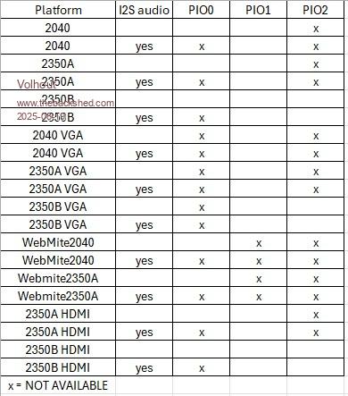

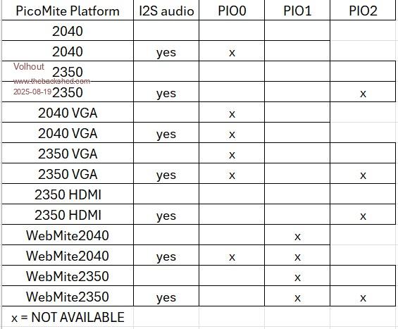

Hi Peter,
I understood that I2S audio uses PIO0. Correct ? All other audio systems do not use PIO.
Is below overview correct ?
Posts: 11785
Posted: 10:30am 19 Aug 2025
Only I2S uses PIO. RP2350 uses PIO2, RP2040 uses PIO0

Posts: 6050
Posted: 12:03pm 19 Aug 2025
@Peter,
I2S audio: on RP2350A also uses PIO2 ? Or only on RP2350B. On 2350, is VGA also in PIO2 then ?

Posts: 6050
Posted: 12:50pm 19 Aug 2025
Peter,
On 2040VGA PIO0 has both I2S and VGA combined.
On 2350VGA PIO2 combines I2S and VGA ? (or do they use separate PIO's) ?.
Posts: 11785
Posted: 01:21pm 19 Aug 2025
  Quote  On 2350VGA PIO2 combines I2S and VGA ? (or do they use separate PIO's) ?.
Separate, for some reason I couldn't get shared to work and in any case it makes it simpler to always use PIO2
Posts: 6050
Posted: 01:28pm 19 Aug 2025
OK, then this should be correct.
