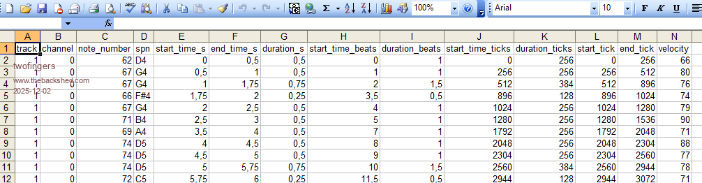

For example: First, I saved the sheet music for "Hark! - The Herald Angels Sings" as a CSV file (s. screenshot) from a MIDI file for comparison (D4, G4, G4, F#4, G4,...). In addition, the formulas (or functions) for Transpose SPN, Convert SPN -> Frequency, SPN -> MIDI(Number).

I'm sure you can figure it out yourself, but maybe RTTTL can give you some inspiration? I have a small RTTTL playback program that I could send you via PM for testing.

I should perhaps clarify that I only mean the storage format adapted for PicoMites as DATA lines: e.g.,
Tune1:
Data "Jingle Bells:d=4,o=5,b=170"
Data "B,B,B,P,B,B,B,P,B,D6,G.,8A,2B.,8P,C6,C6,C6."
Data "8C6,C6,B,B,8B,8B,B,A,A,B,2A,2D6"
Data ""
encodes this:
B 5      987.77Hz        353ms
B 5      987.77Hz        353ms
B 5      987.77Hz        353ms
B 5      987.77Hz        353ms
B 5      987.77Hz        353ms
B 5      987.77Hz        353ms
B 5      987.77Hz        353ms
D 6     1174.66Hz        353ms
G 5      783.99Hz        529ms
A 5      880.00Hz        176ms
B 5      987.77Hz       1059ms
C 6     1046.50Hz        353ms
C 6     1046.50Hz        353ms
C 6     1046.50Hz        529ms
C 6     1046.50Hz        176ms
C 6     1046.50Hz        353ms
B 5      987.77Hz        353ms
B 5      987.77Hz        353ms
B 5      987.77Hz        176ms
B 5      987.77Hz        176ms
B 5      987.77Hz        353ms
A 5      880.00Hz        353ms
A 5      880.00Hz        353ms
B 5      987.77Hz        353ms
A 5      880.00Hz        706ms
D 6     1174.66Hz        706ms
