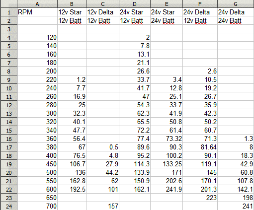

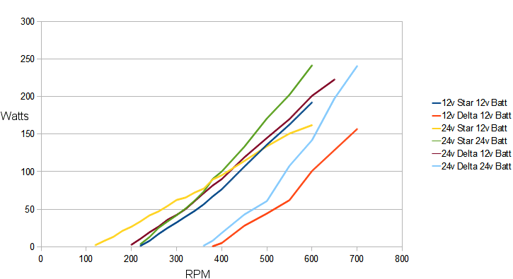

Posts: 5194
Posted: 08:43am 05 Sep 2011
Some figures
I think it would work best as a 24v alternator, that is 24v Star 24v Battery, with a high speed set of blades. It makes 170 watts at 500 RPM, and you could see closer to 250 or more in strong winds.
Edited by Gizmo 2011-09-06

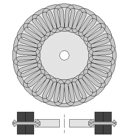

Posts: 5194
Posted: 10:43pm 05 Sep 2011
Thanks Bob, but unfortunately it will be like 6 months to a year before I have a place to fly it.
Besides, I've had a rethink, and I want to make another stator. The standard side by side coil arrangement is OK for Neo magnets and flat stator moulds, but I have weak ceramics and the tools to make a stepped mould. And someone made the comment about "empty space", and he's right, there is a lot of empty space where a magnet is passing over the stator, inside the coils, and there is nothing in the magnet flux path.
Overlapping coils is the solution. It ensures the magnets are always passing over copper and generating power. But it means the stator has to be thicker in parts so the coil bundles can pass over eachother. I can do that, with a bit of CAD work to get everything positioned correctly and the CNC to cut it out.
It also means I have 8 coils per phase instead of 4, 24 coils total. Since I have twice the number of coils, they only need half the turns to reach the sme voltage, 70 turns instead of 140. 70 turns will fit into a smaller space, so I can make the stator thinner, down to 6mm thick. That means I can brings the magnet plates closer, 8mm apart instead of 14mm. That gives a more intense magnet field, increases the volts per turn, and I only need 55 turns per coil.
So I've got more copper under magnets, and my coil resistance will be lower, which should mean more power.
Back to the workshop.

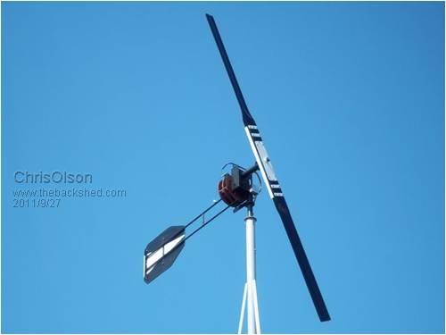

When I built that ferrite generator (I've actually built two more in the mean time) one of the criteria was to get it to fit on my present geared turbine frames. The larger diameter of the single stator unit would have required a re-design of the frame and gearbox.
We are now back into our windy season here, and today for instance, we had the usual 10-13 m/s wind all day and it has died down to 5-6 m/s during the night time hours. I didn't feel the 12G turbine was utilizing that ferrite generator to its full potential so I designed a new turbine for it.
The 13G is a 4.0 meter machine with a two-blade rotor. It uses the same gearbox as the 12G, and the same ferrite magnet, 10 pole two-phase generator, although I used 48 turns of 12 AWG wire in both stators on the subsequent two ferrite units I have built for the 13G design. The two blade rotor is harder to steer so the tail boom is 40 cm longer, although I used the same feather on the tail as the 12G so I did not increase the area of the tail feather itself. See attached photo of the 13G machine below.
The two blade rotor of the 13G runs at very high TSR (8.0 @ 5 m/sec as compared to the 12G's three blade (and experimental four blade rotor I was running on them), and it furls at TSR 7 @ 12 m/s running at 400 rpm, which is about 50 rpm faster than the 12G runs. It has a .4375 gear ratio, so the generator is running slightly over 900 rpm at furling speed.
The result is dramatically more power across the board from basically cut-in to full power. The pictured machine ran between 50-70 amps (24 volt system) for over 14 hours today and it's now down to about 15-20 amps during the night time hours. With three of them running it's holding our battery bank at 26.0-26.5 volts. I am not running my Jacobs turbine tonight because we do not need the power from it. And when we go to bed and turn everything off I'll probably shut down two more of the turbines and just use one 13G to keep the bank up over night.
To push those kinds of amps continuous with a single stator is a challenge. You have to use parallel windings (two or more in-hand) to do it. With the dual stator I wind with just one strand of wire which yields more compact and tighter coils that do not vibrate. With parallel windings you introduce the possibility of harmonics in the winding due to coils not being perfectly matched and resulting "circulating currents" even in wye windings. That problem is non-existent with the dual stator design. The dual stator design has lower mass in the rotating assembly, which allows the turbine rotor to accelerate faster and take advantage of wind gusts. A heavy rotating assembly that takes too much time to come up to speed when the wind speed increases loses out on power production - it all adds up on the kWh meter.
So I approach the problem from perhaps a different standpoint. I do not care as much about how many magnets I use as I do about flat-out high performance. If you approach the problem strictly from a materials use standpoint, then the single stator design perhaps wins out. But to build a high capacity, high amp generator I still think that's debatable.

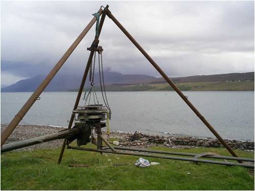

Big heavy alternators are a pain to move around but once they are up in the air they are very nice - slow and powerful. There are certainly some practical difficulties but we found that using a tripod and a chain hoist helped to reduce the pains in the spine.
If you back a trailer up to the head of the tower you can swing some pretty heavy parts over into position using the chain hoist attached to the tripod.

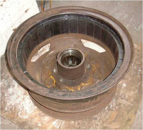

The F&P Smartdrive based wind turbines can also suffer from over speed, due to their impedance at higher RPM's. They will survive the event, though the rest of the machines is certainly strained.
I think the radial flux layout needs to be revisited. I remember looking at your drum brake design many years ago Hugh and thinking it had some good features. There are some advantages to the design, especially the addition of iron to make the best use of the weaker ceramic magnets. However making laminations is beyond the ability of most home workshops. But a few years ago there was a lot of discussion in the Seeley motors. Ceramic magnets, open copper windings, and a iron backing. Power figures were respectable.
http://www.thebackshed.com/forum/forum_posts.asp?TID=646&KW= seely
But there were some mechanical limitations that eventually killed interest, it just didn't lend itself to use on a windmill. The Seeley did have one design feature worth thinking about, its iron backing was made up of steel wire wrapped around a plastic former. Unfortunately the wire coils where not insulated from each other, so there where some eddy losses. Building from scratch, you would insulate the wire ( etch, paint, etc ) before winding.
I do think using this approach would turn the radial into a home workshop project, based on a drum brake, with the stator built to suit.
