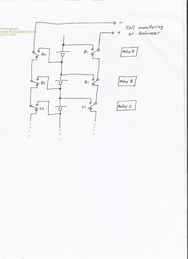

Posted: 07:01pm 22 Mar 2017
The mosfet option is interesting, but it has one serious disadvantage.
Mosfets can degrade (from electrostatic damage) or fail completely. A shorted out mosfet would be absolutely catastrophic to the whole system.
It would be a horrible job individually removing, testing, and replacing maybe a hundred and twenty mosfets because there was a major explosion.
And even a momentary electrical spike could spuriously turn on the wrong mosfet potentially blowing up the entire system.
Relays may be ancient, primitive and robust, but there are very few catastrophic failure modes if you use quality parts. The way I plan to do this, you can turn on any number of relays randomly, without the slightest chance any destructive failure.
There is no way that I can see of doing that with electronic switching.
This is the proposed hazard free relay switching idea:
Ah! the forum is now fixed, I can post pictures again. The IT guy deserves a special treat.Edited by Warpspeed 2017-03-24

Posted: 07:48pm 22 Mar 2017
Good choice Mike, I plan to use something very similar for the actual fully floating voltage monitoring,
International Rectifier PVA3354. Just in the last couple of weeks these devices have been listed as obsolete.
http://www.irf.com/product-info/datasheets/data/pva33.pdf
But I chickened out using them for switching between actual cells.
If one blows up, it will cause a cascading failure of all the others.
I will stick with relays. Relays are arguably more suitable for shuffling power around. Those mosfet switches really have too much on resistance for that.
But for fully floating voltage measurement, I only need four of these mosfet switches, and if one blows up, changing out only four is not such a big drama.

Oh my, you guys are thinking way to complicated and are likely to get bogged down with this, like I did when I came up with the idea .
For a start, the voltage difference between the cells is at worst a few tens of millivolts. If it is more you have a serious problem and need to individually charge each cell to exactly the same level before connecting any balancer.
Now Tony, the six seconds you quote above is in my experience far too long. Almost all of the useful charge transfer happens in the first second, the reminding time just a trifle more. I used 3 seconds connect time BTW.
But, as I mentioned before, I do *not* use this capacitor charge shuffling method any more. It only can maintain reasonable close matched cell voltages, its way too slow to make up large differences.
Also, the first few milliseconds connect time might see a high current across the relay contacts, putting inductance there only adds complication, especially when multiplied by 16 cells and the relays are taking already up a lot of PCB space.
The method I use now is similar with the relays but they encounter a steady current (<0.5A usually) during the *WHOLE* relay connect time (3 seconds). Much more charge gets transferred this way and the method is very satisfactory with my 48V/200Ah battery bank.
So, how is it done?
Simple, really.
Find a small DC/DC converter with an adjustable output voltage in the range of 3.6 - 3.8V. Mine can supply up to 4A but half that much is plenty.
Power this from a power supply (this *MUST* be isolated). I just use an old computer supply plugged into the 230V output of my inverter.
Set the DC/DC converter output to 3.8V and connect it to the relays *INSTEAD* of the capacitor.
Now each cell grabs whatever extra charge it requires to get level with any other. The lowest cell has the biggest voltage difference to 3.8V and so grabs more charge than the high cell which has less voltage difference.
I fitted a small analog Ampmeter in series with the DC/DC converter output and its interesting to watch the different equalization currents. As the equalisiton period nears its end the currents become very similar as are the cell voltages.
As this only runs after the solar panels reached 80V, indicating my Outback MPPT solar controller is throttling back, there is no chance overcharging my battery bank with the 3 seconds of 3.8V imposed on each cell in turn.
All stops after charging has completed (the panel voltage drops below 80V). This saves relay wear.
The cycle resumes the next time the battery cells are getting to the equalisation stage.
Think about it, simple = reliable. I learned that the hard way.

This is the basic logic diagram. Not literally correct.
The balance voltage is a divisional, adjusted follower of bank voltage.
I am surprised the useful charge is only in 3 seconds.
Exactly what happens when the contacts connect on cell, is it just the inrush you are using without looking at the continued equalisation process, or am I not getting something?
My thinking is based on equalization taking place between the cells individual voltage in series,
and the divisional balance voltage.
Similar to what happens when connecting cells together in parallel to balance them.
  Tinker said   But, as I mentioned before, I do *not* use this capacitor charge shuffling method any more. It only can maintain reasonable close matched cell voltages, its way too slow to make up large differences.
So, how is it done?
Simple, really.
Given my application uses PSOC, I am wondering what you think of the Balance voltage being a divisional follower of the bank voltage.
Is your DC/DC converter adjustable from a reference voltage.
Perhaps there is an adjustable DC/DC input follower available.
You have suggested 250ma balance current might do, but it seems low compared to the equalization effect between reference and the cells series supply.
You could well be right as the task is not to correct balance in new cell assemblies.
But?
What if the voltage was a direct division of bank and current were higher.
Commercial Active Balance systems start at 3A and transfer in both directions.
A 1.5A referenced balance supply for single direction might be needed for 100Ah?
Open to your thoughts.
Lifepo4 Cells have very little voltage variation outside of the cliff each end,
which is why many balance outside about 20 and 80% SOC, so it is sound from this prospective.
Obviously there is the difference between you equalizing at end of charge compared to all stages of cell use, but is there any other reason other then designing the system for your particular use?
There doesn't seem to be an obvious reason, why balancer shouldn't be engaged through charging if it follows bank voltage.
This could be seen as voltage correcting where lower cells would gain more.
The mythology is very different to a precise voltage measure for guessing cell Capacity.
Might work during lower charge levels, as a result of this difference?
What extent this would work with partial state of charge is questionable, but cell imbalance would also be less of an issue. The system would hopefully prevent cell runaway with PSOC, in a pre balanced bank with normal cell variance?
Hope you don't mind helping me out.
Thanks,
Edited by Gazz 2017-03-24
Gary
Posted: 12:15pm 23 Mar 2017
Now Tony, the six seconds you quote above is in my experience far too long. Almost all of the useful charge transfer happens in the first second, the reminding time just a trifle more. I used 3 seconds connect time BTW.[/quote]
Yes exactly. We want to shuffle just a tiny bit of energy in or out over the first second or so, then take a cell voltage measurement when the voltage is stable at the end of the six second period. The whole relay cycling thing needs to be slow enough not to kill the relays, but fast enough for fairly rapid response of the cell voltage measurement. I doubt if anything too serious can happen to cell voltage within three minutes, but I could be wrong.
[quote]
But, as I mentioned before, I do *not* use this capacitor charge shuffling method any more. It only can maintain reasonable close matched cell voltages, its way too slow to make up large differences.[/quote]
Its not supposed to fix a serious unbalance, just nibble away slowly and continuously over weeks, months, or years transferring only a tiny amount of charge to maintain balance.
[quote]
[/quote]
There is only one very small inductor placed in series with the voltage storing capacitor. All it does is eliminate the initial contact "micro splat" when the contacts initially close. Current through the inductor ramps up from zero allowing contact closure at zero initial current. If done properly the relay contacts should last just about forever.
Posted: 12:43pm 23 Mar 2017
  Gazz said
My thinking has been towards what you have described tonight.
That is a very ingenious idea, I really like it !
It solves the problem of having a different voltage sensing circuit fitted to each and every cell that needs to be accurately preset.
Use the original idea of comparing the average cell voltage with each cell, but use only the one single cell sensor and discharge load cycled across all cells via relay contacts.
The big problem with a hopping capacitor is the initial very violent initial current flow through the closing contact, which is going to eat relay contacts.
Placing an inductor in series will cause the current to ramp up relatively slowly on contact closure, then a ringing oscillatory current will be set up once the contact has closed. The ringing will quickly die away without any serious loss of total energy as would occur if a series resistance was added. So its much more efficient.
It needs to be efficient, because as Klaus quite rightly points out, the voltage difference between cells should hopefully be only millivolts, and there is not going to be a very large charge transfer unless the capacitor is enormous.
From what I have read, batteries that are not thrashed stay in pretty good balance anyway, and it takes almost nothing to keep them that way. So I am not looking at trying to quickly fix a serious unbalance problem. Just have a continuously cycling cell monitoring system system that tends towards improving balance rather than upsetting it. And something that does not need frequent maintenance, testing, or adjustment to work.
