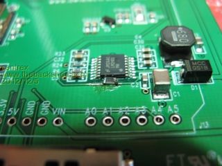

paceman
Joined: 07/10/2011
Posts: 1329
Posted: 02:00am 04 Dec 2012
  centrex said   I have just had a look at r6 on my board it appears to be labelled the same as r24 which is above r6 with my simple magnifying glass it appears to have 018 embossed on it.
Can one just cut the track leading away from r6 and insert a 120k resistor in series leaving r6 in place.
I would have more hope of doing this than trying to change r6.
Cliff,
Here's a (bad) photo of the through hole R6 resistor I put in after removing the SMD. I think you'd find this method easier than trying to cut that tiny track and solder one there. One end of my mod is terminated at C1 (the other end of that same track) rather than on the SMD pad and the other end of course goes to the SMD pad connected to pin 12 of the switching chip.
If you don't have a good magnifier and lighting it'll be pretty difficult so I think it'd be better to wait for CG's comments before tackling it. You can still run it all properly from USB or a 12v supply.
GregEdited by paceman 2012-12-05

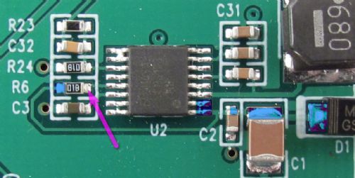

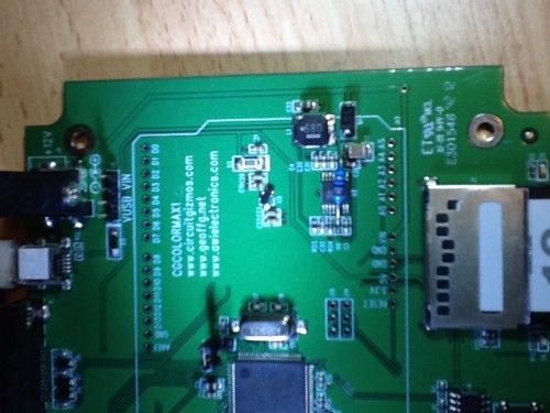

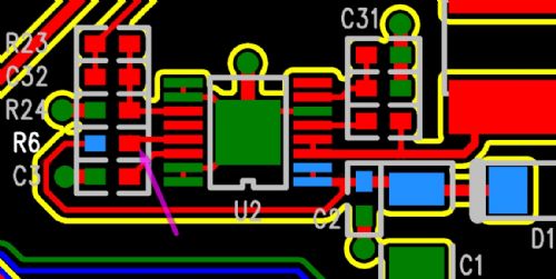

CircuitGizmos
Joined: 08/09/2011
Posts: 1427
Posted: 05:27am 04 Dec 2012
Greg's approach is an excellent solution. It is certainly easier to solder to other locations on the same net/track - a larger place to solder to.
Here are a couple of pics that will help:
Carefully remove R6.
One side of the replacement resistor (120 kohm) must connect to the pad that the purple/violet arrows is pointing to on both pictures. The other side of the replacement resistor should connect to one of the pads highlighted in blue.
Even I can understand that Rob.
Nicely drawn and explained. With the Red track that cuts through the text U2, the tracking is easily seen to these 6 potential Blue points.
Don...

CircuitGizmos
Joined: 08/09/2011
Posts: 1427
Posted: 12:12pm 04 Dec 2012
It is a B and that is a nice page that you linked to!

centrex
Joined: 13/11/2011
Posts: 320
Posted: 08:45pm 04 Dec 2012
All good info.
I have a 100k and a 150k smd resistors if the thing works with a 1K resistor it cannot be to critical.
I dont have anything less than a 1/2w thru hole resistor, I will give it some more thought.
Cliff
Cliff
centrex
Joined: 13/11/2011
Posts: 320
Posted: 09:47pm 04 Dec 2012
Decided to bight the bullet and cut the track and soldered in the 100K resistor not the neatest job but it all now works on 9 volt input.
The hands shake a bit after 75 years.
Anyway I am happy, now to put the colormite to a good use.
Thank you all.
Cliff
Cliff

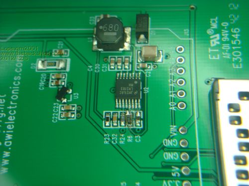

Lopezjm2001
Joined: 08/07/2012
Posts: 42
Posted: 09:12pm 05 Dec 2012
I managed to salvage a 115K SMD replacement resistor from a faulty Enginer BMS16D. 115K was the nearest value I could find. Note the great workmanship displayed in the photo, oh yes, this is definitely the Gizmo flag ship. I did the job with a fine tip temperature adjustable (300degC.) soldering iron and a magnifying lamp.
(I was referring to the workmaship of the photo itself).
EDITED: Now it will only boot up on occasions on my computer monitor at work using a 12 Vdc supply. The VGA monitor would not work at all when the Coulourmax was powered by the USB plug. I think I should have left it unmodified. But on the plus side the RTC works OK. I think it was booting up OK just the VGA monitor sometimes works and sometimes does not only when using a 12Vdc supply.
Just got home and it boots up every single time using my laptop and a 7" VGA screen using a USB plug. I also set the jumper setting when going to and from USB and 12Vdc supply every time. It also works perfectly using a 12Vdc power supply. It seems the Colourmax has an issue with my VGA monitor at work.Edited by Lopezjm2001 2012-12-07
Lopez
