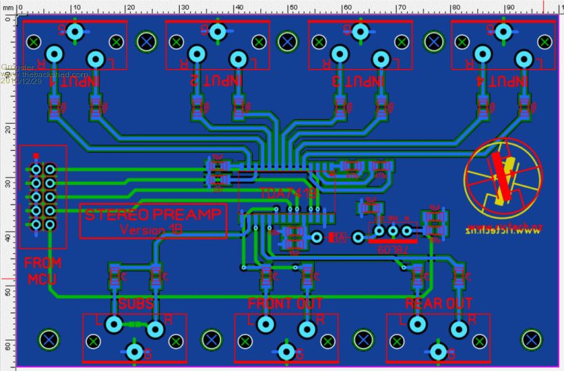

The new design is a two-board arrangement(three if you count the relay control board), and the pre-amp is totally seperate from the controller now - here is a first-draft image of the preamp layout:

The unit is being designed to use the small 2.8" parallel LCD for speed and so it is not too huge.
As to your requirements, you could use any standard supported parallel LCD for the MM+, but you would have to mount the LCD seperate from the controller, and run wires from the controller to the LCD, so that you can customize the wiring between them to suit.
The PCB layout will be designed to use the 9325 LCD's.

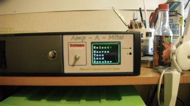

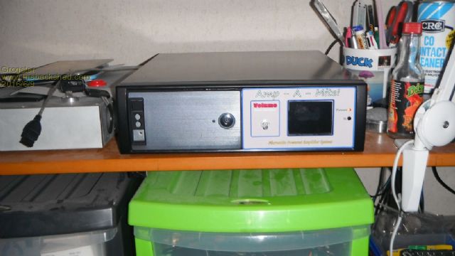

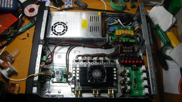

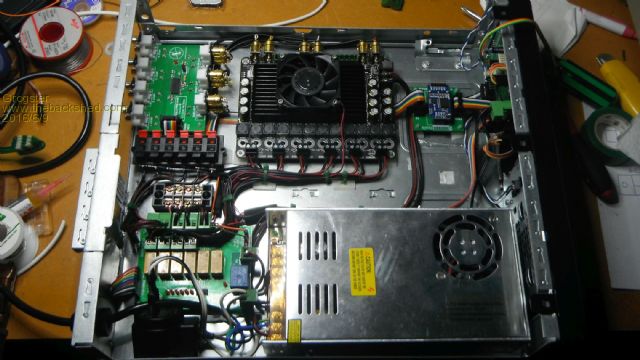

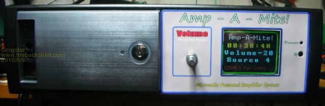

Posts: 10070
Posted: 07:56pm 08 Jun 2016
The 2nd prototype is finished, but I have not done anything more with it or about it.
It should be noted that jman and HankR helped a-lot with this project. Jman essentially did a page-1 rewrite of the code(wow!), and HankR helped me lots with the audio design side of things to improve the performance etc.
It is my main amp now, and it runs 24/7 and has been for the last couple of months and has never missed a beat - if you'll pardon the pun.
I need to finish this. There is no knob on the rotary encoder on the front panel, and the spectrum-analyser display is not working for some reason. I have emailed jman, but he must be busy with other things - I know the feeling!
Driving the 7419 is easy once you learn the control commands, but it cannot auto-select based on which one has audio, so you would have to think up some kind of magic there, but I am sure it is do-able.

I just used what was stated in the datasheet for a start, that being 100n for input and 4u7 for output, yes. 16v MLC's(multi-layer ceramic). Despite 100n seeming pretty low an input coupling cap, the audio seems fine.
In my PCB, I used MLC caps(ceramics), but you could use standard electros, as audio signals are reasonably forgiving when it comes to the coupling caps. MLC ceramics are still a good choice though IMHO.
I am working on a rebuild of this one!!!!
The new one uses six seperate 100W amps that use a +/-32v supply instead of just one single 32v rail, so have the potential to perform much better. The subwoofer does NOT have enough grunt on the 6-amp moudle I brought. It is driven into overload pretty easy, but HankR did suggest that would be the case with those amp IC's when he looked at the spec sheet(which was pretty vague - just like the 7419 datasheet in some respects - seems to be an ST trait!).
Anyway, I have yet to decided if I will just rebuild what I have using the 7419, or move to playing with the BD37534, as I have a board for that one too, but that would require some re-writing of the code as the BD part uses different I2C commands.
That is not really a deal-breaker for me though, just gives me a moment's pause.
EDIT: I suppose I should mention that this amp has been running 24/7 now for pretty much a whole year, and no MMBASIC bugs to report. The amp has been rock-solid in terms of how the MM+ controlling it goes.Edited by Grogster 2016-09-30
