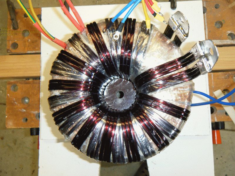

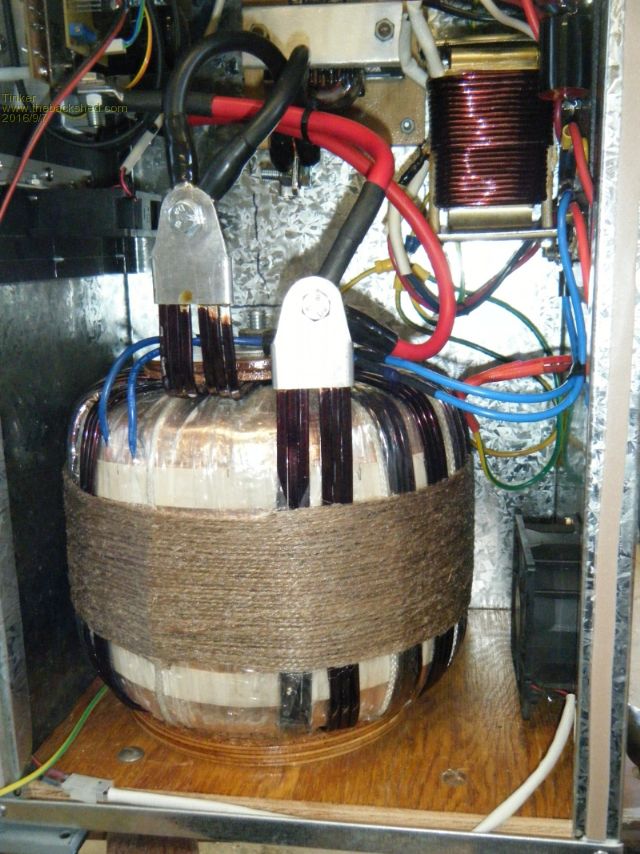

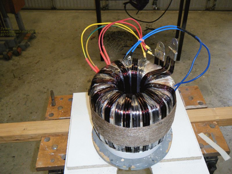

Another progress report, my gigantic toroid transformer is now finished .
For the primary winding I managed to get 3 x 5 mm enameled copper wire. A company nearby makes that to order (any size) but one has to buy quite a lot...
But, they seem to make a little more than has been ordered and these 'end of reel' leftovers I can get at an acceptable price. There is a catch though, this time they would not cut what I wanted (I required ~5kg) but I'd have to take all the leftover on the reel.
For the 3 x 5mm wire this was 9.5Kg, a little more than I required... hmmmmm.
A quick calculation showed that this amount of enameled wire was still more than $100.- cheaper than buying 24m of 20mm sq multi strand cable at trade price from Altronics.That would give 80mm sq at 4 in hand x 11 turns.
So I got twice the wire for much less .

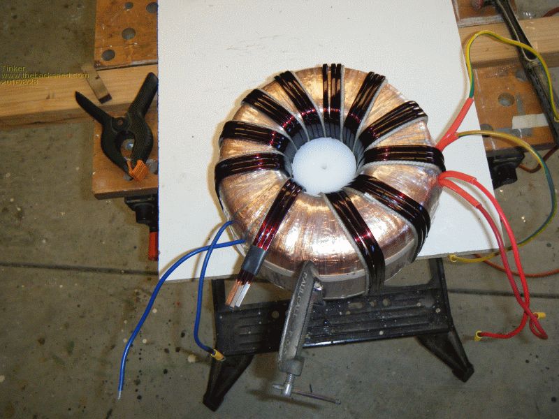

The plan was to do wind 6 in hand of 15mm sq. for a 90mm sq primary.
This wire, at 3mm thick, is about the max thickness easily bent around the core. That stuff work hardens real quick and one has to get it right first go.

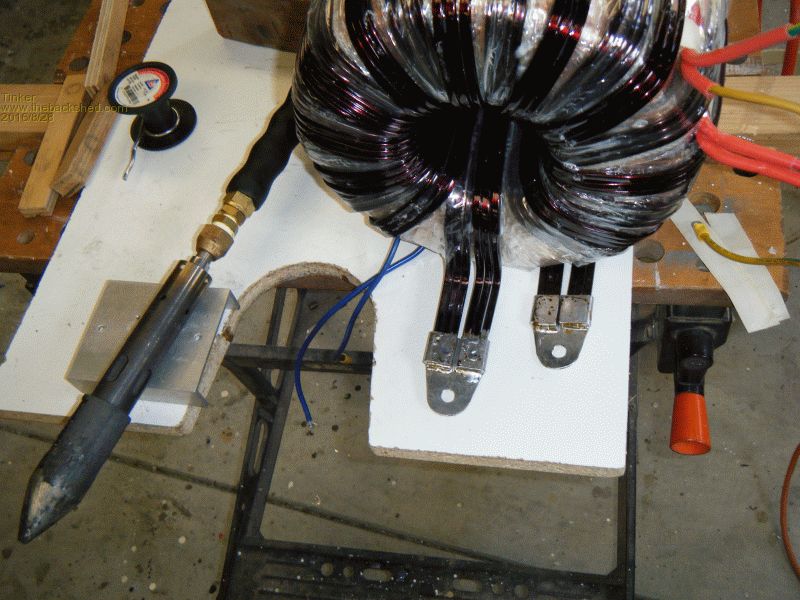

This is how I started:
The hardest part were the first two or three turns, the wire end (which I pre tinned) has to be held firmly in place to prevent it slipping. I used a 50mm belt to hold the first few turns in place around the core.
After the first 'hand' is wound on the next 'hands' can then be clamped to the first, making that job easier.
I cut the first wire a little longer than calculated so I then had the exact length for the next 5 'hands' with practically no waste off cuts.
3 in 'hand' wound on.
The VB cord seen sneaking around the core is there to even out the wire spacing in the hole. This needs to be a smooth surface for the next 3 in 'hand'. I wrapped more mylar tape over the first layer. The wire is hammered (plastic face hammer) around the top and bottom and I did not want to have it dig in the layer below there.
All 6 'hands' are now wound on, I used home made terminals at the ends. These were easily soldered with that giant gas soldering iron lying at the core side.
Now another epoxied twine tourniquet was wound on to finish it off neatly. The greyish disk under the core is actually a ball bearing turntable which makes moving the heavy core around a little finger job.
In the core center is a 16mm thick x 58mm diameter phenolic disk, epoxied in permanently. Its purpose is to center the mounting bolt. This toroid sits upright in the bottom of the enclosure, it is far too heavy to hang from a central bolt a la Aerosharp style.

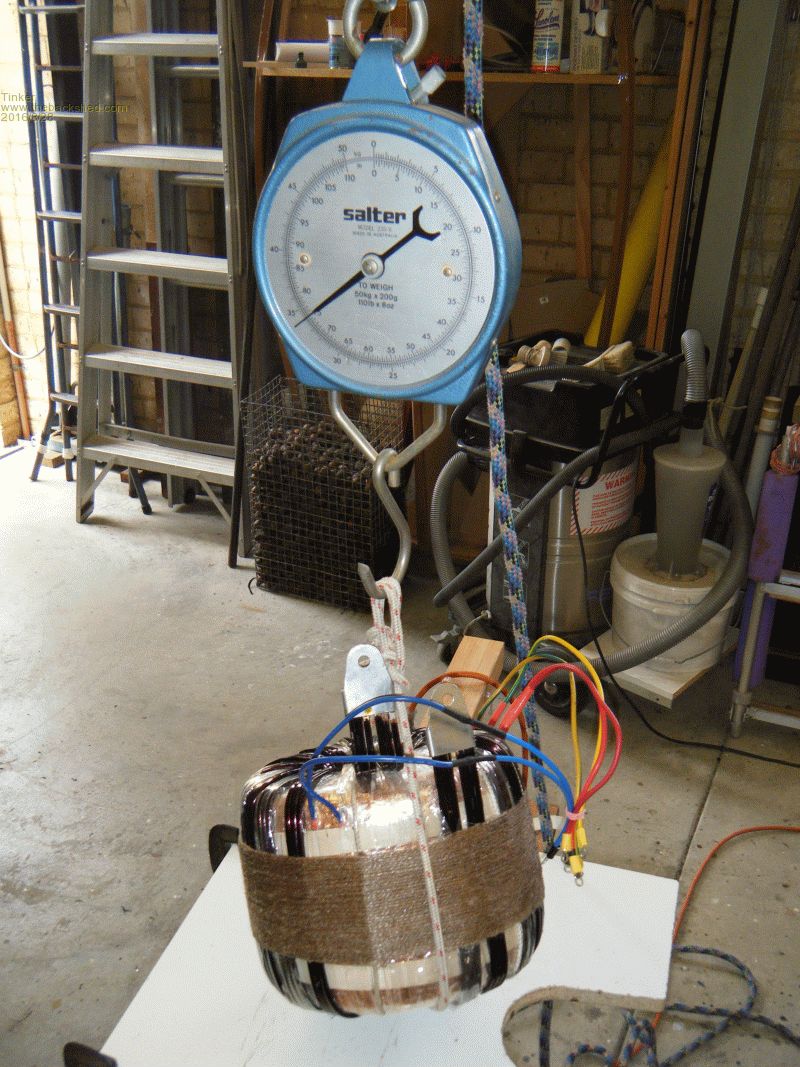

And here it is, all 34 kg of it .

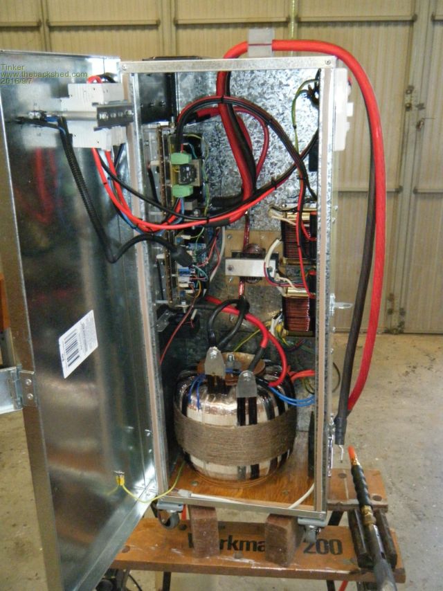

Now I still have to make the primary chokes (I have 3 different ones to experiment) and then the testing can begin.
The enclosure is just about finished too, the end of this built is in sight.

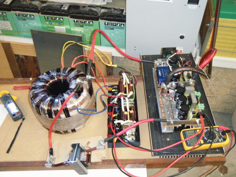

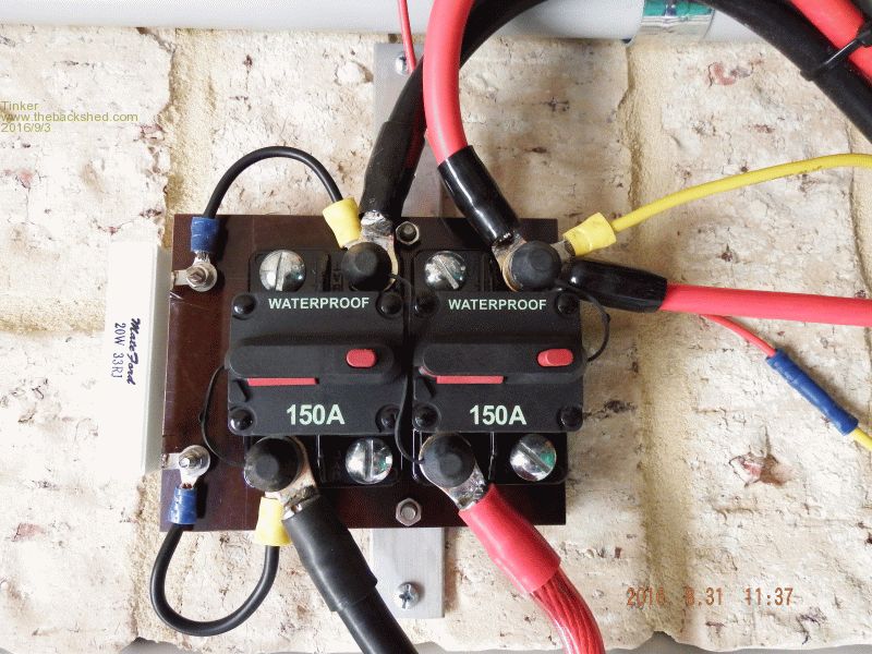

Messing about with connecting and disconnecting a big inverter from my battery bank I have to remember to be careful and use a resistor to pre charge the capacitors else there is a big "splat" and possibly spot welded terminals.
Well, I got sick of that and made this:
The resistor (salvaged off the Aerosharp board) is permanently connected across one battery isolator switch.
So, with both switches open, first the positive SW is closed. At this stage the inverter's capacitors begin to charge up, I count to five and close the second switch.
No "splat" and I can now turn on the inverter.
For those without a clamp Ampmeter, once both battery isolator switches are closed that resistor can be replaced by an Amp meter to measure the idle current - make sure no load is connected to save your amp meter fuse. Measure the current after opening that switch.
Also, close the switch and replace the resistor immediately after the measurements.

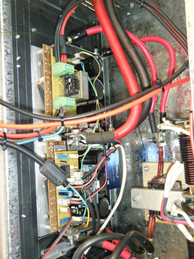

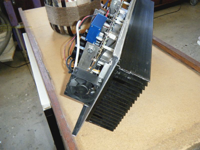

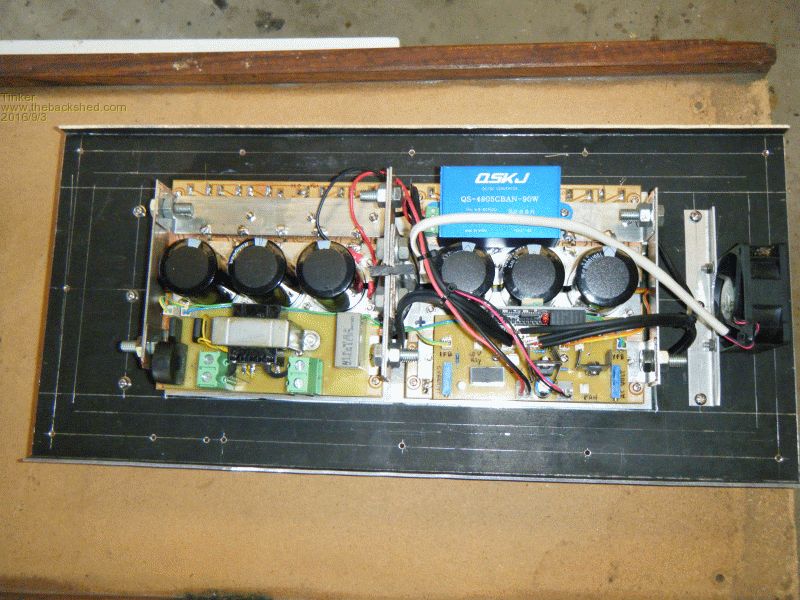

That nice big Aerosharp heat sink has an annoying flaw, it is mounted from the back side. It was hard enough to remove those screws in the original enclosure and I was not going to put up with that idea on my new dual stack inverter.
So I mounted the heat sink on a back plate, made from 2mm aluminium:
The entire heat sink pokes through a cut out in the enclosure and is screwed on from the outside. No more fiddling to line up screw holes while holding a heavy heat sink.
Just in case you are wondering, that little 60mm fan is a salvaged 24V unit and will run permanently on 12V, moving the air in the enclosure. It runs very quiet on 12V.
There also will be a bigger (92mm) fan that is pushing air in, controlled by the EG002 board.

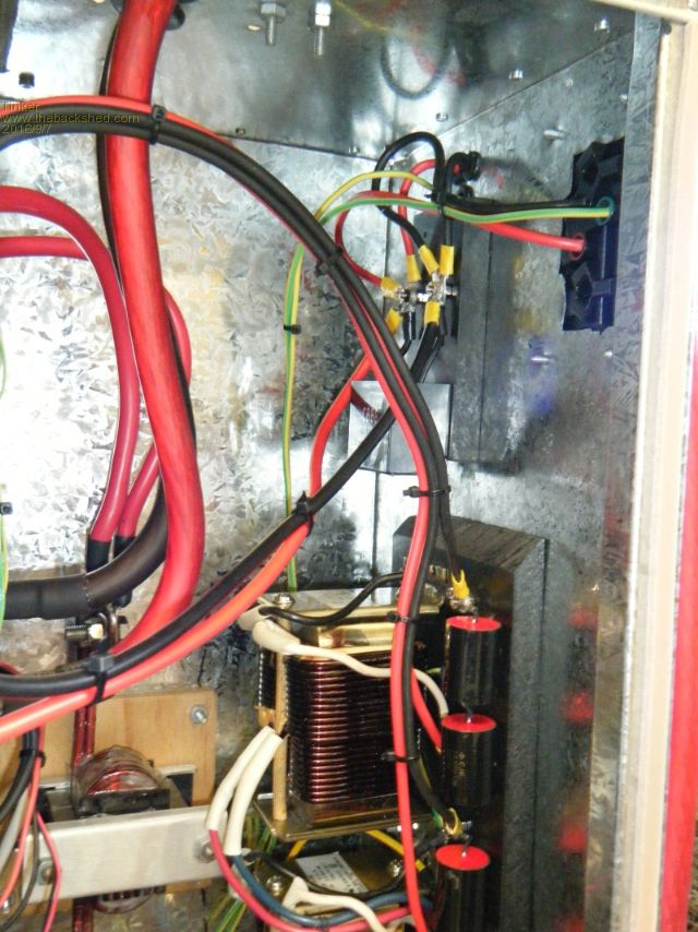

I used the big chokes from 2 Aerosharp units to make a mains filter. I know there are those filters:
But they are only good for 7Amps so I would require 4 in parallel.
What I did is reproduce the filter circuit with other salvaged parts:
Since my double stack transformer was wound with 2 identical 230V secondaries I can connect one winding to each filter so the 2 chokes share the power between them.
The 230V are paralleled after that, at the input to the Voltage & Current sensing board.
I do not know yet how that filter will perform.

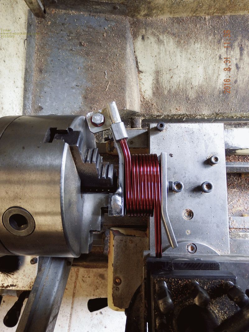

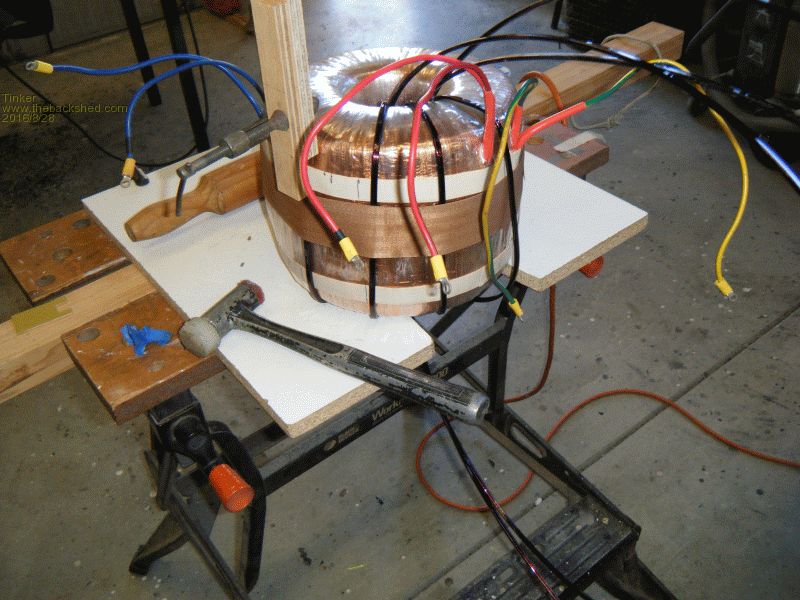

The primary choke has now been wound, I beefed up the jig a lot to make that easier.
There is a fair bit of hammering (soft face) involved to get that 4 in hand, 3 x 5 mm wire neatly wound on. It still bows out on the long side so the lot gets squashed a bit under my press after winding on all the turns.
There are 2 ways to wind 4 in hand 3x5 wire, on its wider side or on its narrower side.
Winding on the wider side is easy but there is only room for 3 turns on that plastic bobbin.
Winding on the narrow side is much harder but gives 4 turns.
I made one coil of each, the 3 turn coil to test the jig. This one is available, madness, if you still want it,send me a PM.
I did some testing previously with 3 & 4 turn coils (tinkers inverter project) and found there is a reduction in idle current - but not a lot - with 4 turns. That was with the PJ electronics. I will test shortly how that 4 turn choke works with the EG002 board.
Posted: 12:53am 04 Sep 2016
The home stretch is in sight, started testing today.
First off was the primary choke coil, to see what thickness shims work best.
Actually, no shim had the lowest standby current - 0.58A.
But there was an annoying buzz from the choke. So I inserted the thinnest shim I had on hand, 0.06mm, which was from the mylar tape unwound from the donor toroid transformer. Most of that mylar tape is only 12mm wide but a little of it was 20mm which is ideal for the shims.
0.06mm shim had 0.59A standby current and the choke was silent.
That is where I will leave it, I have now epoxied the coil in the plastic bobbin to stop it moving about.
The idle current goes up with thicker shims.
So the standby power used is 33W. This could be made lower if the secondary choke assembly were not used- those capacitors do draw some AC current.
Just for comparison, with no primary choke fitted the standby power is 76W.
A picture of the choke test set up:
Next comes fitting everything into the enclosure, connecting it all up and then my inverter will be ready for power testing.

Its finished - I hope
Everything fitted into my chosen enclosure and was relatively easy to wire up due there being sufficient room to get a hand or two inside.
I used a galvanised toolbox for an enclosure. Its metal skin is quite thin unfortunately so heavy items had to be mounted on a sturdy backing. The thin sheet material did have the advantage of being able to use a nibbler to make the various cutouts. Also, this box was the right size and price .
So, here is what it looks like:
I had fitted a strong base to support the heavy toroid and decided to fit lockable casters as well. The latter were a good idea as my inverter now weighs 60kg, far to heavy to hang on a wall. The wheels let me move it to its final place, after I have finished load testing, with ease.
I'm now waiting for a sunny day to see how it performs.
Some more pictures:
