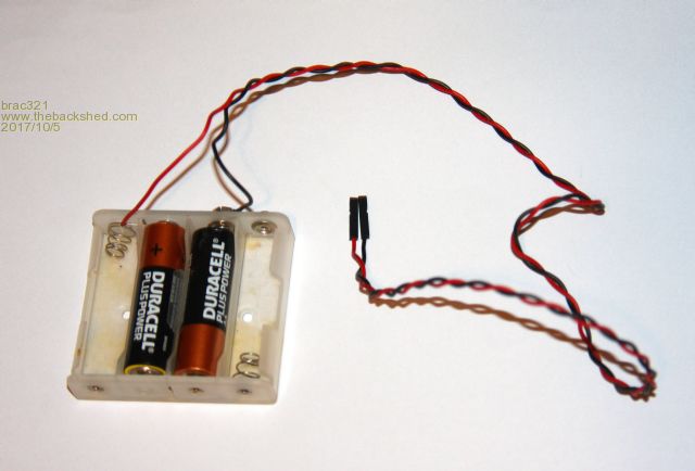

Mad for over current tests w/o load I use two old/exhausted AA batteries, connected where the CT should be, total voltage cca 2,4v.

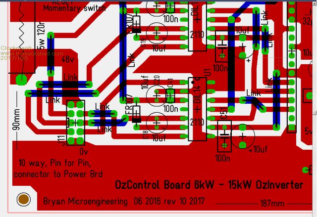

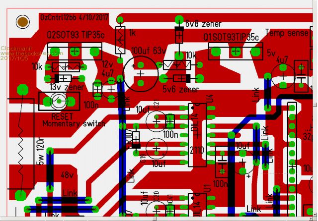

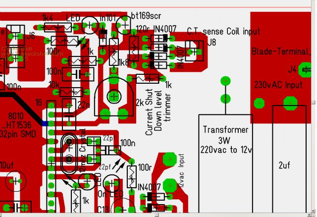

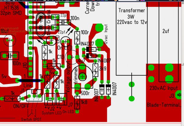

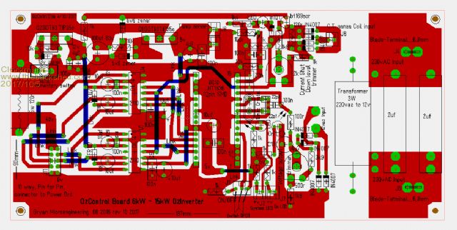

The Latest OzControl Board 12b, Oct 2017.
Still some LINK and writing to add for the DIY PCB makers.
Double sided board with Everything on one side, and LINK tracks on the other, so the DIY folk can add links under or on top.
I have beefed up some tracks for anti-substrate separation when soldering/desoldering components. Nothing worse than desoldering and the blasted PCB solder Pad comes away.
Also allowed more space around board components for different size bits that folk can find.
Although I have not tested this latest board, I will put the Gerber Files on later.

Clockman one suggestion if I may? Draw 230v part of copper more sideways from carrier holes - safer distance... I would minimize these routes, there is no need to be there to the end of PCB and all around. Same for plus pole, supply line from 120E resistor shall be wide enough, but not spilled all around if you don't want to spread unwanted noises from power board.
Very important is ground plane, you have done it good
Sometimes is (when using CPUs, ASCIs, etc) at PCB designing process most important to draw Faradays cage of ground plane all around the board. Doing this will limit internal "noises" to spread at large out and also prevent - limit outside disturbances to take influence on your circuity, like here or here on some of my boards.
Edited by brac321 2017-10-06

Gerber Files, RS-274X format, for the latest OzControl board No12bb.
2017-10-05_132737_OzCntrl12bb.zip
Clockmanfr
Joined: 23/10/2015
Location: France
Posts: 437
Posted: 03:47am 05 Oct 2017
Brac321,
Your comments noted.
This is an evolving project, and robustness and cost effectiveness is a major consideration.
Folk around the World may be only to obtain differing components of differing physical size. So I have allowed this on the board especially at the 230vac input end.
The 2off 2uf large capacitors could be any physical large size, hence the number of holes and spacing. The Transformer 230vac to 12vac could be any physical size from 8w down, again I have allowed space for differing sizes.
The AC copper is left on the board so folk can adapt and add more spade connectors if they wish.
Yes, the DC input end, up around the 5w 120r resistor, could have the tracks thinner and tidier, but again not sure if they might need modifications/additions to them in the Future.
As I have already said, don't want to see substrate separation when soldering and de-soldering large wires, pins, etc.

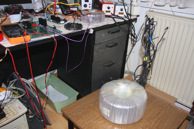

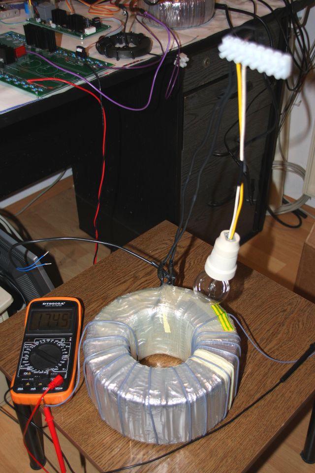

Oztools, today I played almost whole day with my larger trany (Siemens 7,9kVA). Unwinding all its secondaries was quite a task due its weight and wires thickness. It took me some hours to tear down all what's not needed. Now I have "clean" core with 230v part already on (single wire around 5-6mm2). Tranys dimensions now: outer 22,5 cm , inner 10 cm, high 11 cm. I guess I would be able to use 75mm2 or even 100mm2 on.
What do you think, what low voltage would be better choice?
20 turns = 27,8761 V
21 turns = 29,2707 V
P.S. yesterday the smallest one (2,5 kW) was unwound from 32v to 28,3v. Now the output AC voltage is stable from 41v DC input up (on 32v before, from 51,4v DC and up).Edited by brac321 2017-10-09

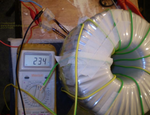

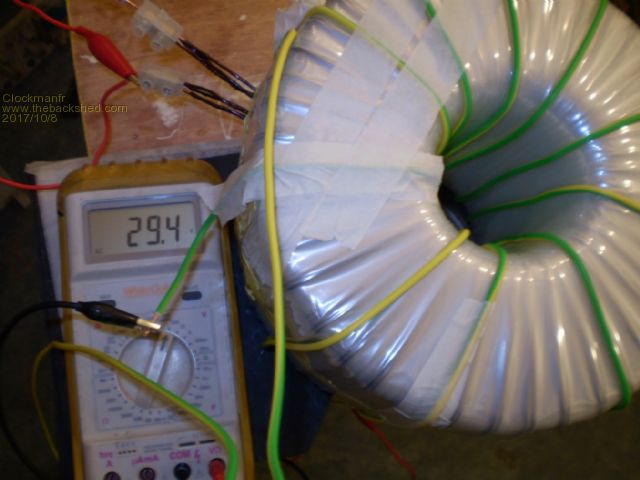

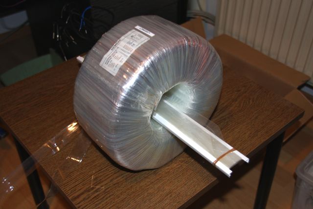

Its in the book.
Its the actual Core size we need to get 'oztules' calculations to correctly work.
Firstly……
"We want the primary to be about 30v to 32v for the PJ style processors, and 28v-30v for the 8010 chips for a nominal 48v system."
Next………. Defining the Core or stacked Cores you are using. Another ‘Oztules ‘ empirical working calculation…….
Example, ...... So a 38kg/83lbs core, at 230mm/9inch OD, 100mm/4inch centre hole and 140mm/5 1/2inch thick/high.
"Lemme see...... I make that as about 9100mmsq cross section... so ... and here I can only go rule of thumb....9000/2800=3.25
So I figure about 3.25 volts per turn. So the secondary will be about 73 turns, and the primary will be about 9 turns.
How that would be worked out mathematically I can only postulate, but the in the real world measurements I have done, it would seem to indicate that roughly 2800mmsq of cross section at 50hz will yield about 1turn/volt.... so 9000mmsq would be about 3.25 volts/turn.
If we wind for a few more volts than we want, our saturation is further away... so say 240 or 260v for a 220v system gives us leeway and lower magnetising current ... from there about 1:8 primary : secondary…. and we have a workable start point.... at least that how I would tackle it. ..... ' Oztules '"
So we go for 80 turns of 6 off, 1.8mm diameter (each approx. 2.5mm/2), secondary and 10 turns of 1 off, 75mm/2 for the primary, basically the magic 8 to 1 ratio.
I am looking for a test 28v - 30v on the Primary when I put 230vac on the secondary, our boards are the 8010 chip processor.
Pics/photos …… shows the toroid test, just using a 2.5mm2 test primary wire. ………… 234vac going in the secondary’s after the step up light bulb process, ……… and 29.4vac reading on the Primary. So we are in the right ballpark.
Edited by Clockmanfr 2017-10-09
