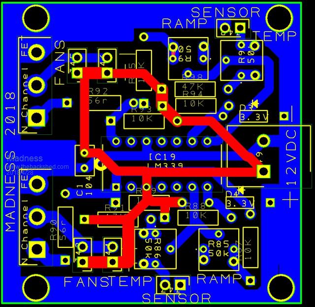

Fan board if anyone is interested it is 50 X 50mm.
