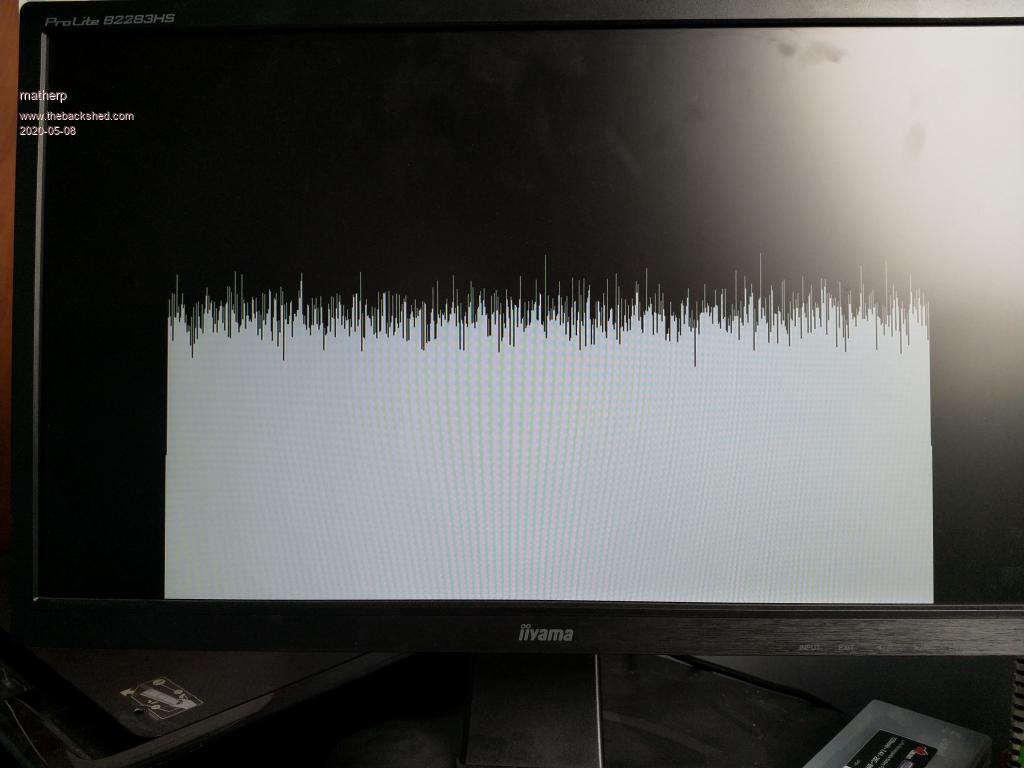

  Quote  I am surprised that there is no facility to seed a random number. It could be useful when trying to get repeatable results for testing (please don't ask for an example right now).
This is really trivial
Try the attached - takes 75 microseconds to run on the CMM2, x is the seed
function pseudo() as float
 static integer x=7
 static integer a=1103515245
 static integer c=12345
 static integer m=2^31
 x=(a * x + c) mod m
 pseudo = x/m
end function
and here is the distribution analysis
Edited 2020-05-08 20:52 by matherp

  Quote   have no idea how or how to use it to generate a series of pseudo random numbers.
Just use it like RND() returns a number between 0 and 1. The sequence is determinate. If you need a different sequence then change the initialisation of X in the function - same as using randomize.
The code is exactly what the C call to rand used in the Micromite firmware is doing. Found it on google and easy to program in Basic
It should run on any Micromite - try it.
My code for the distribution
cls
dim a%(799)
for i%=1 to 800*300
j%=pseudo()*800-0.5 'exactly equivalent to using RND()
a%(j%)=a%(j%)+1
next i%
for i%=0 to 799
line i%,599-a%(i%),i%,599
next i%
do
loop
 static integer x=7
 x=(a * x + c) mod m
 pseudo = x/m
end function

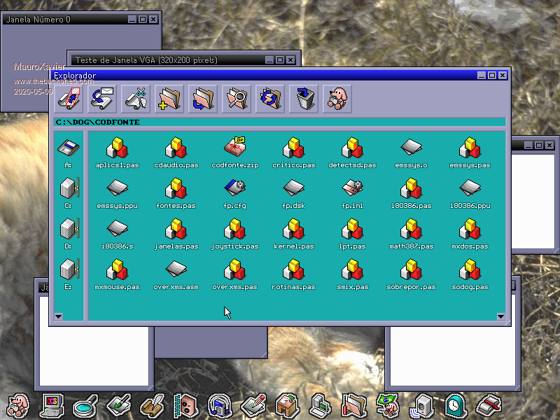

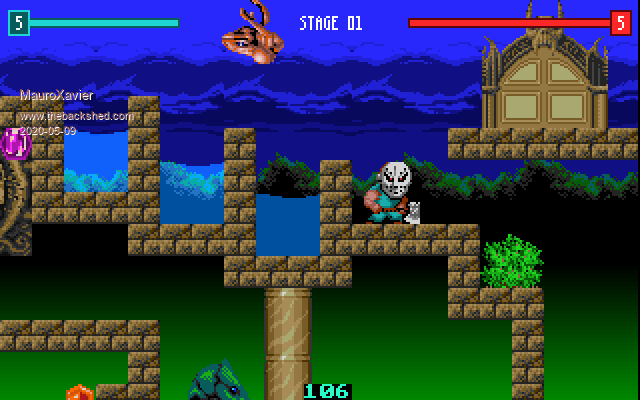

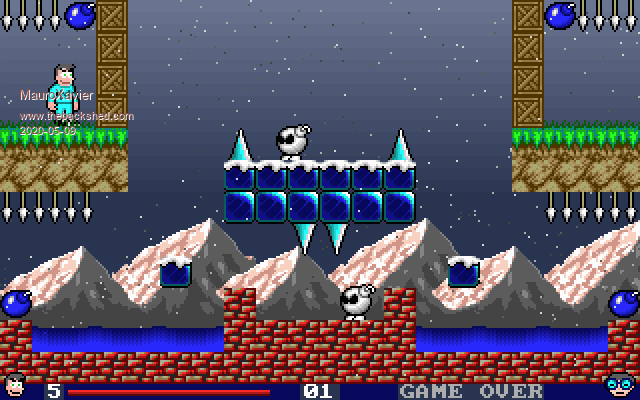

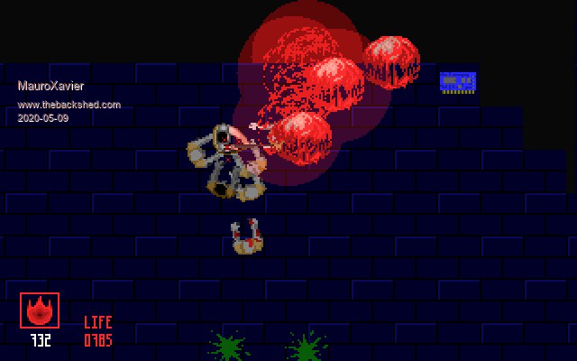

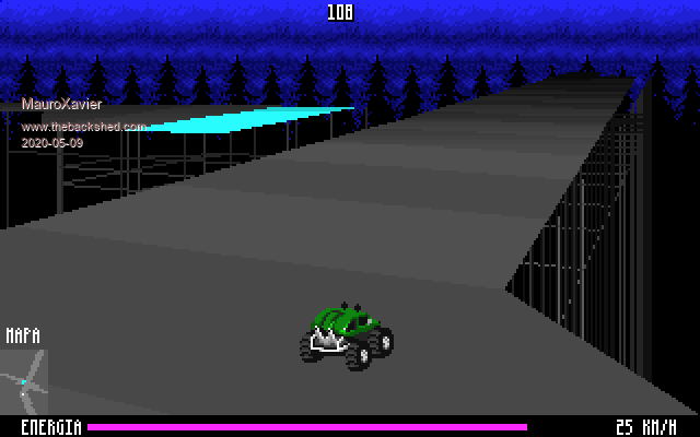

Here are some images of my DOS Games using my "MXMisc" library made in assembly, when I was around 14 years old:
Zombie Arena

Mario DOS

MX Racer
Adventures of Mauro & Nohama
