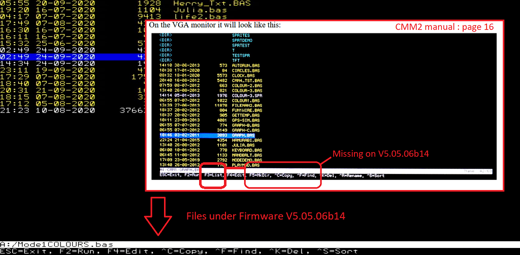

Posted: 02:55pm 24 Sep 2020
Peter ... Many Thanks for this
I was tidying up some .BAK files on my SD Card from last night, with the manual close at hand, and noticed this:
I tested F3=List, F5=MkDir which both worked fine, they are just missing from the display.
^F=Find I think is only applicable to the Edit screen, could not fathom out how this worked in the Files screen.
All of the other commands worked as expected.

Posts: 11980
Posted: 03:07pm 24 Sep 2020
  Quote  ^F=Find I think is only applicable to the Edit screen, could not fathom out how this worked in the Files screen.
finds a filename containing the text you type - very useful for getting to a specific file
  Quote  I tested F3=List, F5=MkDir which both worked fine, they are just missing from the display.
These is an algorithm that decides how much to show on the line but it hasn't kept up with the latest modes
