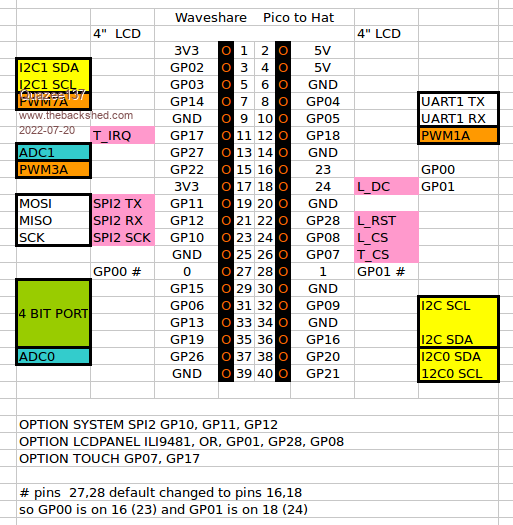

I'm using Picomite 5.070514 with a LCDPANEL ILI9481. It appears that the most recent update has upset the rgb colours.
If I use an RGB value less than 100 there is no effect on the screen, so for example if I do :-
CLS RGB(90,0,0) the screen stays black.
Similarly CLS RGB(90,90,90) etc, as soon as I go above 100 I start to see colour and it appears to be compressed, scaled between ~90-255, rather than 0-255.
I also have a ILI9481IPS and a ILI9341 and these appear to be behaving as expected.
Could you have a look and make sure I'm not going barmy. Also the IPS colour looks a bit washed out, I was expecting the 9481IPS to be better, brighter colours, than the standard 9481, maybe it's just because it's cheap. :-) Thanks.
Regards, Kevin.

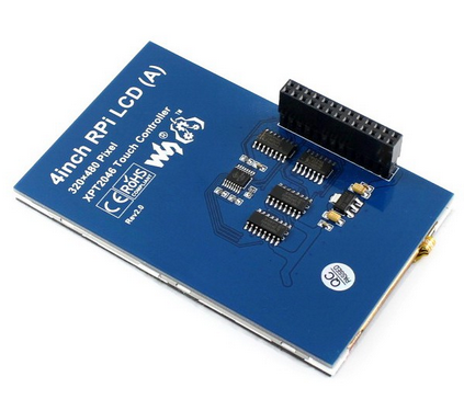

  Quote  I'm using Picomite 5.070514 with a LCDPANEL ILI9481.
Does this precise panel work with a previous release. Is this the Raspberry Pi display with the 26 pin header 13x2?

Posted: 02:18pm 15 Jul 2022
Hi Peter,
Yes it's a Raspberry Pi display with a 26 pin header on the back 2x13 female.
I've gone back to 5.07.04 and it's the same, so presumably it's a problem with my display, I'd never noticed before, with what I was displaying on it, but I re-purposed it and suddenly I noticed all the colours were different from the display I had been using. :-( never mind.

I managed to borrow a second one of these displays (ILI9481 Raspberry Pi display with a 26 pin header on the back 2x13 female) and it's behaving the same as mine?
Any colour set to less than ~90 is almost invisible, you can just detect some change, but it's minute, for example CLS RGB(127,82,0) is hardly visible mud red, I think it should be dimmed orange, it is on other displays I have. If this is a generic display problem, that's fine, it was cheap, then I'll redefine them to offset by 90 and re-scale between 90-255, otherwise could you have a quick look, this is using Picomite 5.07.04 and also 5.07.05.14.

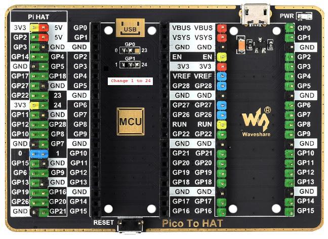

I have been using the ILI9481 Raspberry Pi display on my MM170 hatstands and now
switching over to pico.
Here is a few pic's
I have Peters Clock program running on it.
