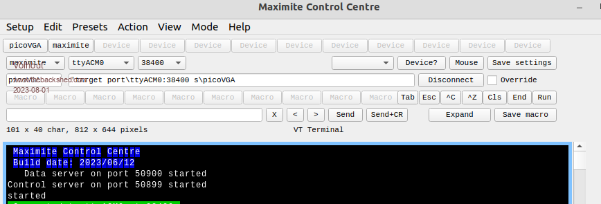

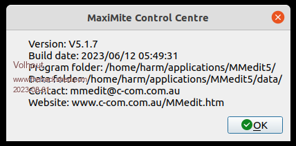

Posted: 05:54pm 31 Jul 2023
Hi Jim,
I stubled already few times over this, and thought, now you are looking at MMEdit and probably also MMCC, you may be able to solve this bug.
This is on the Linux version
I have saved 2 different mites, The picomite VGA, and the Maximite (CMM1).
When I select the picomite VGA from the favourite buttons, in the information field
it says target /dev/ttyACMo s=picomite
But in the buttons above, it is still saying maximite.
And guess, and I have to manually change the maximite in picomite before it works.
This is despite that I saved the correct configuration.
Every time I use the filemanager, I have to manually change it again.
Not sure what causes this.
Posts: 6572
Posted: 09:01pm 31 Jul 2023
I have fixed that in V5.2 which I will be releasing soon.

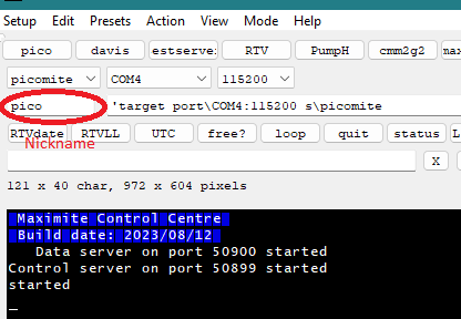

Posted: 12:19am 13 Aug 2023
Hi Jim
A small request please?
With the MMCC's device drop down box, could "cmm2" be changed to "CMM2" or something to make it stand out a bit more (Even put it directly below "maximite").
I sometimes forget about it & select "maximite" & wonder why program uploads fail.
Update
Just been playing with the device Presets & somehow managed to get 3 done (including one for the CMM2) but I can't really work out how to get more presets up. If I click "Save Settings" it seems to overwrite the exiting one. The first couple did ask for a name & populated a button & the drop down list, but unsuccessful after that.
I must be missing something somewhere.
Keep up the good work.
Brian
ChopperP
Posts: 6572
Posted: 02:37am 13 Aug 2023
With presets, you have to give it a nickname which is unique.
If the nickname exists, it will overwrite the old settings.
If the nickname exists and the device specifications box (next to the nickname) is blank, the preset is deleted.
Earlier versions of MMEdit would only update the list and remove deleted item when the program starts.
V5.2 will update the list and buttons immediately.
The first 12 nicknames get a button, any more only get the menu item.
If you want to change the order of the device pulldown, change the MMCC.inf file.
cmm2 is currently Type4. Change it to Type2 and change the old type2 to type4.
The order will sort itself out on next restart/shutdown cycle.
Updates to MMEdit don't normally change inf file settings but V5.2 will change the Device list so any changes you make will be stomped on. I have changed cmm2 to CMM2 for you in V5.2
