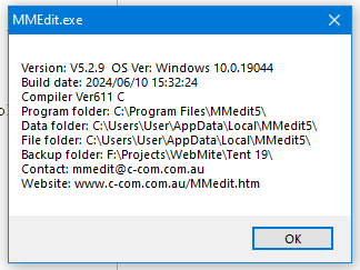

I'm running 5.2.9, and I've had a number of instances (a dozen, maybe?) where MMCC shuts down for seemingly no reason.
Thought I must have 'done something' to cause it, I just started back up and kept going again. Reading your changes, maybe the bug is still there?
An "About" screen grab
None of the above is a deal-breaker, just a heads up for you

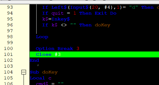

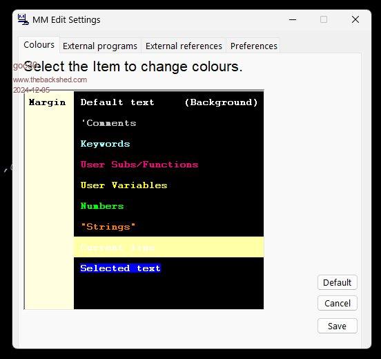

Hi Jim
Just a question:
With your option color, I can change all, its very good
but if I change background with black, and text with White, I cannot change background of current line (selected line is ok), and in this case, I have
text in white and background in yellow. It is impossible to view and edit this line
What can I do ??
thank

I had no problems changing the current line to something darker.
I assume you changed the colours in "Preferences". Just click on the "current line" text and choose your colour.
I hate dark themes so I have not tried to find a suitable combination, but each to his own...

Hi Jim
I couldn't see the "current line" choice because it is written in white on a light yellow background
I'm not a fan of black backgrounds, but given my age and my failing eyesight, I find it more readable and more relaxing.
