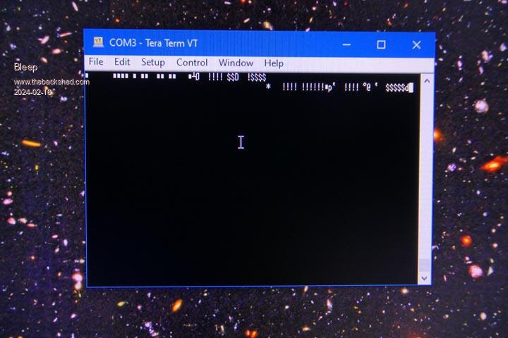

Posted: 04:27pm 15 Feb 2024
Hi Peter,
The board has arrived safely thanks.
I am however completely failing to get the serial console working.
I have enabled COM 2 with :-
Option Serial Console Com2,GP8,GP9

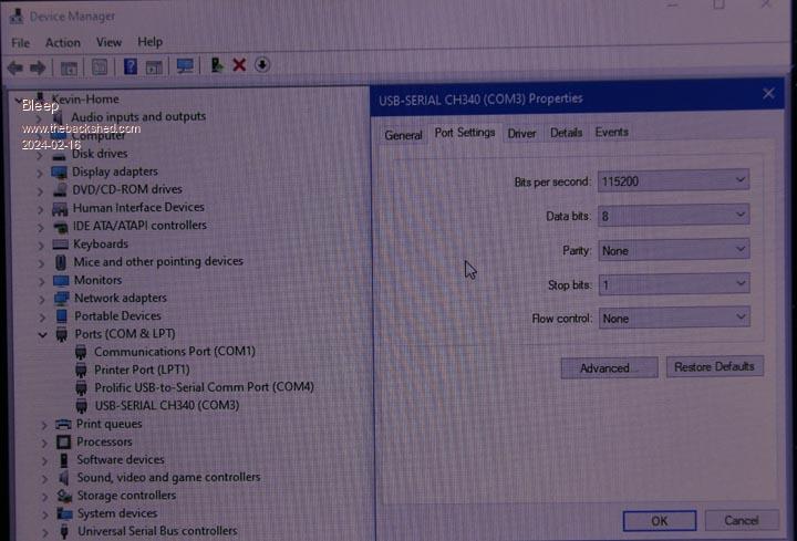

Which has been accepted and is listed in the Options list, however when I connect a USB cable (A-C) to my laptop, I see a USB0 Port appear, but it immediately disappears and I am unable to connect over serial, I have also tried connecting to a PC and I do get a COM3 port, but again I can't seem to connect to it, I get "USB-SERIAL CH340 (COM3)" in Devices, the port reports 9600, Data bits 8, parity None, stop bits 1, flow control none. I am using PuTTY, any ideas as to what I'm doing wrong?
I have now been able to check out the circuit, GP8 & 9 are connected to Pins 2 & 3 of the CH340C, similarly, checked the USB data lines all the way from Pins 5 & 6 all the way to the end of a USB cable, all resistors R31,32,33 are present and correct, R33 is 1M, but drops to 0 Ohm when a USB C plug is inserted, which I'm assuming is correct?
As a sanity test I have installed the non USB version and have been able to connect to the console, using the USB A plug, I have also installed your very latest B1, so I currently have no ideas?
Regards Kevin.
Posts: 12010
Posted: 04:48pm 15 Feb 2024
Kevin
The board was correctly configured and tested when posted and should have worked out of the box. If possible try with teraterm on windows. The serial port is set to 115200.
MAKE SURE THE TERMINAL PROGRAM IS SET TO 115200. It tells the CH340 what baudrate to use on the TTL side over the USB descriptor. This is not the same as a CDC port where the baudrate setting doesn't matter
Start by re-loading the USBVGA firmware and then do OPTION RESET. The console should then be working with no other options set.
Then apply the options as listed. NB: OPTION VGA PINS must be done before OPTION AUDIO

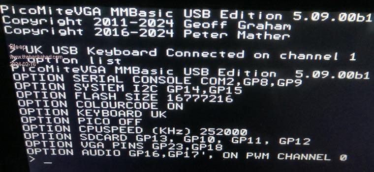

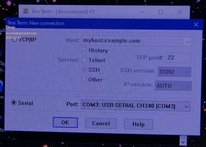

Posted: 05:34pm 15 Feb 2024
Hi Peter,
Current Options.
Device Manager.
Tera Term Start up
Tera Term Window.
The Tera Term Window, stays completely blank if I try to use the PC keyboard to communicate with it. However I then plugged in a USB keyboard in and got the garbage shown, most keys do nothing, the retun key gave me the white squares, the up and down arrow keys gave me the $$$ and !!! etc.
I have also tried a OPTION RESET, and get exactly the same again.
Regards Kevin.
Posts: 12010
Posted: 05:38pm 15 Feb 2024
MAKE SURE THE TERMINAL PROGRAM IS SET TO 115200. It tells the CH340 what baudrate to use on the TTL side over the USB descriptor. This is not the same as a CDC port where the baudrate setting doesn't matter. It overrides the Windows setting
Bleep
Joined: 09/01/2022
Posts: 860
Posted: 05:49pm 15 Feb 2024
Thanks Peter, that's got it working, I'll continue playing now. ;-)
Regards Kevin.
