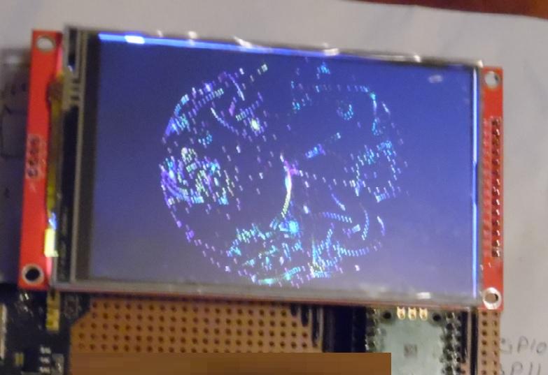

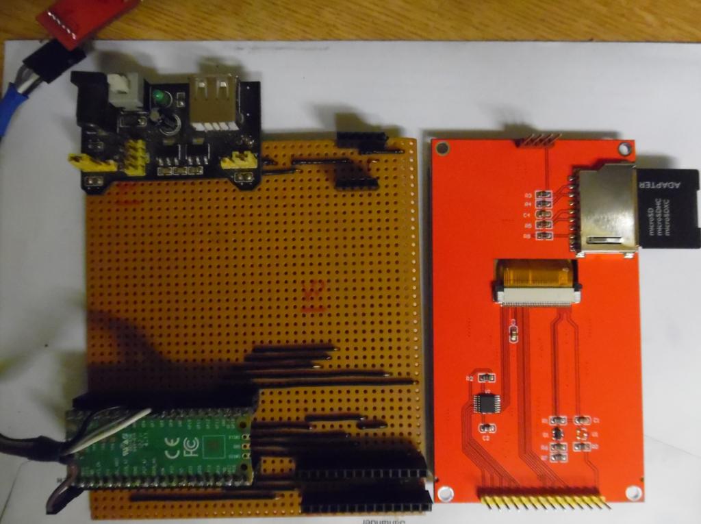

Posts: 2807
Posted: 05:20pm 03 Apr 2024
Hi, the ips ili9488 arrived and it's bigger than the non ips so the 4 pins at the top you got to solder and find your own pins, overlap the board so just bottom row connected, power up autorun bubble universe and
first noticed the cls ,normally don't
second colours "inverted?" ie black background is white
rc3
Posts: 9081
Posted: 05:33pm 03 Apr 2024
The ILI9341 never comes with pins for the SD card. Sounds like that might be the same.
Posts: 11785
Posted: 05:34pm 03 Apr 2024
  Quote  first noticed the cls ,normally don't
Sometimes I don't know why I bother
  Quote  Works nicely, very bright and clear (and cheap), but the colours are inverted. I'll put a switch in the setup command to cater for it.
  Quote  OPTION LCDPANEL anyspidisplay orientation, dcpin, resetpin, cspin [,backlightpin] [,INVERT]
if the new optional parameter "invert" is used the colours are inverted - supports the IPS ILI9488 display
Posts: 2807
Posted: 06:18pm 03 Apr 2024
I don't know why you bother either. maybe you're just nice.
it's all very dynamic keeping up to latest and easy to miss the relevance of some info imho. like why non ils 9488 is not inverted but ils 9488 is when I never set invert?
anyway it'll need a new board and using vero it'll be two boards side by side cos they don't do big vero and it's expensive.
just remembered a post it's ILS ili9488. I'm testing now and invert setting
Edited 2024-04-04 04:24 by stanleyella
Posts: 2807
Posted: 10:30pm 03 Apr 2024
soldered another header for the size of ils 9488 and tight fit but works. brighter than old ili9488 and wider view angle.
had to option reset to get OPTION LCDPANEL ILI9488, LANDSCAPE,GP15,GP14,GP13,,INVERT and retype other options but works
Posts: 2807
Posted: 12:46am 04 Apr 2024
the touch and sd card work. poor photo but pixels seem brighter than old 9488.
a side by side comparison maybe one day but £13 it'll be my non vga device.
glad I squeezed it in to existing 9488 strip board with another header, it's about 1CM longer
