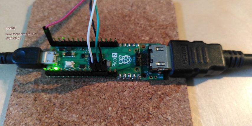

Does anyone know if there is a way of connecting the HDMI to a Display Port monitor, it appears that an active converter is required, unless anyone knows of a way?
Thanks.

Posts: 9328
Posted: 09:23pm 01 Sep 2024
Forget that about the WS2812B. A proper one is working fine. The problem is with these oddball ones. It doesn't matter as long as you know what the problem with them is. :)
Stan:
I have to admit that board is confusing. The silkscreen doesn't tie in with the list of connections that they give you!
There are 8 connections plus ground.
The connections are in pairs: D0+ and D0-, D1+ and D1-, D2+ and D2-, CK+ and CK-.
Each D pair carries a digital stream for a colour. The CK pair carry the clock signal.
They are in pairs because they run at high speed so simple red, green and blue couldn't handle it. There's a lot more information than you have with VGA.
From this point of view it's no worse to connect up than VGA - just a couple of extra pins.
All the signals have a current limiting resistor of around 220R-270R. The breakout modules almost all have them mounted on the module so you don't need to bother about them.
It looks like this to me:
GP12 - 0+
GP13 - 0-
GP14 - TXC+
GP15 - TC-
GP16 - TX2+
GP17 - TX2-
GP18 - 1+
GP19 - 1-
Then the GND pins (you'll probably get away with just one)

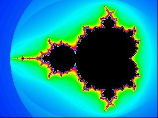

Joined: 08/05/2020
Posts: 385
Posted: 12:50am 02 Sep 2024
Here is the obligatory Mandelbrot in Mode 4.  RP2350 HDMI
-Carl

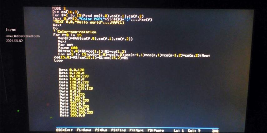

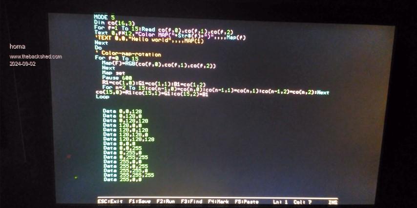

homa
Joined: 05/11/2021
Posts: 757
Posted: 09:56am 02 Sep 2024
Hi Peter,
there is still a small bug with the MAP test program. If it is run in mode 3 (works) and then aborted with Ctrl+C, the system colors are no longer correct. Especially in the editor.
On the other hand it works fine in mode 1 and 5 and the system colors are restored there as well.
Anyone else having problems with XMODEM? I cannot send files to the Pico2 (b3). The transfer starts and then freezes ...
it works in the other direction.
Matthias
Edited 2024-09-02 19:59 by homa
Posts: 12176
Posted: 10:10am 02 Sep 2024
This one is a no-win.
If I reset the colour palette after ctrl-C then it is a pain when testing a program that uses it. If I don't then you get the effect you see.
Use MAP RESET to reset the colours before entering the editor in mode 3.
In modes 2 ,4, and 5 the editor automatically switches to mode 1 for editing to get the 640x480 resolution but this is then restricted to font 1 to match the tile size in order to get colour coding
Mode 3 is already 640x480x16colour and therefore colour coding is available with any font.
A compromise would be to just reset the palettes when entering the editor but leave them after ctrl-C at the command line leaving it up to the user to issue the MAP RESET if they wish
