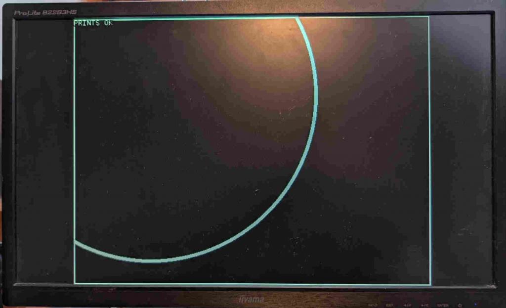

Posted: 11:16am 10 Oct 2024
Peter,
I am closer to catch problem.
I completely flash - erased pico rp2040.
Loaded firmware again.
Now, to my surprise (!) it drew lines as it should.
Good. Entered manually OPTIONS according to my system. Still drew lines OK.
Loaded large enough program ~30k
RUN and there it is. Black zone in upper part while trying to use LINE or CIRCLE inside that program.
OK. I do EXIT, trying to draw from command line -> LINE or CIRCLE comands .. and... old good problem. 12 pixels at top are lost.
ok. Power cycle off/on
Draw circle 100,100,200 . Draws ok
Load that bigger program again, tray to run - FAILS.
And while it fails draw CIRCLE or LINE, PRINT @(0,0) "something" prints OK no matter from program or command line
If you would try replicate problem loading bigger program and order to draw at the wery begining of program and see can you replicate this?
This is what I add at top of that larger program. (I don`t believe anything what is loaded, but not running in progam below these lines , can call this effect somehow ? )
Line  1,1,640,1,1
Line 1,480,640,480,1
Line 1,1,1,480,1
Line 640,1,640,480,1
circle 140,140,300,5
print@(0,0) "PRINTS OK"

Posts: 12112
Posted: 11:50am 10 Oct 2024
When you have the black lines please try TILE RESET and let me know what happens

Posts: 12112
Posted: 03:05pm 10 Oct 2024
  Quote  Sent PM video recorded how i see it.
The program you sent me looks completely different
However, looking at your video I am almost certain that somehow your program is somehow setting the foreground tile colour to black for parts of the top line. It isn't anything to do with monitors or video timing so don't replace the monitor

Posted: 05:25pm 10 Oct 2024
Peter,
Yes.
Added on top of drawing commands:
TILE RESET
TILE  HEIGHT 480
And lines printed!
Comented out TILE RESET and lines are printed.
Comented out TILE HEIGHT and problem came back!
UPDATE:
It does not have effect until TILE HEIGHT 12
TILE HEIGHT 13 already does work
Edited 2024-10-11 03:28 by electricat
