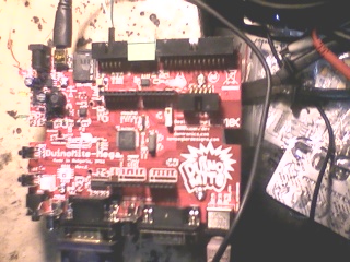

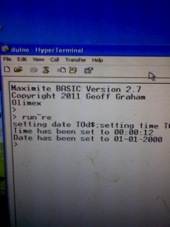

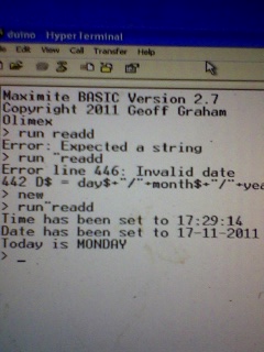

ok i have the time clock connected but i am getting an error on the read the write is fine it may be the program i am using as i have many ...but it is seeing it on pins 5 and 6 of the U=ext on the rear hedder...///...///but i am having trouble with the read program "matt what was error on line 446 ..invalid date " what was the fix for that i cant rember and i will have to go digging i think i need a different read code....here`s a pic...///

Posted: 03:33am 17 Nov 2011
When I was getting this error it was because the jumper was NOT set to BAT, so each time you rebooted the RTC went back to not knowing the date/time string. As soon as I changed the jumper to BAT, booted, set the Date$ & Time$ and then ran the clock set program, from then on it worked just fine.

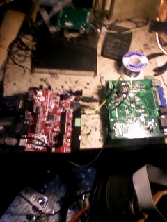

thanks for that info but i am if you look at the hardware pic two boaeds one you prolly have not seen and the other is a blown up SM1 board but i have isolated the "rtc" part of the cct and i am running the two rtc signal wires to my dynamite mega have a close look at the picture ...///...///

Posted: 05:32am 17 Nov 2011
i am still to master the "rtc" but i think it might be down too component level ..now i will have to get the meter on it it seems that i may have an open diode or maybe a short some where...back to the drawing board although it does return a value of "zero" meaning only one thing ..the wires to "U-ext " must be correct......

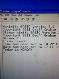

check this out trend setters.and gurus.....given the fact that the day is in correct but look at "the time and date" theres the ..."RTC working on dynamite"
and the rtc is on a SM1 board...jumperd via "U-EXT "at the rear

thanks don cheers check this out ....got the "RTC" happening i mean its just a add on its just getting it correct ...any way heres a pic for ya funny what this board sometimes throws out at start up.....have a close look .....

  sparkey said   thanks don cheers check this out ....got the "RTC" happening i mean its just a add on its just getting it correct ...any way heres a pic for ya funny what this board sometimes throws out at start up.....have a close look .....
Yes, it only happens on the terminal, not VGA, but Ken is aware, and is fixing it in the next update.
Now you have to get the day correct.
