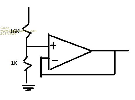

I am not over confident the cells divided by bank voltage idea would do much either, but the logic seems sound, and I think it is worth a try.
Warpspeed wants to measure voltage, but it has nothing to do with function other then data knowledge.
This doesn't measure any difference between cells as a concept, it just acts on each with an average of the bank. But it also averages variations. There would not seem to be any thermal issues with this approach.
Things working as intended, you would not damage cells.
So we have a balance reference 1/17th, or bank voltage divided by cells which is following any changes.
A cell is connected, it is either lower and takes additional charge, or higher and clipped to the new equilibrium, which is something between the bank division and cells series supply. The cell equal with the bank division remain unaffected.

Gazz
Joined: 22/03/2017
Posts: 20
Posted: 07:28am 24 Mar 2017
  Tinker said
Gazz, I read your posts from end to end and my head is spinning now. I'm afraid I'm too old to cope with so many questions in a row. Besides, other than balancing your cells I do not know what you are trying to do, you tend to lose me with frequent thought diversions. Sorry.
Hello Klaus,
"frequent thought diversions"? I'm no spring chicken either, but we try.
People are going to use and charge cells in many ways, often different to you or me.
The usable charge and discharge voltage for the same cells from different Manufactures is all over the shop, so don't worry about the numbers. It is just an example.
Lets say you have 8x 200Ah cells.
EG: Charge Voltage = 24v (3v per cell)
The voltage across bank will change a little with charging time and increased capacity.
Some Cells will be slightly higher and some lower.
To balance 8 cells you can connect them in parallel.
Lets say we have 2 cells:
One is 3v, the other is 3.2v.
Connect the two cells in parallel they are both about 3.1v
Not done any complex electronics in over 40years.
I am asking: if anybody wants to help with component choice and circuit design.
We start by connecting a simple 2 resister "voltage divider" across the bank.
The voltage between resistors = bank voltage divided by cells as below.
Shown are (16KΩ + 1KΩ) resistor values for a 17 cell Bank.
You see here the voltage divider is connected to a (Opp Amp) voltage follower.
A Voltage Follower replicates the voltage on its input to its output.
I need a voltage follower capable of at least 1 amp.
I have been looking for a power supply that can replicate a reference voltage.
Hope there is someone in forum who can offer suggestions.
Cheers.
Add: I have options for commercial solutions, but there is always room for a better mouse trap.
Just depends on the interest.
Edited by Gazz 2017-03-25
