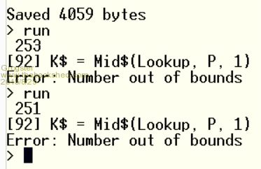

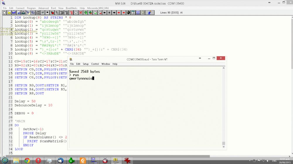

RESULT:
This result is from typing QWERTYUIOP
CURRENT CODE:

This should make qwertyuio work. The location of the P i can not deduct because it is displayed differently. (Probably teraterm character set)

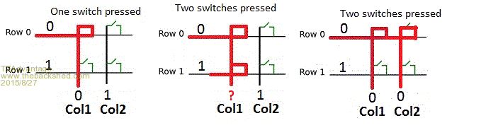

Pardon my skills with paint but here is what happens:
As you can see one key is no problem, two keys on different rows is.
Last picture two keys on the same row is also not a problem.
The only way in hardware for Row1 to not short with Row2 is to add a diode.
In software you can however switch all rows except the one you are scanning to an input. Then there is only one output on the whole matrix and everything else is an input (rows and columns). You read only the column so having the rows as an input does not really matter for decoding.
You don't want the smoke to get out. Edited by TZAdvantage 2015-08-28

Posted: 11:27am 28 Aug 2015

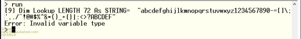

I think there is a bug in MM Basic.
Try a space between STRING and =
DIM Lookup LENGTH 72 AS STRING = "abcdefghijlkmnopqrstuvwxyz1234567890-=[]\;',./~!@#$%^&*()_+{}|:<>?ABCDEF"
Posts: 10062
Posted: 04:36pm 28 Aug 2015
Yes, when I try that, the code does progress much further to this point:
MicroBlocks
Joined: 12/05/2012
Location: Thailand
Posts: 2209
Posted: 04:42pm 28 Aug 2015

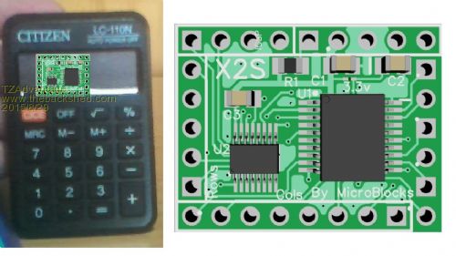

The reason i went with the PIC16F1459is that i want to make an as small as possible generic Matrix to Serial module you can see in the picture.
I have overlayed it on the picture to get a feel for the size.
By being this small it should fit in most keypads and it will use only one of the precious mcu pins. With a micromite it can then even be used as a noraml keyboard so that programming will be very easy using normal inkey$ and inputstatements. Allowing you to fully test the program with Teraterm first.
This module is one of the hopefully many i have planned for my long overdue 'MicroBlocks'. I had to think about a whole new concept to use these modules as the market is floodedwith 'modules' and i think i have found a nice niche. More on that later. Goes by the "BBM Series" codename. (Each product should have a codename )
MicroBlocks
Joined: 12/05/2012
Location: Thailand
Posts: 2209
Posted: 04:44pm 28 Aug 2015
G, I will check the code for that error.
Ok. Found it.
Change
[code]
'Decode the ScanCode
if ScanCode <> 255 then
[/code]
to
[code]
if DEBUG = 1 then PRINT RowNumber;
if RowNumber >= 0 and ScanCode <> 255 then
[/code]
Edited by TZAdvantage 2015-08-30
Posts: 6624
Posted: 04:54pm 28 Aug 2015
  Grogster said   Yes, when I try that, the code does progress much further to this point:
That error suggests that 'P" is negative or zero.
FOR P = 1 TO 74
k$= MID$(Lookup, P, 1)
PRINT P," *",k$,"*"
NEXT P
P=0
PRINT P," *",k$,"*"
I don't have a keyboard to play with.

  TZAdvantage said   The reason i went with the PIC16F1459is that i want to make an as small as possible generic Matrix to Serial module you can see in the picture.
Wow, that is small TZ, less than an inch across, (oops, < 2.54mm). If you can get this flying there should be plenty of takers - the biggest problem will be fitting a socket for it - the cable that is.
GregEdited by paceman 2015-08-30
