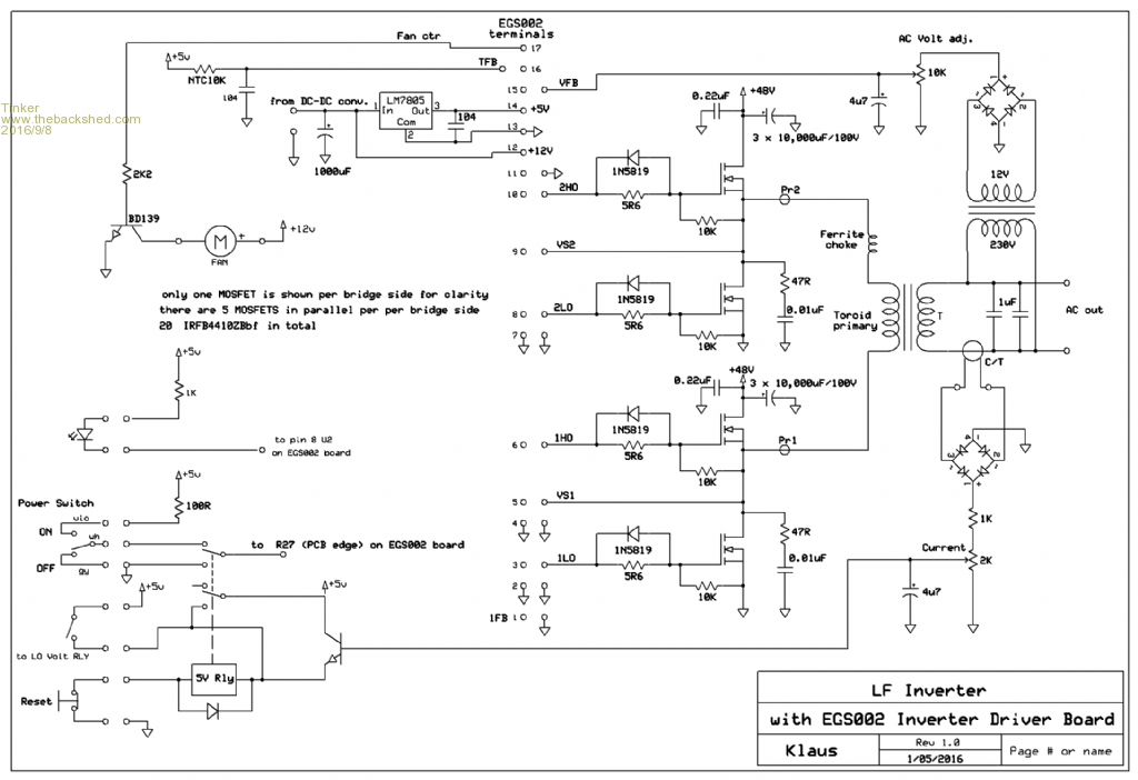

Posted: 11:45pm 07 Sep 2016
oztules, this is getting waaay too complicated .
So I decided to take your advise about the worrysome IFB pin and try another way to shut the thing down if there is an overload.
What does one usually do if the fuse (or CB) blows? One goes and finds out what caused it, remedy and then replace the fuse (reset CB).
This is what I'm going to do. No automatic soft restart for me, its just too risky IMO.
Here is my updated circuit:
Please let me know what you think of this idea. The relay, BTW, is already on my board for remote shut down if the lithium BMS detects a low cell voltage. All I had to do is to use the spare contacts on the relay and add a transistor to drive it.
I should be able to precisely set the trip point.
But I have not built this thing yet.

Posted: 01:11am 08 Sep 2016
I for one, like the relay idea, but the SCR would also work I guess.
I think that perhaps disabling the IFB pin totally, and using the temperature shut-down as our overload method is best, as there seems to be some conduction paths left in play with the power MOSFETS even when IFB has been tripped, yes?
I too much prefer a manual reset kind of approach to an overload condition, rather then have the 8010 try to restart the load over and over, which would seem to have been responsible for some MOSFET deaths, if Oz is to be believed. (and he is!)
Personally, I like your latching relay idea with the NC push-button or switch that you have to open to release the relay. It means that you have to go to the inverter unit and clear the problem before you can make any restart attempts. That can really help to save the lives of the MOSFETS I would think.

Posted: 01:46am 08 Sep 2016
  Grogster said   I for one, like the relay idea, but the SCR would also work I guess.
Thanks Grogster.
If you look closely at my drawing above you will see that I connected the IFB pin (1) to ground.
That is what the EG8010 datasheet suggests if the current overload function is not required.
I assume this will sort any problems here.

Posted: 11:18am 08 Sep 2016
Relay looks good and simple, but for serious o/load?
It's reaction time is in tenths or hundredths of a second.... a whole world of pain can have happened by then..... and it won't be the relay doing the turning off I suspect.
It won't even protect from avalanche of the fets once they start to blow, and the main fuse is still active
Solid state relay ... not sure if they are fast enough either.
No I figure a one cent component will be the fastest and simplest .... scr and reset momentary switch. Identical effect but thousands (millions?)of times faster.
It remains to be seen how fast the temp pin is polled compared to the Ifb pin or the inhibit pin of the drivers even. Drivers may be the fastest... but would have to make sure the temp or the current or the inhibit pins was retriggered on reset for soft start... probably high speed diode isolation would do to both pins.
The driver reset may be the fastest key, and the SCR will be the thing that stops restart of any kind. Once on it can't be turned off without total loss of current in the A-K circuit.
Comments?

Posted: 12:23am 11 Sep 2016
OK, an update to that circuit I posted on the previous page.
There it was pointed out to me that a relay may not switch fast enough to prevent component failure with a short circuit event.
It is actually quite simple to add a SCR for the over current shut down.
So, for those who use the EGS002 board this should do the trick (unless somebody finds a problem with this circuit).
What I do not get, as suggested in another thread, is why one would use the temperature (TFB) pin of the EG8010 to turn the driver on and off when there is a dedicated pin (SPWMEN, pin 6) for that function.
Posts: 10096
Posted: 12:47am 11 Sep 2016
As far as I can see, the only reason for using the TFB pin, is that it is easier to pull that high with the cathode of the SCR along with the SD pins of the 2110 drivers, then it is to pull the SPWMEN pin LOW when the cathode of the SCR goes high.
It is very easy to do with the help of an additional transistor - the transistor pulls SPWMEN low when the SCR turns on(the transistor base is fed from the SCR), but this requires the extra parts to do it. I expect that would also be a fine way to do it.
The TFB pin is just the easier approach to achieve the same result, and you also get the 8010 to blink the LED as an attention getter for the error condition too, so I still like that idea.
When the SCR trips, the 2110 drivers will shut down the power board within 140ns maximum, so that is pretty damn quick, and technically speaking, you could leave the 8010 running as normal, cos you have disabled the 2110 drivers, but having said that, multiple shutdown schemes are a good thing with the currents flowing around the power board.....
oztules
Joined: 26/07/2007
Posts: 1686
Posted: 01:40am 11 Sep 2016
Klouse,.... what Grogster said...... and whimpy disposition.
Me and pin 6 have have history.... and we don't see eye to eye.
I have had trouble with noise in that circuit, and I fail to see why. I used it for turn on and off... and even down at 5k and less impedances, it is prone to misfire and noise.... so I am scared off.
That and the natural current shut down on the 002 boards leads to consistent blow ups with torroids.
IFB is too slow, and adds at least another 600us... too long for torroids on the loose.
TFB is a known never fail turn off and ramp up on, I have never had any quarrel with it's antics... so it is a safety blanket for me.... that and a high signal will trigger the 2110 and the 8010.
I am no longer interested in how the 8010 shuts down, as I currently think it is best done with the 2110, BUT and a big BUT... we need to have a soft start on reset, or peel the fets off the wall.... and temp does that every time, pin 6 and IFB have been known to retrigger if the hold signal is iffy or not held long enough, leading to oscillation and destruction. I have had fibrillation with less than an 1R to +5v and 15k to ground, and still fluffy.
So I am a sook... and decided to go this way... and feel my way from there.
However, when someone else pokes a screw driver into the outputs, and pin 6 saves them consistently... I'll be a believer.
.... oztules
