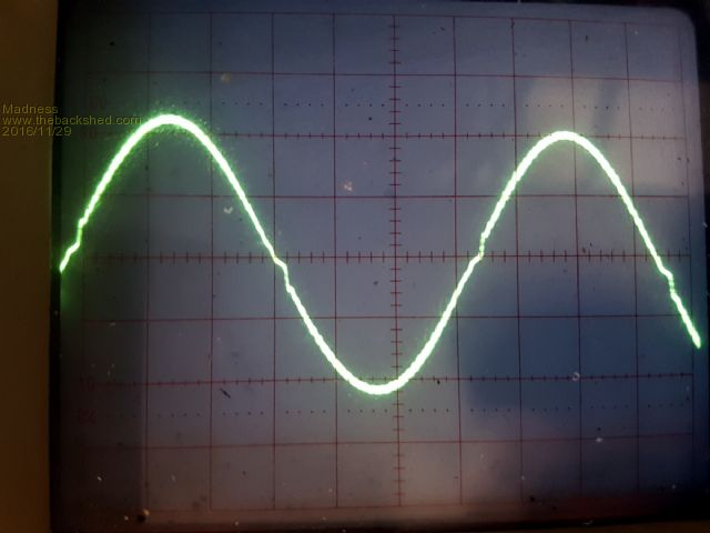

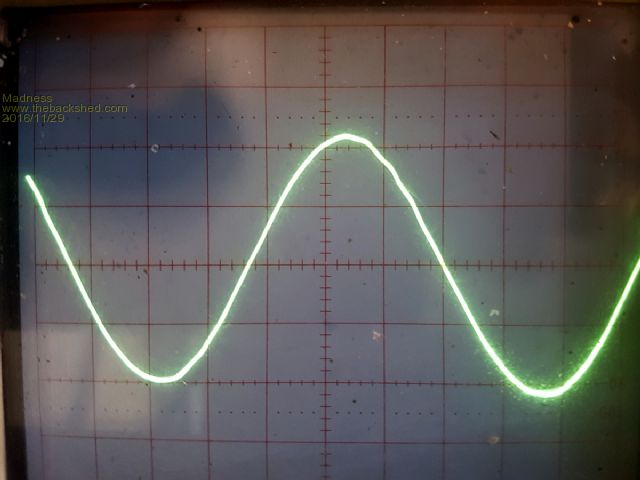

Madness
Joined: 08/10/2011
Posts: 2498
Posted: 10:14pm 28 Nov 2016

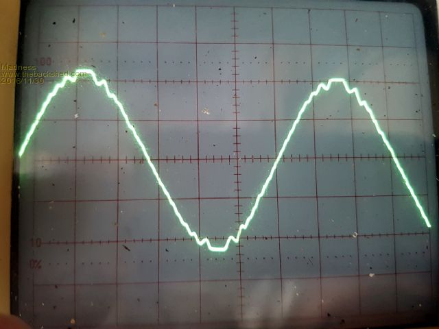

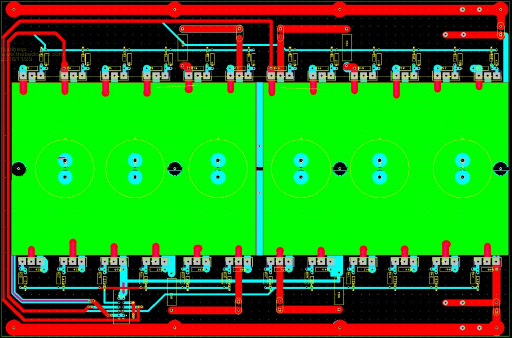

After etching a new PCB with all tracks and pads connected to the gate drives reduced to 2mm wide I have got this. 300ns dead time, slightly lower idle current and runs very quite.
No load
9.5A fan heater
Before would have had sharp spikes around 0 crossing.
Hopefully, the curse is lifted, been nearly 6 months since I started this.

It is definitely very different, this latest PCB has TO220 MOSFETs. It is not the MOSFETs that are different as I have another board with same MOSFETs with previous design and it had the same nasty spikes at zero crossing. Now I am doing a further redesign to get gate resistors and diodes as close to the gate as practical. I can get it about 3mm closer, doesn't sound like much but the changes already made so far have had a dramatic effect. The fuzzy wave is about half the width now also. I am assuming less copper and not having tracks on both side is making the FETs turn on or off faster (or both). It is like it has a changed personality before it sounded angry, now it is quite and calm with just the slightest noise in the choke that was buzzing loud enough to be heard 10M away before.

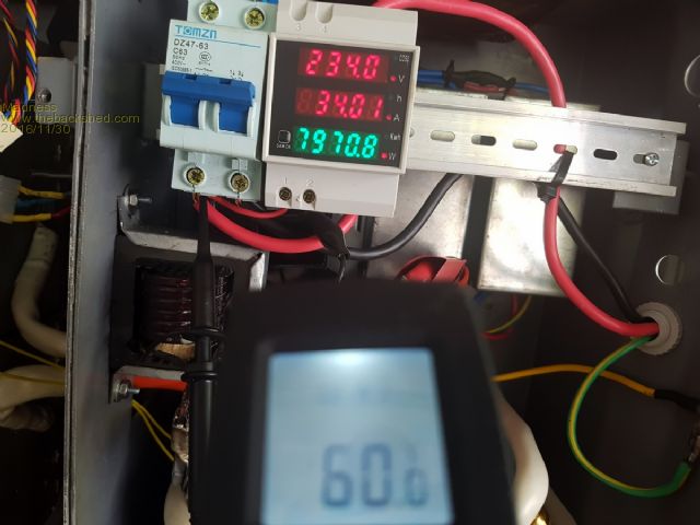

Madness
Joined: 08/10/2011
Posts: 2498
Posted: 07:58pm 29 Nov 2016
The Inverter is now connected to the house for about 8 hours now. Did a load of washing in the Front Load washing machine and had HW on for about 30 minutes this morning, it ran for about 30 at 6 KW then. I gave it another workout this afternoon another 30 minutes with 34 degrees ambient, heatsinks got up to 48 and toroid is shown below.
Bottom of Toroid was much cooler where the fan is directly on it, I have a couple smaller fans that I will mount above it blowing air on the top from inside the case.

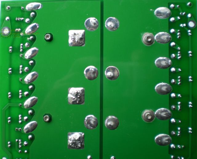

Clockmanfr
Joined: 23/10/2015
Location: France
Posts: 437
Posted: 09:50pm 29 Nov 2016
Yes. that board looks better.

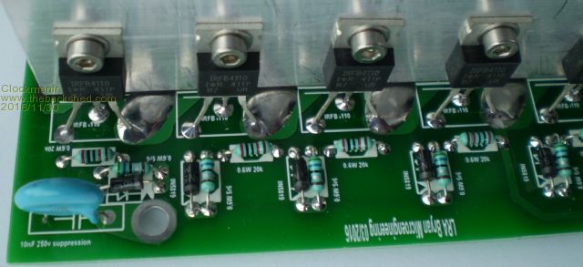

Although the FET legs look a little close together for me. On mine I have opened the legs so the solder pad is bigger and the space between the legs is wider. But to wide and the FET legs are fractured.
Why? because my installs are in a damp/moisture environment. Its amazing what humidity can do.
I trust these 2 pics help.?
Fingers still crossed.

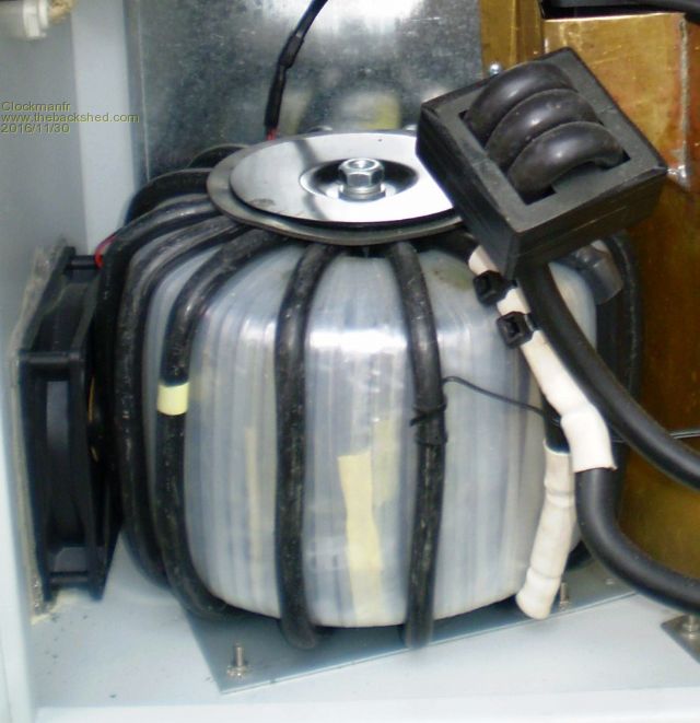

I like Oztules original toroid design with the big single primary. This arrangement allows a gap, 12mm to 14mm for the air to flow through the centre of the toroid.
Some consideration is required with the OzInverter regards air cooling, hot air rises, well it does here, so I have my base and top panel ventilated for natural air flow.
I also have 2off 120mm dia fans in a push pull arrangement on the toroid, and 2off for the PCB boards. I doubled up on the OzCooling circuit so toroid and PCB's can be independently cooled depending on their needs.
Here, the push fan is mounted on the side, but you can see the air gap between the primary cable and toroid secondary wrap, and a nice breeze is flowing up the centre of the toroid. That's one of the toroid two heat sensor probes that you can see at the front, just cable tied to the primary against the secondary wrap.
Madness
Joined: 08/10/2011
Posts: 2498
Posted: 10:41pm 29 Nov 2016

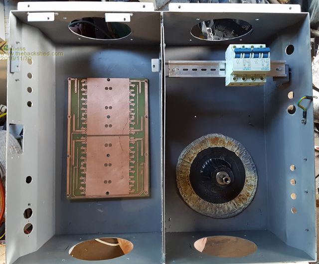

My Toroid is virtually the same as your photo with 70mm square welding cable (90 would fit too), also 140 mm fans above and below, air can flow naturally I have had it running above 3 KW for extended periods and the temperatures did not get over 40 without fans. I don't think 60 degrees is anywhere near where there would be a problem. It was 34 degrees ambient when I took those photo's.
PCB is designed for TO247 MOSFETs which don't have flexible legs, the case sits only 3 mm from the PCB.
Here is the case before being fitted out.

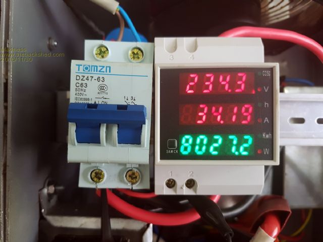

Guarded optimism is creeping in..... over 8kw, and 6kw for extended periods....
You may be onto something now.
I fully expect it to just run now... without problems. Looking like I had a dream run with layouts.... very lucky maybe.
