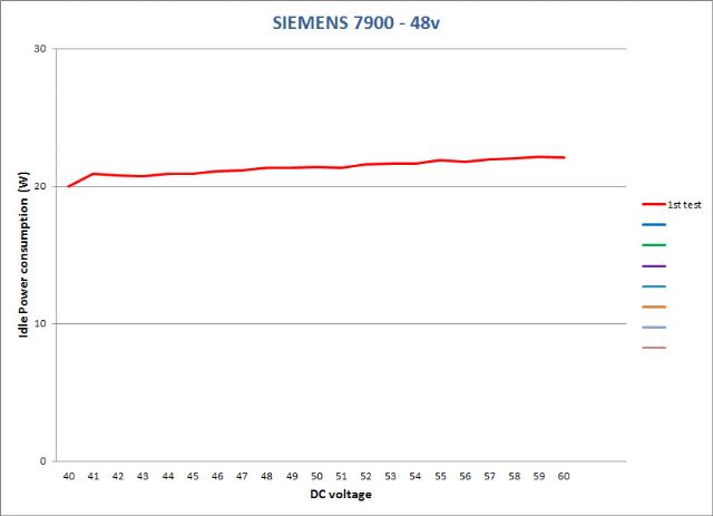

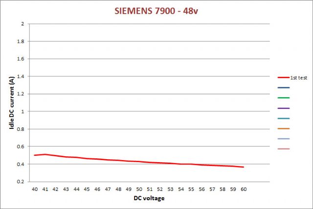

Posted: 06:37pm 08 Oct 2017
Idle power of Siemens 7k9 trany
OffGrid 24/7: 250w black mono solar panels 6.4kWp, 1x Midnite Classic 150, 1x MorningStar MPPT 60, battery bank 840 Ah @ 48v, modified LF-8K inverter, DC/DC, hot water harvesting, etc.
Posted: 06:41pm 08 Oct 2017
That is outstanding considering the potential power output capability.

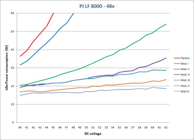

Its always difficult for me when folk say, "I have this ready wound toroid of 7.6kva rating".
After seeing what the PJ claim there toroid's will do against there real claims, and what some manufacturers rating claims, and what 'Warpspeed' mentioned about manufacturers of toroid's cutting everything to the bone/minimal, I am therefore very sceptical of any so called prewound toroid ratings.
'oztules' took the time to coat each secondary winding with epoxy before putting the next mylar/insulation wrapping on.
Like 'oztules' I also want a long life Inverter, and seeing and hearing about old toroid's that have shorted out on there windings, makes me realise that the thin epoxy coating locks those secondary windings, and stops that buzzing/vibrations and ultimately stops that interior toroid fail.

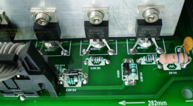

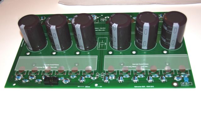

Power board / Ferrite Beads on low side of FET bridge, shall we install them?
Some Chinese boards use them on FET's Drain. I guess they are useless there (inside short death loop). Heat sink and back side of FET's are already on same potential as each tiny Drain pin that after going through the Bead ends on same plane.
It could of some importance on microwave frequencies, but here on extremely low frq. ... don't know.
Any idea?

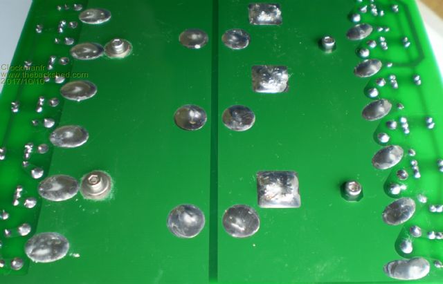

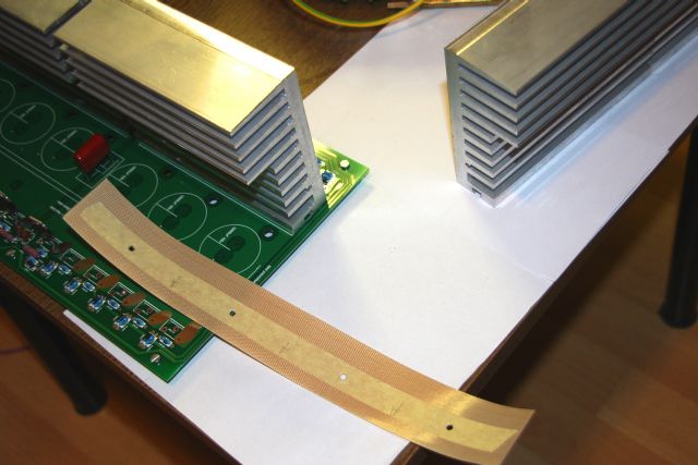

Clockman, have you removed (scratched down) Stop-mask under both low side heat sinks? Because of high currents and connection to the Source of FET's at High side, the complete current will flow only trough tiny legs at Low side FET's. In my view it is not the best idea to have isolation there. Both small heat sinks shall be mounted with the best contact to PCB copper under. What do you think?
Edited by brac321 2017-10-10
Posted: 09:34am 09 Oct 2017
I have never used ferrite beads with mosfets in power circuits, only suitable place seems to be in the gate lead. But there should be a low value series gate resistor in there somewhere, which should be all that is required to damp out any ringing.
What will function fine, and what might be needed to pass a formal EMC emissions test are two very different things. Fitting ferrite beads can be a quick low cost solution if something almost passes, and a particular component is generating a ringing waveform that radiates RF. Slip on a bead, and the problem goes away. Some nasty spur on a spectrum analyzer shrinks below the fail line. So you sometimes see small ferrite beads fitted in some mighty strange places.
Ferrite chokes in series with the transformer primary were in fashion here a while back, and definitely reduced idling power. I suspect it reduced mosfet turn on switching loss by slowing down the rate of initial current rise when switching into a highly capacitive load caused mostly by the transformer self capacitance.
These ferrite chokes would quickly saturate above idling power, but proved to be very effective at lowering idling power level.
A much better approach to all this would be a serious steel cored non saturating choke with large air gap, in series with the transformer primary.
That turns the PWM side of the bridge into something that looks like a buck regulator, and in combination with the transformer self capacitance turns our PWM into a nice sine wave.
Transformer self resonance is typically at only a few Khz, well below our PWM switching frequency. At 20Khz (well above resonance) the transformer looks very strongly capacitive.
In fact on some of the waveforms pictured in various threads here, you can actually see a faint low amplitude ripple superimposed on top of the 50Hz of perhaps one or two percent amplitude that appears to be in the low Khz range. Its nothing to worry about, but its an interesting phenomena.
A second advantage of having a big steel non saturating choke, is that it slows down the rate of rise of any fault current, at least until the choke saturates. That slow down and delay in rate of current rise gives any overload shut down system at least a fighting chance.
Some of the commercial grid tie inverters use a choke large enough not to saturate at about roughly twice the peak full load running current. That is probably a fairly safe and reasonable objective. With a multi Kw inverter, that choke is going to be pretty huge, but still I think well worth having.Edited by Warpspeed 2017-10-10

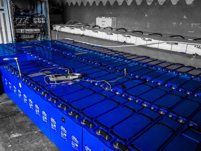

Yes Tony, I was thinking too about choke saturation and how to enlarge ferrite ring cross section (one I use) not to saturate too early. But after measuring and calculating inverter efficiency at various loads, was quite surprised how well it perform even at higher loads. So I left PJ LF as it is after all modifications. It powers my complete home, both buildings 24/7 - it was my most powerfull inverter.
But now I have few pwr boards for Ozinverter, so plenty of room to play with
Two friends of mine, one in Slovenia, another in neighboring Austria have got huge factory made 35kW 3f inverters, 2nd hand. But both suffers of (too) high idle current. So they are looking now for 10-15kW ones.
Here is one in Austria - rack in upper left corner

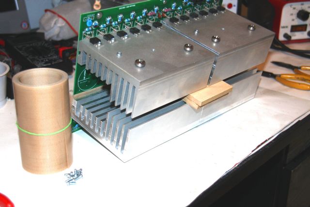

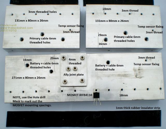

Oztules and I discussed the Power board connections back in 2015. In conclusion it would help, but the present board design is very capable.
I still ask that you insulate the heatsinks from the top tracks as just a slither of copper being pushed through the varnish coating and shorting out on the top tracks could mean disaster!.
I think you have 2 of my early Power boards, the ones that Oztules tested to the ultimate, and a more recent design.
Both designs of the Power board are fundamentally the same except for re-positioning of text/silk screen and the modification to the Battery + 48vdc long heatsink mounting connection.
This +48vdc heatsink, the long one, now has its holding bolts/screws directly connecting with the PCB bottom copper track. see photo of a early Power Board modified.

Yes, I saw the differences below all 3 power PCBs, and it is (in my view) all right to have good - best possible contact from large heat sink and the bottom layer of PCB - because of currents at high loads. I would even put there more screws, or at least M4 instead of tiny M3, counting on currents that will flow trough them!
Equal situation is on smaller heat sinks, there are same high currents. If we isolate them from upper layers of PCB all the current will flow only trough tiny pins of each FET. I do not like that at all, so will try to remove all the silk paint (stop mask) from the top layer of PCB below them. Don't know yet how quality paint these chinese boards have ... ?
