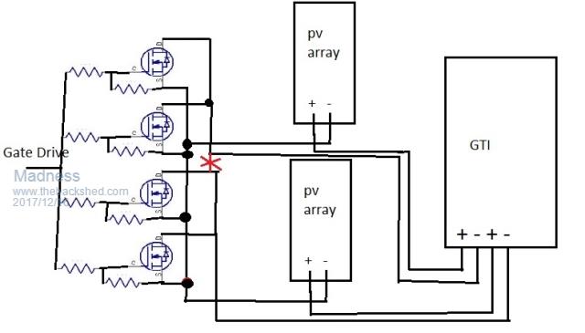

What I have had happening with this PCB is that the GTI runs happily however I get no regulation as at least one MOSFET short between drain and source when it starts regulating with PWM. I have not checked this Zeversolar GTI to see if the 2 negative inputs are in common but I suspect not. I have a couple Aurora GTI's as well and it has the facility to parallel the separate inputs both physically and with a dip switch setting.

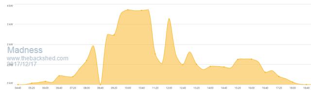

Here is the results from the GTI for yesterday, the no output at 8:40 was due to me turning it off to make some changes. The spike at 12 was from my wife turning on something while preparing lunch from then on it was just running lighter loads and maintaining float voltage.

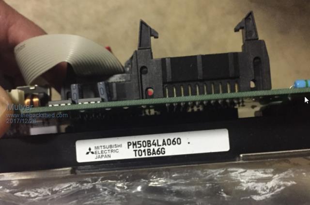

Are the IGBT's in the AeroSharp's any good for PWM of the PV panels?
Just deciding what to keep and what to junk!
https://www.mitsubishielectric-mesh.com/products/pdf/PM50B4LA060_n.pdf
Madness
Joined: 08/10/2011
Posts: 2498
Posted: 11:40am 28 Dec 2017
They could be but they are setup as a H-Bridge internally, they will be good for something, don't know what though.

  Madness said   Finally solved the MOSFETs shorting issue, I had to separate the Drains of the MOSFETs from each other as per the diagram. It has been running well with this modification, I am not sure what difference it makes but this how my original design was made and it has not failed.
Gary, looking at your sketch while trying to suss out a simple solar panel string on/off switch for my planned single input GTI I notice you just switch the negative side? That good enough?
I presume you use a similar gate drive as with your inverter to turn the mosfet on/off?
Sadly, no sketch for that .
What type mosfet did you end up using?
I know, you like the all bell & whistle system here but I prefer to start with a simple on/off method, triggered by battery voltage sensing & timed delay off to stop it going bananas on cloudy days.
thanks.

Hi Klaus,
I am using 600V 20A MOSFETs 20N60S5 and yes they only switch the negative side you only need to switch one to stop the current. It is much the same as the inverter gate drive but this switches much slower and does not need the diodes to turn off so quickly, nor is there the risk of playing Russian Roulette with the opposite side of the bridge.
There is an image of the PCB circuit here it is not complicated. https://www.thebackshed.com/forum/forum_posts.asp?TID=9734&PN=2&TPN=7 There is further details in this thread of Oztules version which is simpler, I now have temperature compensation and a number of other changes/additions.
You must have the MOSFETs completely isolated from ground and have an isolated power supply to the gate driver chip for most GTI's. I had a couple failures with the old PCB I was using where the MOSFETs arced to ground. It did not harm the MOSFETs but it did kill the GTI output IGBT's. Since I found the problem and made the modification in the diagram above it has worked absolutely flawlessly.
I do not like the idea of just turning off the GTI by cutting the PV power. It is a very hard on off situation if my GTI turned off completely I loose up to 4.5 KW of charge. Then the GTI would shut down thinking it is night, it then takes it at least 60 seconds to start making power again, some take 180 seconds. It is not a good way to regulate charge to your batteries. Oztules previously regulated his by turning off the AC connection to the GTI.
With what I am using it smoothly reduces or increases the charge as required by the batteries and whatever is drawing power at the time. If you go with the BANG-BANG method I think you will quickly want to change it to a PWM solution.Edited by Madness 2018-01-29
