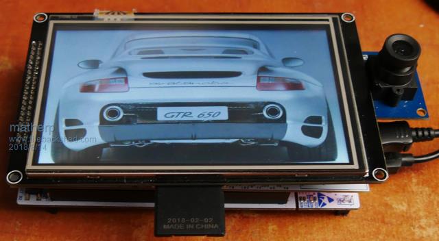

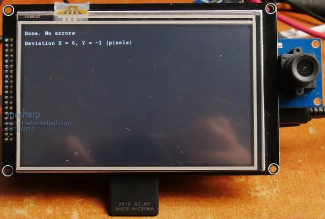

Posts: 11963
Posted: 11:47am 14 Aug 2018
Your card and display arrived safely and the news is good or bad depending on how you look at it
The display and SD card work perfectly on my Nucleo and daughter card. Suggest you look at things like power supply, common ground between supply and USB etc.
The touch implementation on the Sainsmart seems to be a problem. The issue is noise on T_IRQ which looks like a mechanical switch bouncing. What they have done I have no idea. However, I have put some software debouncing into the calibration code without impacting normal operation and this makes it just about workable
2018-08-14_214613_Armmite1.3.zip

Posts: 11963
Posted: 04:11pm 14 Aug 2018
Press each calibration point for about a second and the point should then step on.
